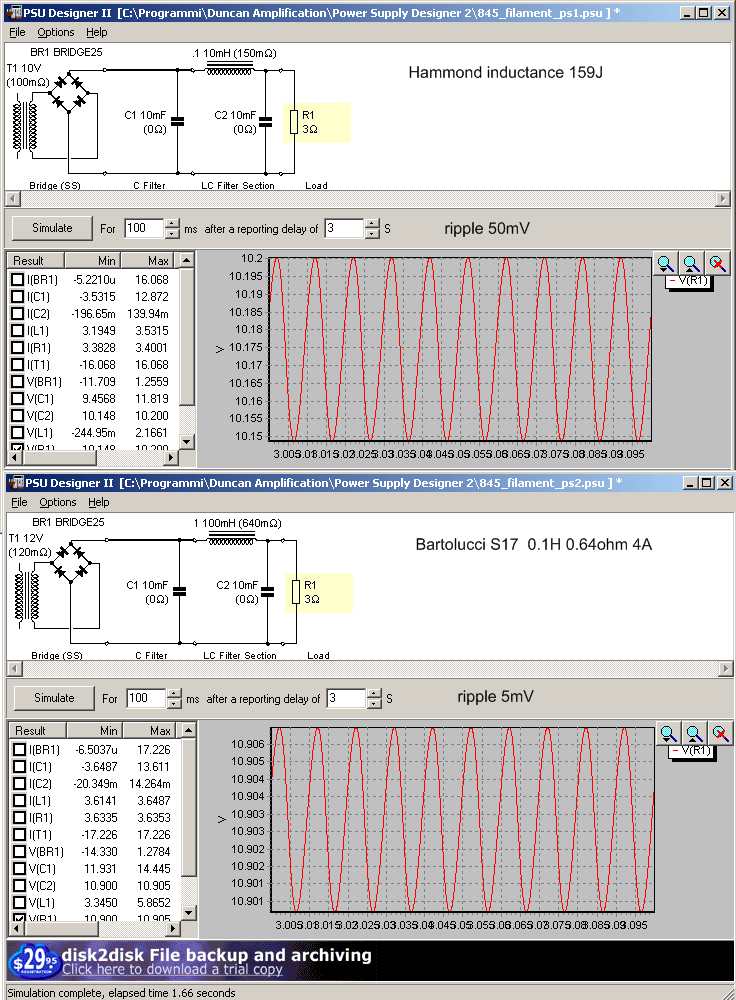

About the 845 filaments there are some solutions:
1) the cheaper is ac filaments without center trimmer
this solution is good only if the 845 have the cathode in the center of filaments and you are using medium-low efficiency loudspeakers
2) another cheaper solution is ac filaments with center trimmer
a good Spectrol 534 multi-turn 100ohm 2w could be use for this purpose but the efficiency of this system is to verify and it depend by the efficiency loudspeakers
3) dc filament with low cost passive power supply (see attach)
it give a very good noise reduction also with medium-high efficiency loudspeakers
4) dc filament with high cost passive power supply(see attach)
it give zero noise on any condition

Andrea,
you'd better go for a LC filter. Probably that big 100mH choke can be regapped for higher current (and lower H) and used as input choke.
An other option (many possibilities out there) is to use solid state regulators.
Ciao
Gianluca
Ciao
Gianluca
Thermally unattractive, but cheap IC solution is to follow a CRC supply with a heatsinked LM338 acting as a CCS. The CCS needs to drop at least 3 volts across it, more to avoid risk of falling out.

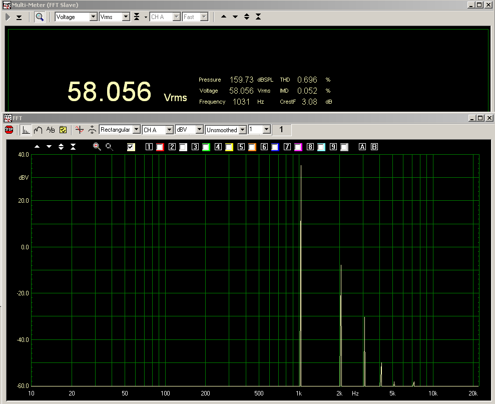

Here the first measurements on this configuration
D3A
Vp=180V
Rk=100ohm
Ck=660uF to get flat low freq. resp.
Vk=1.8V
Ik=18mA
Bartolucci INT8C L=48H Igap=25mA
no load on secondary
60Vrms with less than 1% thd
20Vrms with less than 0.2% thd
good result so I will try to drive the GM70

Here the first complete measurement of the D3A - GM70 amplifier
Very good frequency band 10Hz at -3db and 22KHz at -1db
http://www.audiodesignguide.com/Cla..._1000v_Tango_BartolucciNew_freq_8ohm_90mA.gif
and here the distortion decay (very good!)
http://www.audiodesignguide.com/Cla...0_1000v_Tango_BartolucciNew_max_8ohm_90mA.gif
