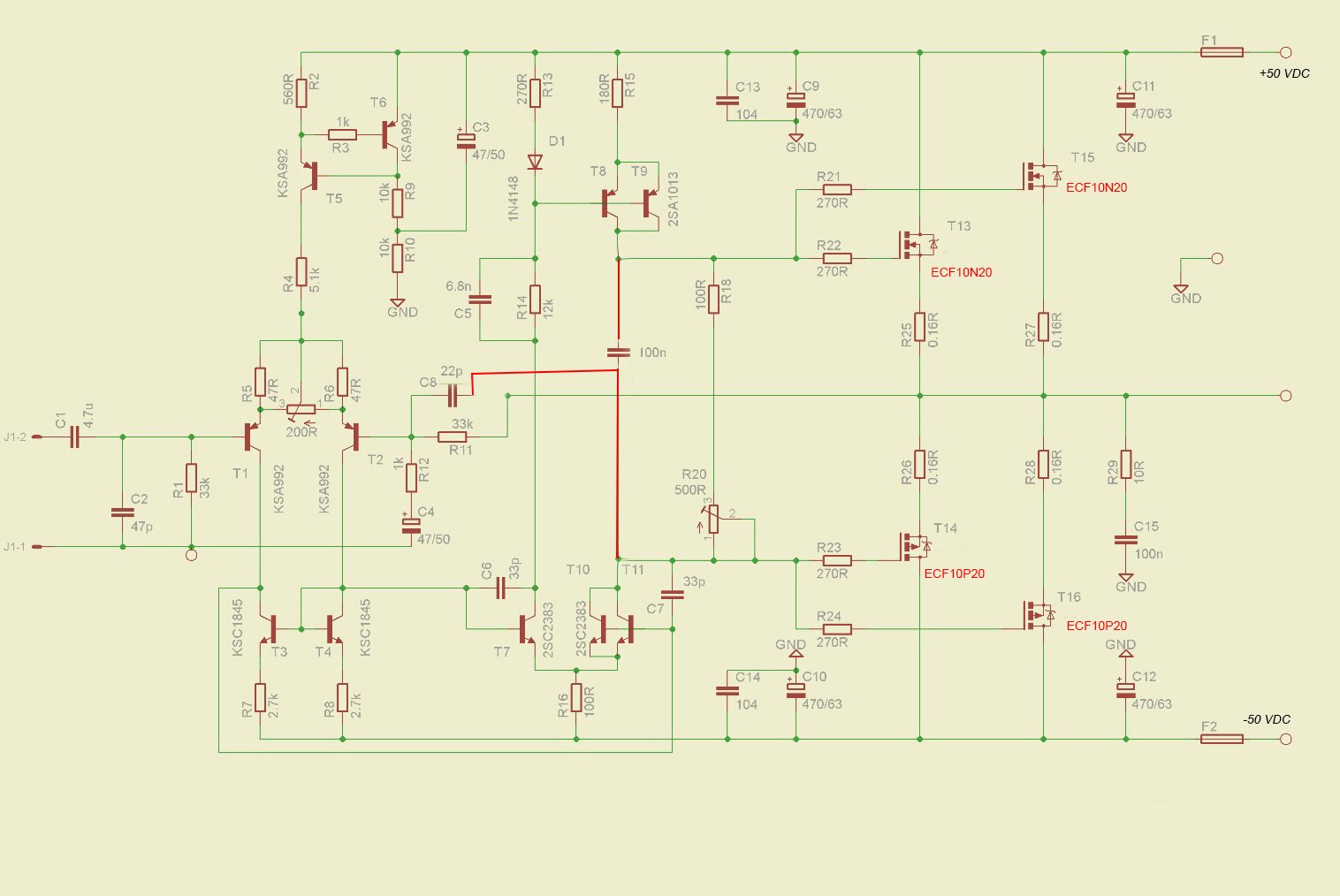

@carcotado please move R33 + D2 and R32 + D3 to the left side of the T13-16.
As it is connected now, for example, think of 1 A current through R32 or R33 drawn via output transistors by the output load, theoretically it would cause a voltage fall of 47 Volts over these resistors (U = I x R), the voltage supply to the amplifier circuit will jerk terribly up and down with the audio signal.

If we pick say 470 ohm as a grid stopper for the N-channel, then the P-Channel will be 594 ohm. The nearest standard value is then 680 ohm for the N-Channel.
I think you have made a mistake, first you said "then the P-Channel will be 594 ohm" and then "The nearest standard value is then 680 ohm for the N-Channel" same value for two channels, I think 680 and for channel N.

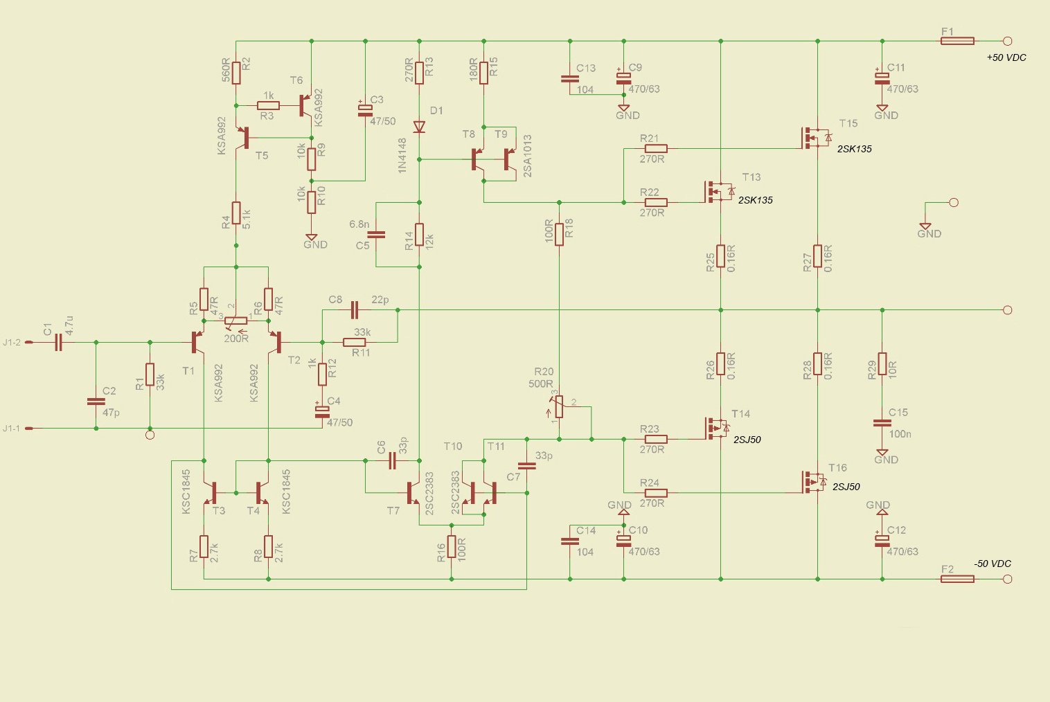

Hi, as I said in the first post, this schematic is mounted and works well, but with Hitachi Mosfet 2SJ50 and 2sk135, I was looking for these mosfet, and I did not find them, so I bought Exicon as a replacement. Since then I am looking for a solution before discarding the project and losing the money.
This is the original schematic.

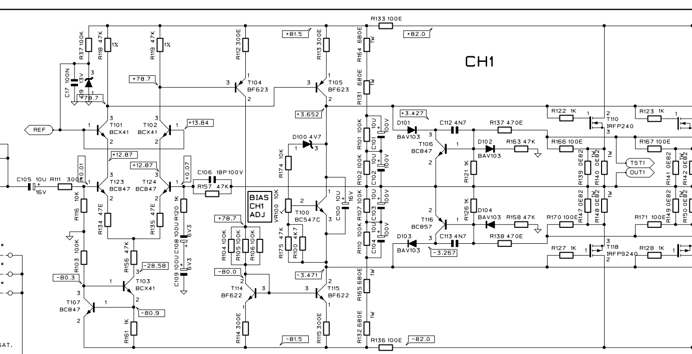

The Crown Pulse topology is verry prone to oscilation, I started audio with their design and had alot of hard time. Their design hass verry good bass, the speaker barely moves and brings the house design. The VAS stage is replicating a simetrical amplifier because of using signal from both transistors in input stage. Later Edit: Below are some pictures of a factory design with Mosfet from General Music Italy.

C8 is suspiciously high value. I don’t think the schematic is the original. Please link the original schematic. If it is the original, then I can say it is poorly designed.
Sorry, I don't have the link, this schematic was given to me by a friend who assembled this amplifier and it worked fine for him.

@carcotado can you tell what type of resistors (R25-28) are used as Source resistor for the power FET's?
If these are wire wound resistors, especially Lateral FET's can easily run into oscillation because of the relatively high inherent inductance in the these types of resistors, in that case it doesn't matter much what value the compensation capacitor has (C8), or the gate resistors are, because the oscillation will be local around the FET itself, in particular the N channel FET is prone to run into oscillation bursts at the positive peak, or just a bit after the positive peak when the signal starts to slope downwards, which can be observed using a sinus test signal.
So, if these resistors are wire wound then these must be changed to film type resistors.
There have been few suggestion to move the FET gate resistors (R21-24) as close as possible to the FET gates, which I also think is quite important, I went through the whole thread but can not see any reply from you in this matter, did you try this modification or not, and what was the result?
Also, the way the PCB gate drive traces are designed is not properly done, there should be no large areal traces at all, quite the contrary the traces should be as slim as possible, 1 millimeter wide traces is well enough for gate driving.
Rerouting compensation capacitor C8 was also mentioned, i.e. connect the side of C8 that goes to output instead to the VAS stage, the collectors of T10-11, collectors of T8-9 may also work.
It's also not very clear from your posts how many combined modification you have tried out concurrently, however, it is often necessary to try several combinations at the same time before one can see a working effect, that could mean trying following three modifications concurrently;
1. Connect gate resistors physically close to FET transistor, max couple of millimeters from FET gates.
2. Reroute C8, i.e. move one leg from output instead to VAS stage.
3. If the source resistor R25-28 are wire wound, then changed them to film type resistors.

is referred to as shown in the image?

After reading this lengthy thread, it's clear that the 8-9 MHz oscillation means it's an output stage problem. Here are my suggestions:
1. If you have that diode+47R series combination in the supply rails, bypass it to take it out of the circuit.
2. Put high frequency decoupling of each output transistor with 100nF to ground as close as possible to each drain terminal.
There is very little HF decoupling in the schematic.
3. Try increasing the gate stoppers to a high value, say 680R each and note the effect.
Does it reduce or eliminate the oscillation?
If it eliminates it, then you can gradually reduce their value to the point where it starts to oscillate, then increase again to the next stable value.
4. If it reduces oscillation but doesn't eliminate it, then I would try some non-inductive emitter resistors, such as metal element current sense resistors.
