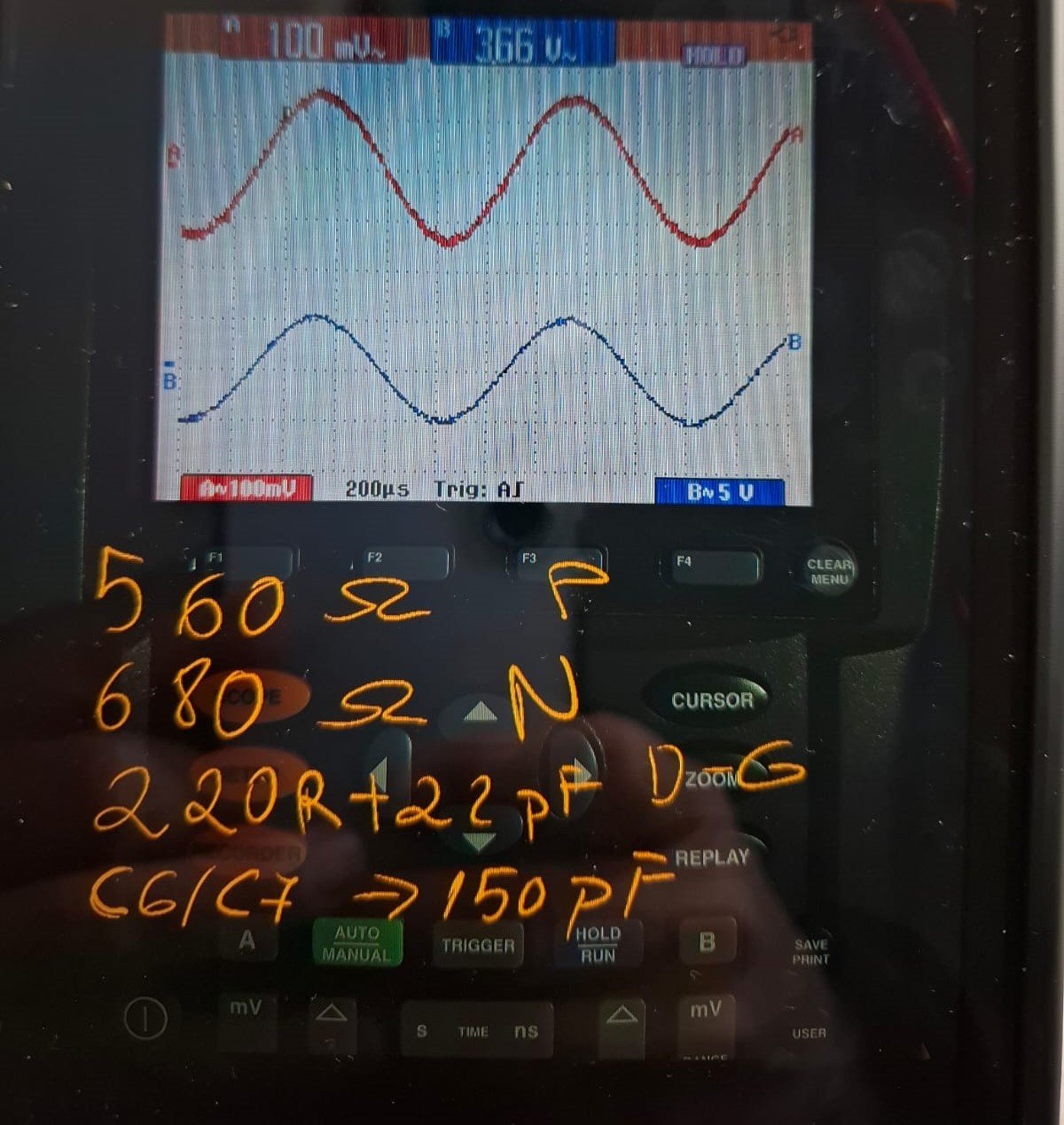

Hello friends, I continue with the tests of the different configurations. 😀.

Use 560R (P) and 680R (N) gate stoppers and a zobel across D-G of the Exicons (220R + 22pF).
This option work, I think well, I add oscilloscope image.
At the moment, this is the best option I see for this project. What do you think of these measures?

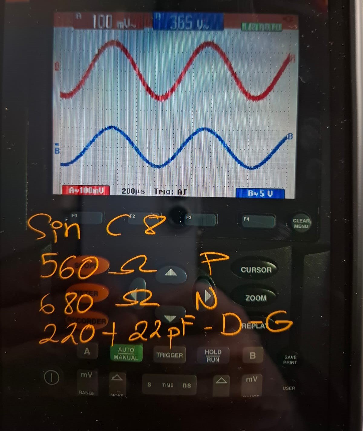

Image1: how Flikoman describes without C8
Image 2: how Flikoman describes without C8, and C6-C7 to 150pF.

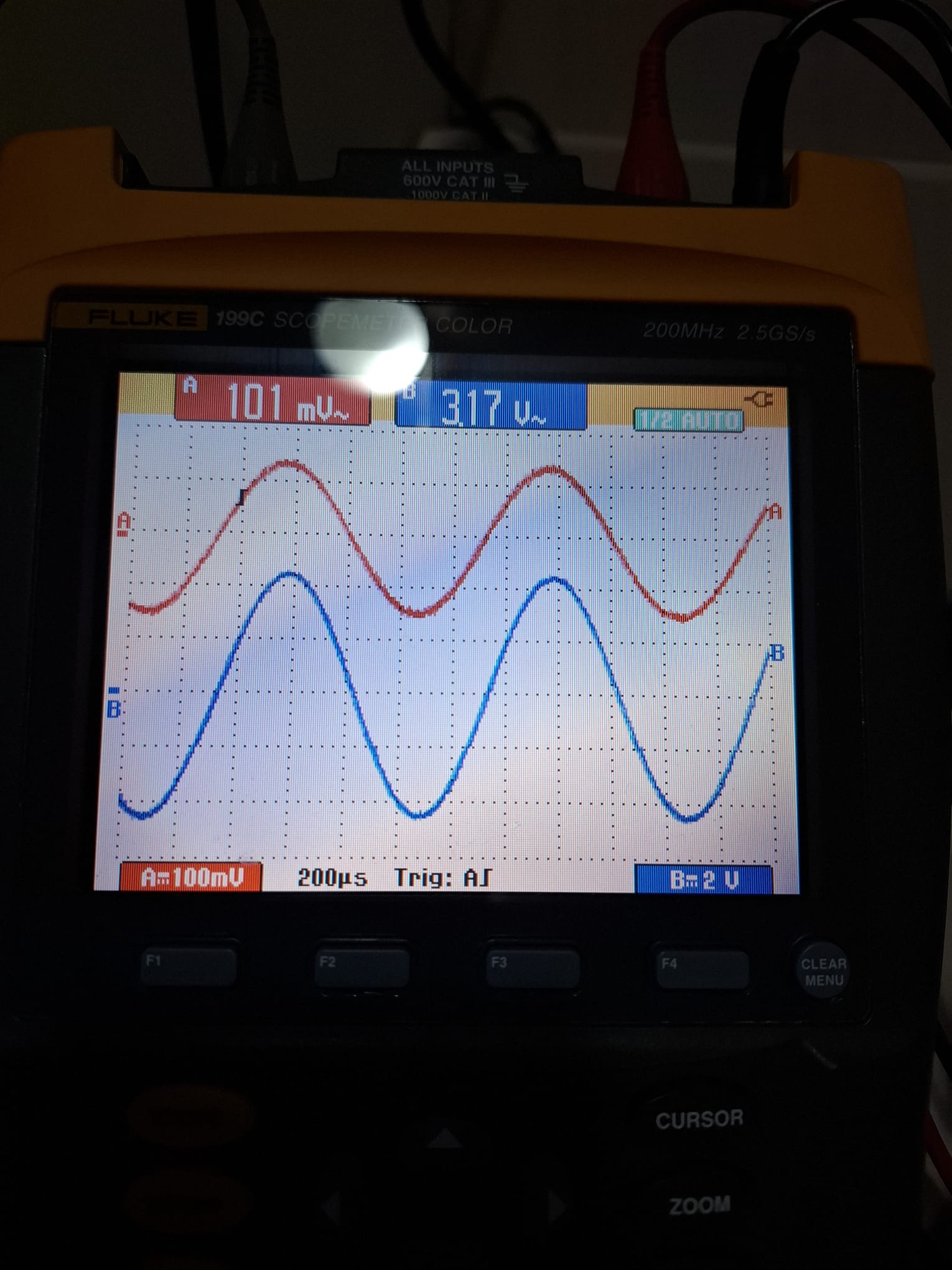

I continue with some more tests,

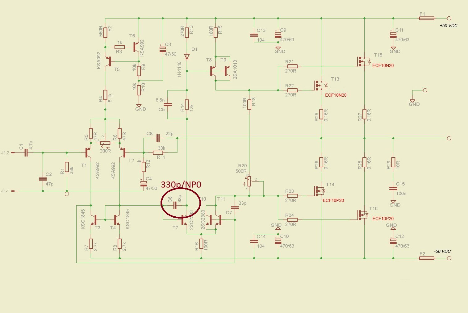

I did a quick and dirty simulation in ltspice, the gain and phase margins are quiet low, given the board layout it maybe partially unstable given the right conditions. Also with no output inductor, just connecting a loudspeaker would most likely cause the amplifier to go into oscillation.
The main contributor to this is the phase lead capacitor (C8) across the feedback resistor R11.
Unity loop gain is approximately 5MHz, gain is only -10db @ approximately 9MHz at 180 degrees phase.
The simulated gain/phase margin is approx 9db and 40degrees, probably worse with the real circuit board layout.
Removing C8 improves the gain and phase margin to approx 20db / 62 degrees, the loop gain at 20KHz (33db) is unaffected.
The simulated unity loop gain is now 760KHz.
Other changes:
R21/R22 - 470R
Leave R23/R24 at 270R
Leave C6/C7 at 33pf
As suggested move the gate resistors as close as possible to the mosfet gate pins. I would also add a output inductor to the amplifier approx 1uH -2uH.

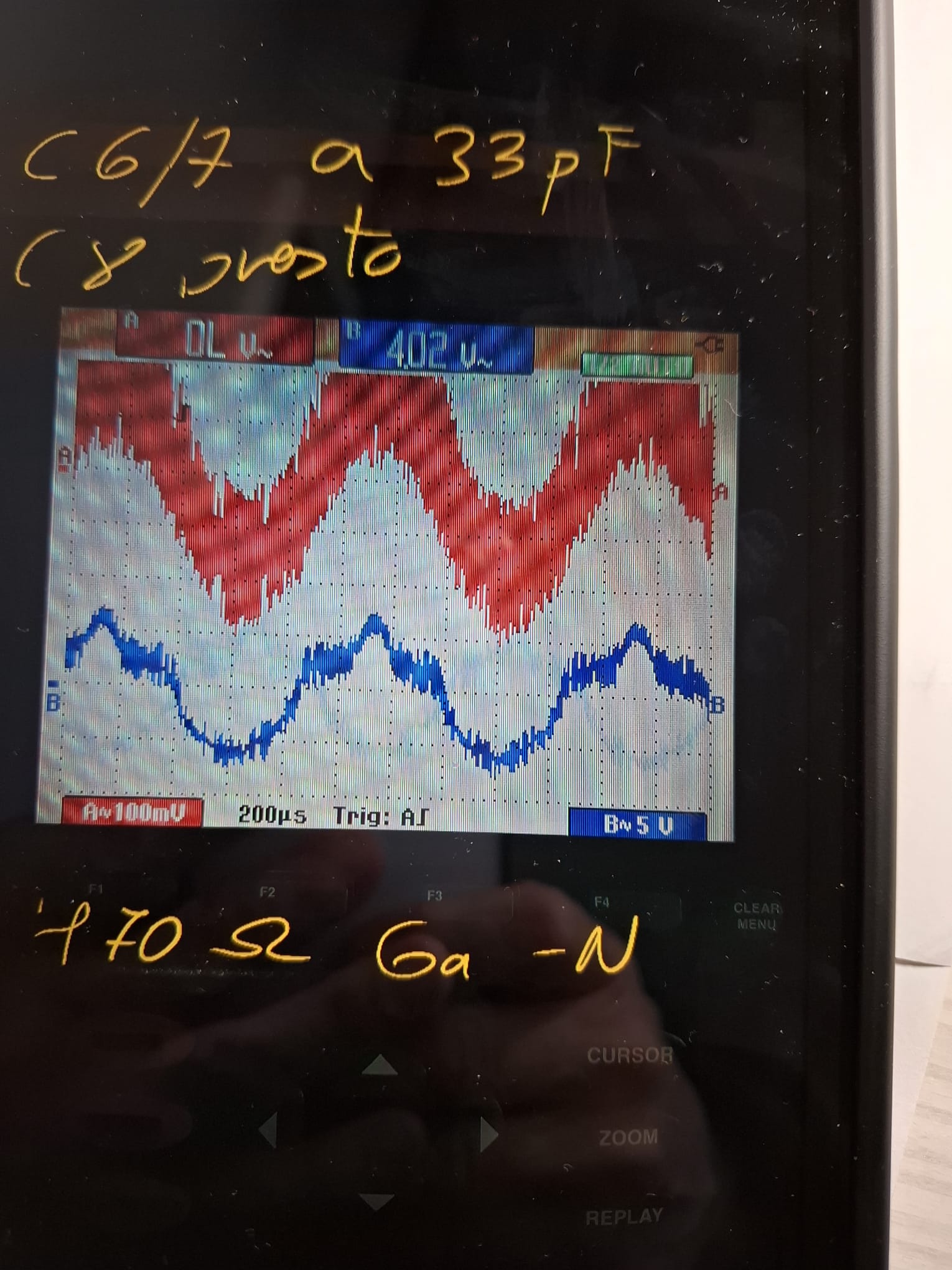

This option the test is not clear, because the measurement is with C8 on, now I don't remember if I test it without C8.
I do it egain.
This is the measurement, oscillation also affects the input waveform.

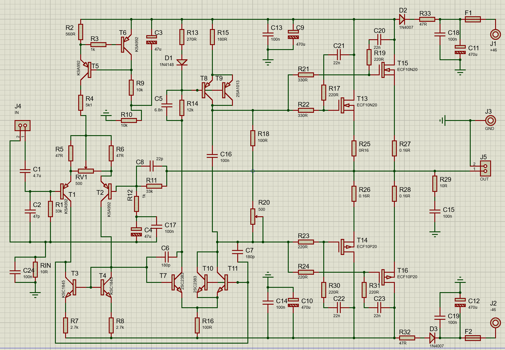

Hello again, after testing and a lot of reading, I have found a stable configuration for this design. This is the attached schematic. The option mentioned by Flikoman with the Zobel network between D-G, is the best option, but after reading the design recommendations with the Exicom Mosfet, they recommend gate resistors between 150-470 Ohm, the normal is 220 P channel and 330 N channel.
I have mounted the latter because according to the ‘Aplication Notes’ above 470 can affect the slew rate. With 220 and 330 Ohm in the gate resistors of the Exicon Mosfet, as measured by the oscilloscope, correct. But in audio tests it produces a sputtering in the mid-high frequency range. I changed them to 330 on P and 440 on N, everything sounds ok.
Looking again at the average Bias in the Source resistors, for the same channel (P, N), there is a variation from one resistor to another in the order of 0.6-0.7 volts. I put all the gate resistors of the same value, 330 Ohm, the Bias voltage remains similar from one resistor to another, only 0.1-0.2 volts variation.
What do you think about this? What resistors would you mount?

Connect it to a speaker and feed a sine wave. Sweep the frequency across the frequency range and see if you can reproduce the “sputtering”. Once we know when it happens and what it looks like, it’ll be easier to figure out what’s going on.
I would also simulate it to see if you have any resonances in the CLG and OLG gain plots.

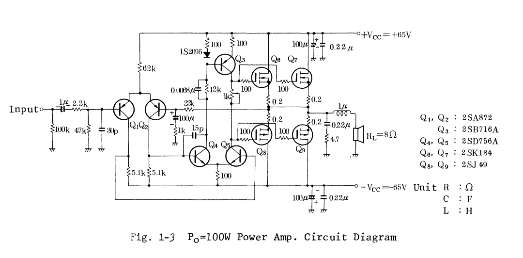

220 ohm stopper resistors should fix oscillation issues with the Excicon MOSFETs. I don't particularly like the Hitachi schematic from the app note, as I don't believe there's enough current in the second differential stage to effectively charge the output MOSFET gates. Here's the thread for the modified Hitachi amp circuit:

This one looks like yours, is simpler and works no prob with Hitachis and Exicons. If you pair Q1 and Q2 well, offset will be low.
The source connection of the MOSFET needs protection from capacitive loads. The small inductance of a wire-wound resistor as shown can provide this, a 0R22 value will do more than 0R1 in that regard. The gate stopper resistors will do better if there is a low pass filter capacitor between the gate and the source. The gate stopper resistors could be increased in value up to 330R and the capacitor value introduced between gate and source, decided by trial and error. This circuit looks tidier for stability as there is only one capacitor around Q4 however the value might need to be changed. This could be connected from the collector of Q4 to the base of Q2 as has been indicated in another input suggestion. I would not recommend a lead capacitor in parallel with the feedback resistor as any hf instability due to the load will be introduced to the system
