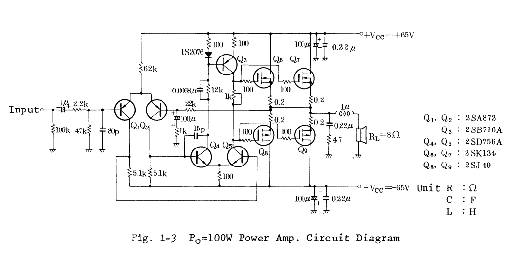

BTW, your question reminded me of a very gentlemanly discussion quite some years ago between Nelson Pass and Charles Hansen (RIP) that touched on some differences between VMOS and Lateral MOSFETs. It would be useful reading for such a venture. If I find a link, I'll share it. I suspect someone else will beat me to it. And, although we've lost A LOT of the incredible expertise that visited this site over years past, there is still a lot of really good stuff around that if sorted through and studied can be helpful for budding designers as well as experts - it can save one lots time, save some PCB revs and avoid some burned up parts ! 😉

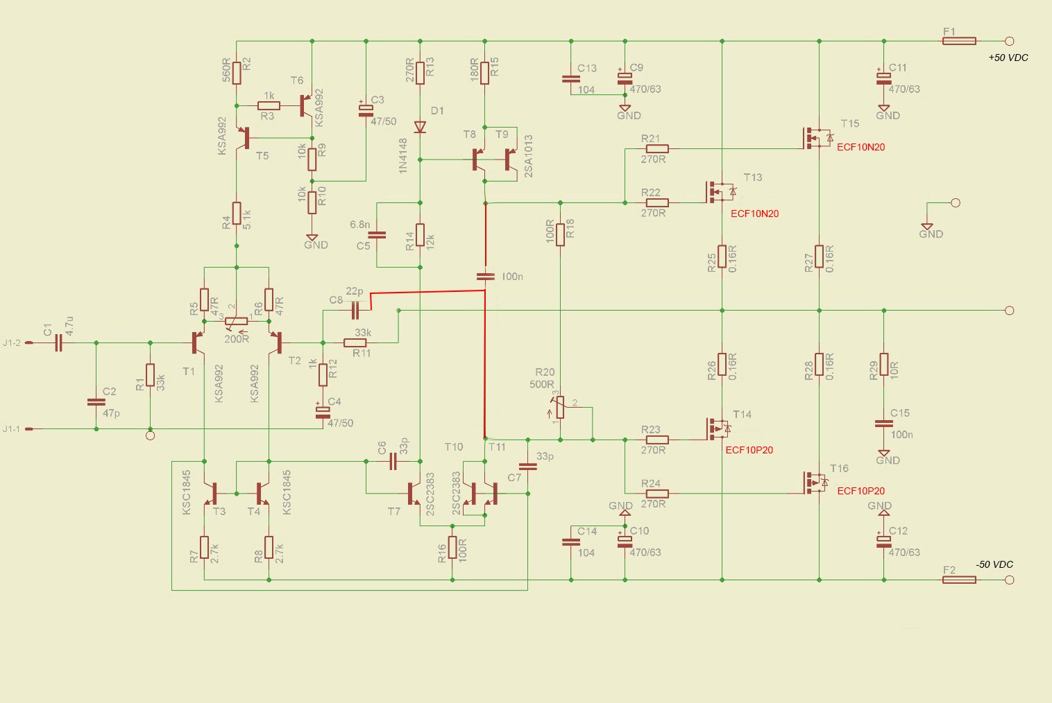

47 ohms both on positive and negativ rail.
I just checked the amp in TINA with somewhat other transistors and it worked well but only without C5.
I changed R13 and R15 to 47 ohms and R16 to 33 ohm.
It doesnt have so much open loop gain so the distortion value will not be so good but it sounds better than expected due to mosfets instead of bipolar output transistors. I used 2 of them a few years as PA amplifier for a rock band.
I think mine were about 0,05% distortion at full power.
Reactions: carcotado

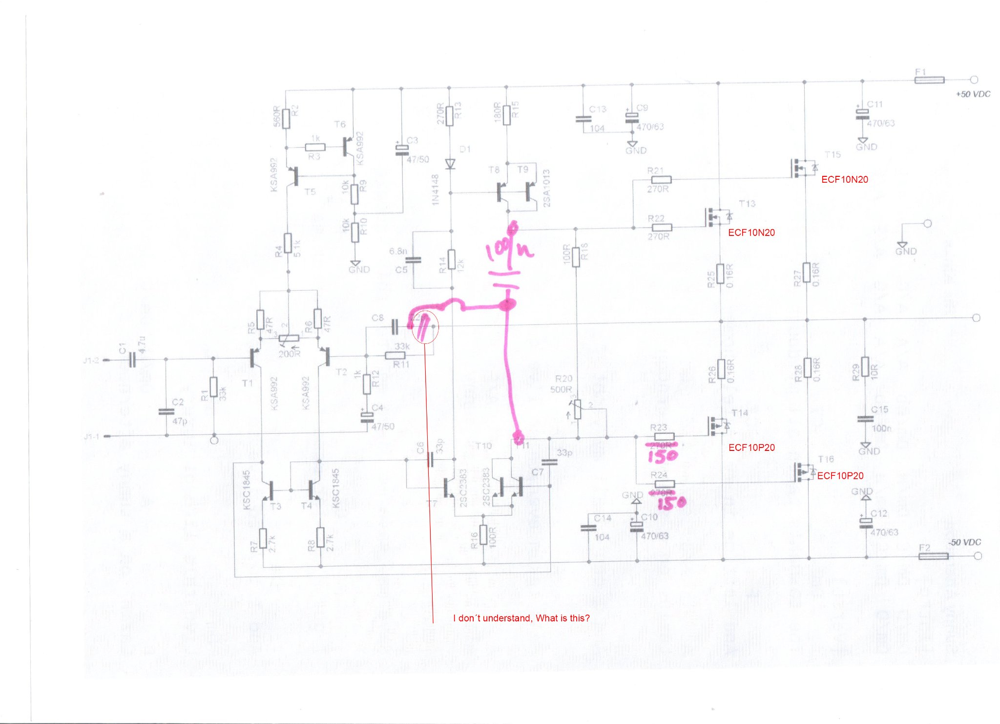

Hello friends, I continue with the tests of the different configurations. 😀.
You may try these mods
This option doesn´t work.
That's roughly what I've got.... cheers Frank
Use 560R (P) and 680R (N) gate stoppers and a zobel across D-G of the Exicons (220R + 22pF).
This option work, I think well, I add oscilloscope image.
At the moment, this is the best option I see for this project. What do you think of these measures?
Image1: how Flikoman describes without C8
Image 2: how Flikoman describes without C8, and C6-C7 to 150pF.

I did a quick and dirty simulation in ltspice, the gain and phase margins are quiet low, given the board layout it maybe partially unstable given the right conditions. Also with no output inductor, just connecting a loudspeaker would most likely cause the amplifier to go into oscillation.
The main contributor to this is the phase lead capacitor (C8) across the feedback resistor R11.
Unity loop gain is approximately 5MHz, gain is only -10db @ approximately 9MHz at 180 degrees phase.
The simulated gain/phase margin is approx 9db and 40degrees, probably worse with the real circuit board layout.
Removing C8 improves the gain and phase margin to approx 20db / 62 degrees, the loop gain at 20KHz (33db) is unaffected.
The simulated unity loop gain is now 760KHz.
Other changes:
R21/R22 - 470R
Leave R23/R24 at 270R
Leave C6/C7 at 33pf
As suggested move the gate resistors as close as possible to the mosfet gate pins. I would also add a output inductor to the amplifier approx 1uH -2uH.
This option the test is not clear, because the measurement is with C8 on, now I don't remember if I test it without C8.
I do it egain.
This is the measurement, oscillation also affects the input waveform.
