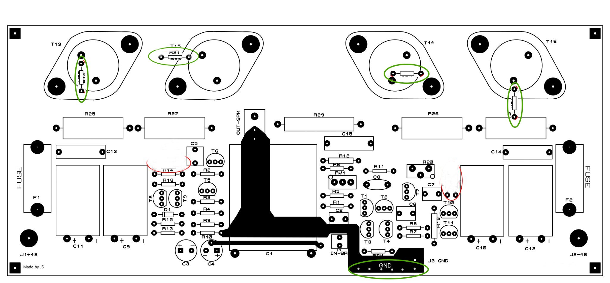

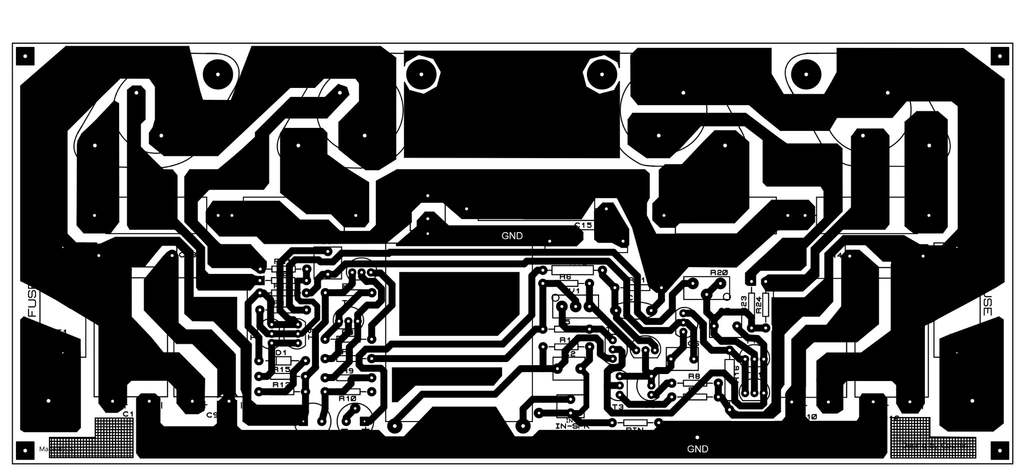

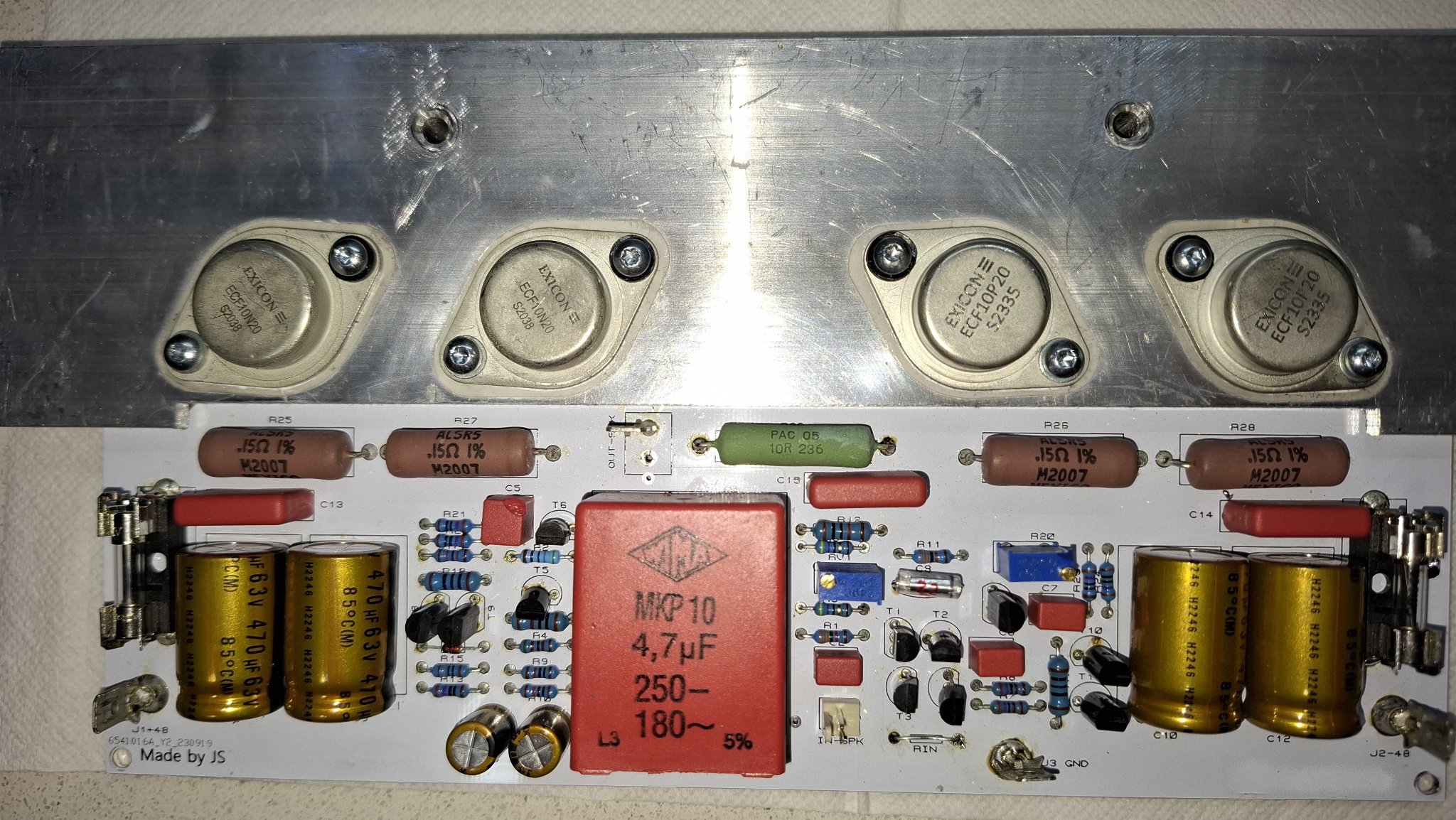

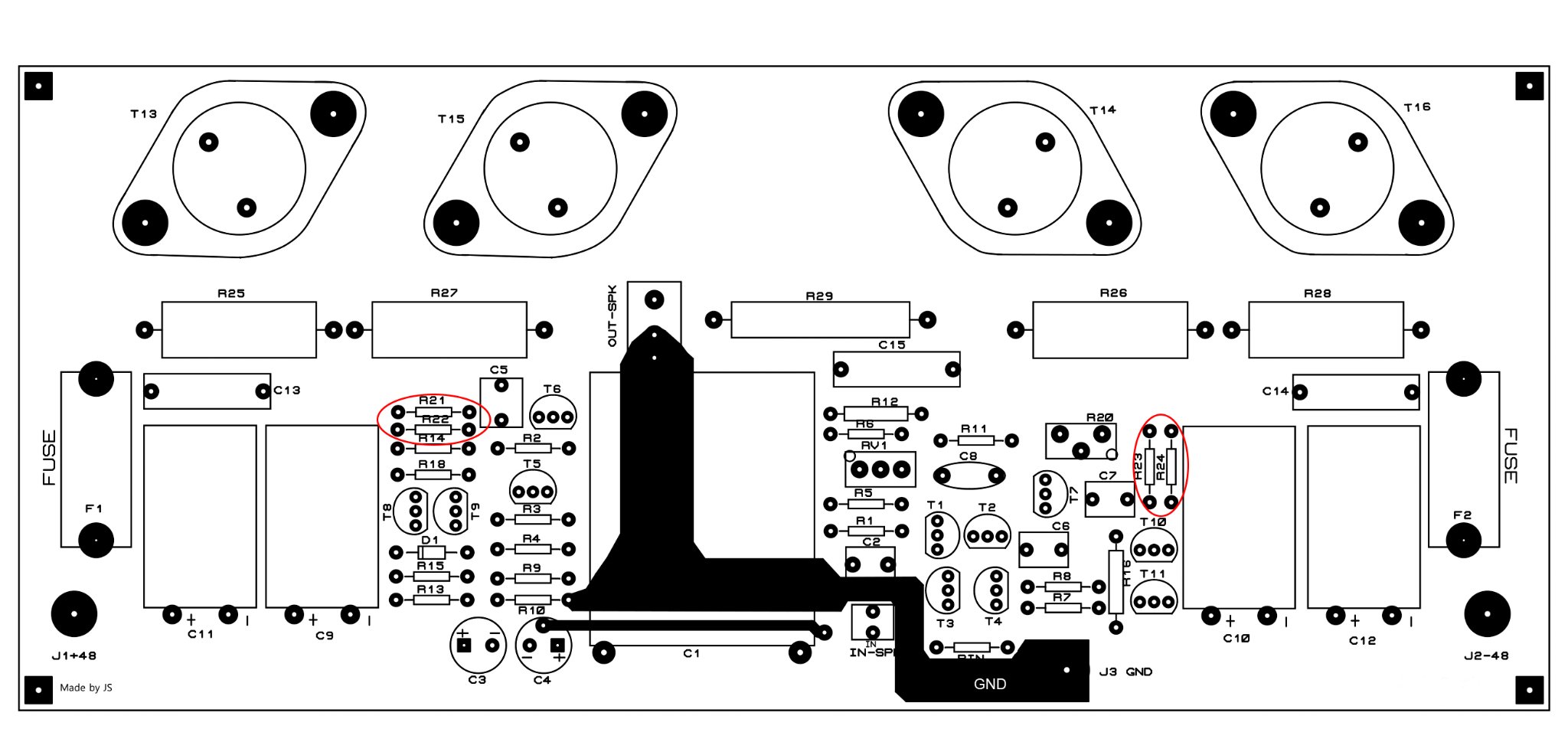

You haven't told us anything about your circuit layout. In particular those gate stopper resistors need to be very close to the mosfet gates or the outputs will oscillate all by themselves
Here is layout.
Whith red circled in red, are gate resistors.

I did a quick and dirty simulation in ltspice, the gain and phase margins are quiet low, given the board layout it maybe partially unstable given the right conditions. Also with no output inductor, just connecting a loudspeaker would most likely cause the amplifier to go into oscillation.
The main contributor to this is the phase lead capacitor (C8) across the feedback resistor R11.
Unity loop gain is approximately 5MHz, gain is only -10db @ approximately 9MHz at 180 degrees phase.
The simulated gain/phase margin is approx 9db and 40degrees, probably worse with the real circuit board layout.
Removing C8 improves the gain and phase margin to approx 20db / 62 degrees, the loop gain at 20KHz (33db) is unaffected.
The simulated unity loop gain is now 760KHz.
Other changes:
R21/R22 - 470R
Leave R23/R24 at 270R
Leave C6/C7 at 33pf
As suggested move the gate resistors as close as possible to the mosfet gate pins. I would also add a output inductor to the amplifier approx 1uH -2uH.

There are a few things worth to discuss in the schematic.
1. The T3 and T4 does not add to the function of the circuit. The input admittance of T7 and T10 + T11 is a little over 400 ohms. ( 21mv x HFE / Ic) So the 2,7k of the R7 and R9 dont take that much of the signal. Just take away T3 and T4 and add a jumper E - C. Change R16 to make 20 mA through it.
2. The T8+9 and T10+ T11 might have very different currents. Normally the base voltage of the same type transistors can differ 60mv ( sometimes even more).
That means 10 times higher current in one of them. Here you have pretty strong transistors so it would be better to only use one. To manage the heat you need a cooler. There are clip on coolers but you can also use an inch of venetian blind lamell. If you cant find that you can use the smallest coin you can find. Just glue it with epoxi (fairly good heat conductor) to the flat side of the transistor. R13 and R15 should have the same value = 2x R16.
3. The C5 and C6 can lead over high frequency signal from the positive power supply rail to the base of T7 and via emitter and T10+11 to cause self oscillation.
To get rid of this take away C5 and disconnect the C13 and C9 from positive power supply rail for high frequencys. 47 ohms between C9 and C11 will do the job. It is the same problem between C10 and C 12 so 47 ohms there will also be good. There is a possibility you can use the C5 if you move over C6 to T8+9 B-C
4. I would add a 10v zenerdiode G-S on T13 and on T14 for gate to source voltage protection.
From the other suggested improvements I would only keep The 100nF between T8+9 C and T10+11 C.
I am not sure if the values of C6 + C7 or C8 are ideal. When I build this in 1974 I used 47 pF for the Miller integrators and 47k with 4,7 pF for feedback.
Without the 47ohms in the supply rails you will not get a proper simulation in Spice. And even worse with C5 as in the original schematic. It is the high frequency impedance in the leads that mess it up.
R21 to R24 will probably work better with 100 ohms.

You appear to only have those electrolytics in the supply rails and they are far from the output devices. You have to think about where those high Class B currents are flowing and also about self resonant frequency of the decoupling

Put gate stopper resistors on the solder side of the pcb.
Cut resistor leads down to 5mm on one side and solder directly to the gate leads, cut the gate traces under the resistor bodies and solder the other ends on the pcb traces. Install jumper wires in former resistor positions.
