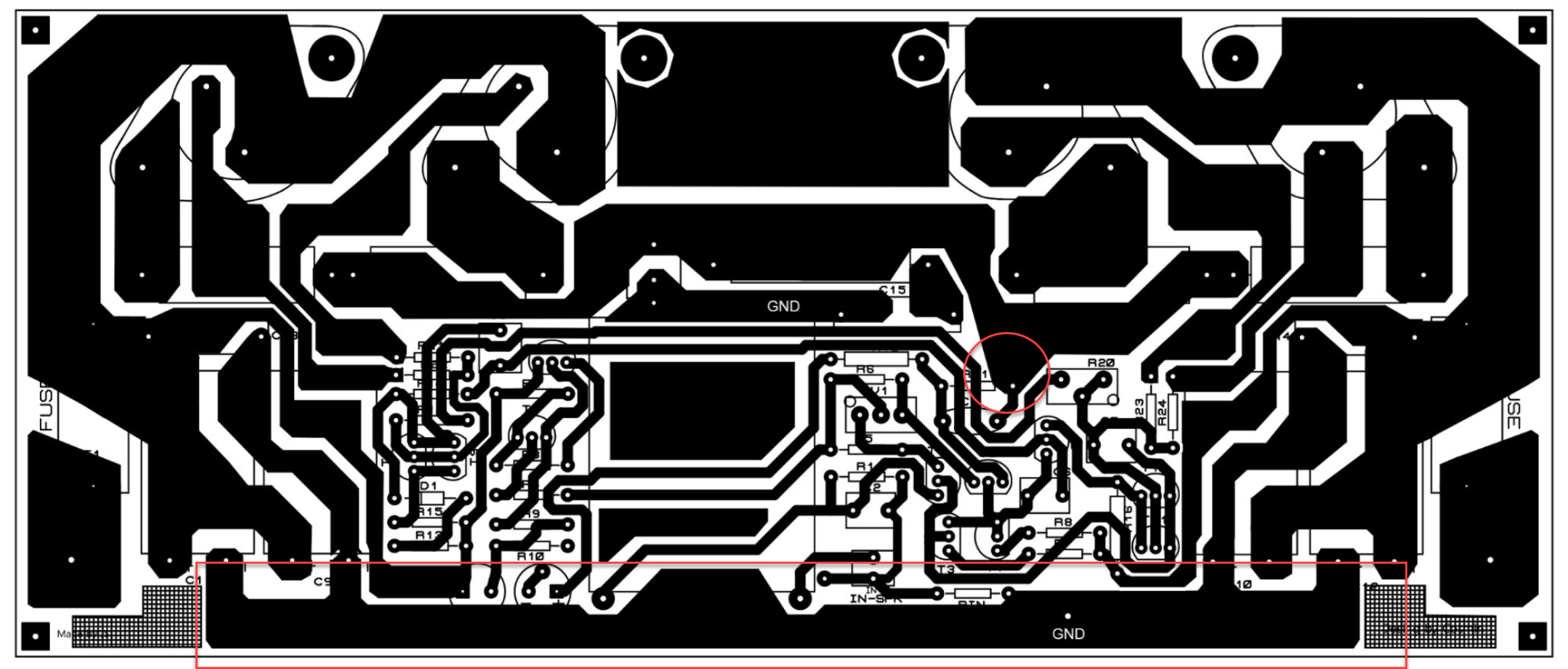

I took a look at the layout from post #29. Two quick observations:
1) The NFB takeoff point is probably fighting with the output currents. I would suggest routing it off of a T junction near the output connector. There are quite a few threads on this forum describing how this should ideally look. I tried to draw in an example of how it might look. Currents are low so the trace can be thin.
2) The grounding layout may be injecting charging pulses from C11/12 into the input. Ideally, the grounds for the two main caps (C11 & C12) should join together first, then this union should flow into the remaining ground points. The way you have it, the input is in the path of the returns for C11 & C12.

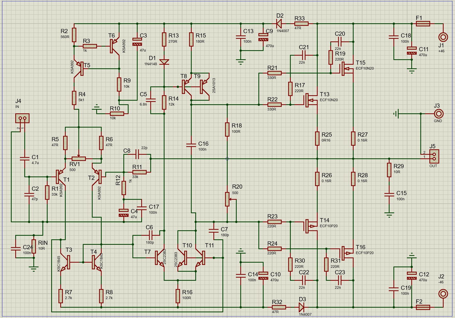

Please ask your friend where he got the circuit from and if there are any measurements of the original circuit by the designer. The circuit is so badly designed that it is likely some faults have cancelled out other faults.Hi, as I said in the first post, this schematic is mounted and works well, but with Hitachi Mosfet 2SJ50 and 2sk135, ... This is the original schematic.

I am going to make a summary because I don't think I have explained myself well.

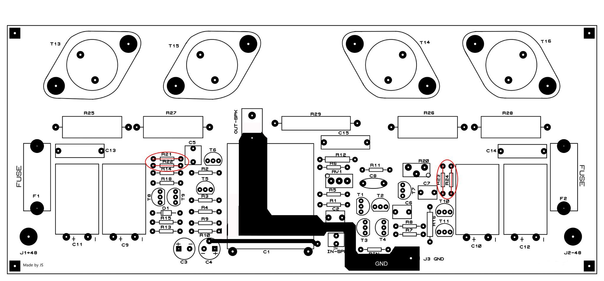

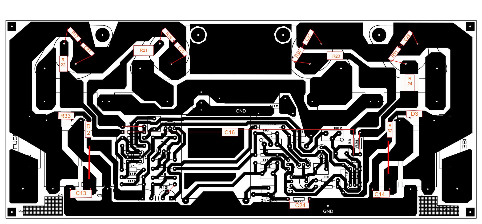

The first problems are the ones described in post 1 and following. After your advice, readings and tests, I arrive to the scheme of post #49, in which I find the problem of sputtering, which was solved by increasing as you told me the gate resistors to 470 and 680 Ohm. and this is the board as I have arranged the components. Capa Top y Botton. (In red the modifications in the track layer, with some bridge and wired track).

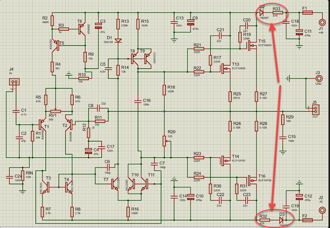

Do you really have 47R resistors placed before the output devices? These will drop an enormous amount of voltage as soon and you push any power through it. They will probably fry unless they have a very high power rating.
Typically, if these are used, they are placed after the output devices where the current levels result in less voltage drop. They form a low-pass RC filter with C9/C10 to improve PSRR.
