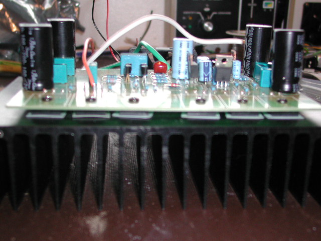

i need heat sinks.. for my aleph 2 soon
i have my set up for my aleph 5's already
here is a cheesy way for me to build my chassis and waste no money it is done with card board but youll get the idea
1st the air comes in from teh bottem and travels towards the back and then straight up over the fins.
2nd the amp is inside over top of the wind tunnel i think my desin will be perfect.. i was up till 2 amp builing this cardboard beast and well it payed off.. here it is ..
