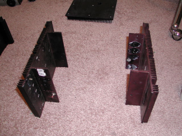

Take just about any standard flatback heatsink. Now imagine taking 3 of them and laying them next to each other like this:
E
E
E
If I take a piece of 1/4" aluminum flat plate and cut it to the correct dimension and then bolt the heatsinks to it (using grease), does this raise or lower the thermal efficiency? I'm wondering if I can buy smaller extrusion and ultimately achieve the same thermal efficiency as using a larger one...
This is what I'm envisioning (the vertical lines would actually be one continuous piece of metal):
|E
|E
|E
I ask this question because I've seen many TO3 style amps that have been designed using a "carrier" to mount the TO3's which is then bolted to the heatsinks... It seems to me that this would significantly raise the junction temps but it doesn't seem to be a problem... The carriers often look like this (only the heatsink is actually one large extrusion):
.E
[E
.E
How would one go about calculating the thermal sinking of the combination of the two pieces of metal? Just add their dissipations together and subtract the joint loss? Or, is it not so simple?
Any help would be appreciated!
Thanks,

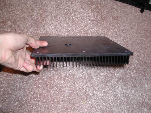

I once tried to make a large heat sink out of many small ones. It was for Zen amp. But since there were only 2 transistors attached to the sink the heat distribution wasn't even and some spots were much warmer than the others even after many hours of operation (I used thermal grase).
I liked the looks anyway.
I plan to build Aleph 5 on that and with 6 transistors per side it should work really fine. I usually don't do calculations as well. It either runs hot or not at all.😉

If you want to use multiple heatsinks, you are best to mount the transistors on each individual heatsink and then use strap or angle pieces to mechanically join each heat sink around the edges. Just keep the number of devices per heatsink equal.

Yes, mostly bigger is better. But how much bigger do you need to be better? So, even if you don't wont any stinkin calculation, you need at least some intelligent reasonning to get to the ballpark, right?
Treat heatsinks as resistors for heat current, and dissipation as heat voltage.
Example: Your output stage dissipates 100 watts, and you want to limit the max temp to 90 degrees at 40 degrees ambient, this is a temp rise of 50 degrees, right? You need a heatsing that has at most 0.5 degrees per watt "resistance". Using a larger heatsink of say 0.25 degrees per watt resistance, multiply by the dissipation gives 0.25 times 100 is 25 degrees temp rise above ambient.
If you use a bracket between the output transistors and the heatsing, that add "heat resistance" in series to the heatsink.
There is also the "heat resistance" of transistor junction to case, say 0.15 degrees per watt (don't know how realistic this is, look at the data sheet).
Example: use the 0.25 degrees per watt heatsink with a bracket that adds say 0.1 degrees per watt, and a transistor with a 0.15 degrees per watt juntion to case heat resistance, total 0.5 plus 0.1 plus 0.15 = 0.5 degrees per watt. With your 100 watt dissipation that gives 100 times 0.5 equals 50 degrees temp rise. With 40 degrees ambient that gives a max temp of the output transistor junction of 90 degrees.
Easy. It's surprising how far you can yet in amplifier design with just some secondary school math....
Cheers, Jan Didden

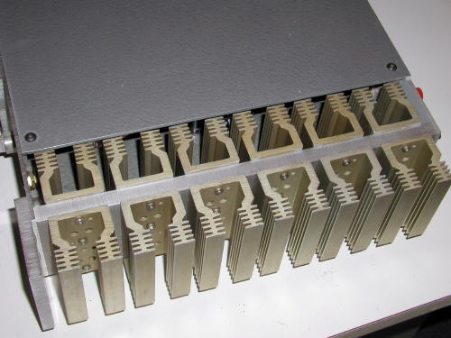

love fans too! I can get away with 4x0.65°K/W for an Aleph5 (250 watts dissipation) and a bit over 50°C heatsink temp.
Apogee,
it´s not so difficult to calculate for paralleled heatsinks. If you use 4 x 0.65°K/W you get 0.16..°K/W. You must just add the thermal resistance for the connection from aluminium to heatsink wich is quite low (measured almost <1°C difference between them)
