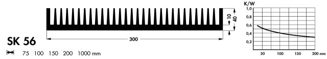

chronic problem - aleph heatsinks
Well, I have assembled a pair of mono Aleph 5 (with amazing Brian´s pcb).
As I read above, I will need to dissipate about 300W total: for heatsink to be temp. 55C at 25C ambient ...
30/300=0.1K/W. For 4 pcs heatsinks must have a rating lower than 0.4K/W (?)
So, when I consider apply 4 heatsinks Fischer SK56 (lenght 200mm=0.3K/W each one), is it already enough or not?
Thanks.
Please read the catalog from Fischer (or any other heatsink supplier) with care. There are many assumptions and correction factors to apply. One important one is the temperature difference between heatsink and ambient that is used for the curve. In case of Fischer, it is, if I am not wrong, > 50degC above ambient. After the correction factor for a 30 degC rise, you will end up having to go to a larger heatsink.
All the information are available in the technical section of the catalog.
Patrick
