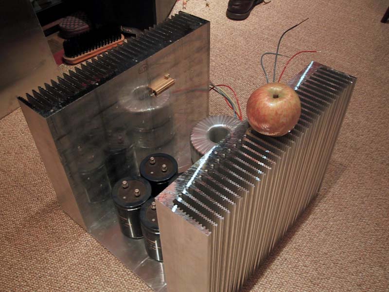

Heatsink fashion #2
Here it is, a stand up version of that autocad drawing.
The caps and the toroids are in place and i bolted one resistor and an apple for scale purposes( for those in the other side of the pond that can´t live with the metric system ;-)
Actually I'll put a light bulb in series with the primary of the transformer to work as a soft start circuit.
I couldn't find any lamps to work with a "son of zenlightment" configuration (down here we have 220V... so it would take about 8 lamps... :-(

the heatsink came from www.allutronic.com and costed €550 both including transport. (they came a month after the order)
The caps I bougth them from www.farnell.com (phone or fax order only, at least for my country)
they are 150000uF 50V and costed €124 4 units. (they ship in the next day!!!)
call pedropo@netcabo.pt or icq 28513660 for more details or autocad drawings of the case and component layout.

I'm in Lisbon, Portugal.
For the caps u can use farnell because their shipping rates are low ( for me they take €7 every order nomatter what)
Fot the sinks.... well the transport costed me €100 because of the shipping weigth.. ask the transport price before you order something from europe.

The resistor is maybe a bit on the hi-tech side, but the apple is a good choice. Or maybe a rock. 😉

Just curious: are the heatsinks really Euro 550 for two?
Seems excessive. Or maybe I'm out of touch?

550 Euro includes 100 Euro shipping cost so the sinks cost 225 Euro each which for sinks of that size is not totally crazy.

yes they did cost that (?450+?100 for shipping!!!) (that is +-1/3 more that normal extrusion heatsinks in this factory
at least.
this is a special heatsink with rugged fins and some kind of hightech extrusion againt other heatsinks... see www.alutronic.com if you want
at least.

If you live in or near the GTA, Active Surplus usually has an excellent selection of large heat sinks. The 2 used in the pictures above were $10 CAD each, I sandblasted them, machined a frame and fashioned faceplates al with $50 CAD worth of material. The P/S is in a seperate enclosure.
