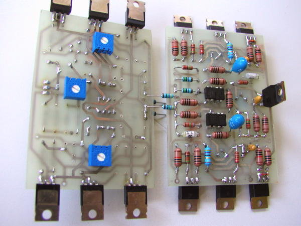

Missing a few FET's aren't they? Are you sure you do not mean Aelph Boards at 6 FET's each Channel?
11 mosfets per channel. They are all there. You might say missing trimpots, but they are on the other side.

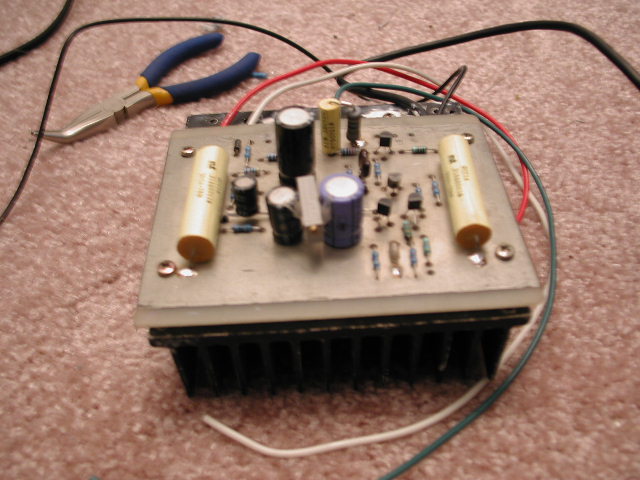

Some of the stuff you can see here http://www.diyaudio.com/forums/showthread.php?s=&threadid=3233&perpage=15&highlight=A75&pagenumber=1
Peter Daniel said:And this is how I mounted FETs on my A75 boards. The trick is to run the traces in a top layer, so there is no problem to solder mosfets.
Coulomb you wouldn't be interested in those boards?😉 Double sided, custom designed, assembled and tested. Same resistors as seen in Mark Levinson equipment.😉
What kinda caps are those blue ones ? and what resistors ? curious.

Peter Daniel said:The caps are tantalum, which I wouldn't use now. The resistors are Dale I'm buying locally.
What do you use when you need small value caps (100pf for example) ? I ordered some Kemets from Mouser, they are rectangular type.

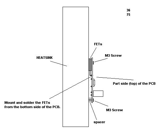

Other thing Jason, you may as well consider of using this idea on haw to mount your FETs. As most of the heat will dissipate vertically, I mean up, so that board is protected and that’s what I will do with my boards. Take a look at the picture.
One more thing you may consider as a solution. Drill a bigger holes where actual screw head is placed on board so when you tight the FETs the screws are not going to tight the PCB to the FETs only FETs to heatsink and I think that is not bad idea as well.

I know that those boards are so nice that you are very reluctant to do it,😉 but I would just trim them so the mosfets are visible and not covered by the board.

As for mounting the fets, I don't like the idea of mounting the PCB against the FET. In the previous example I wonder how much force is applied against the PCB where the head of the screw attached to the PCB -> the FET -> Heatsink? In my SoZ amp, the mosfet get VERY hot just by touching the outside case.
Point to point if possible - also when the fet leads are not attached to the PCB - it makes replacing a burnt out fet very fast and easy.

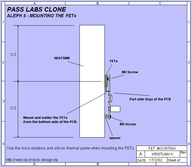

Joined 2002
Hello JasonL,

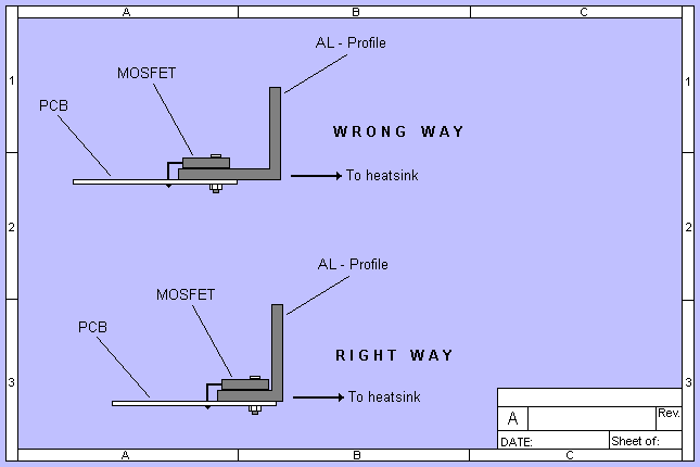

There could be two ways of mounting the FETs, like wroted in the Important file that I sent you;
'' Do not use Aluminium L profile for mounting output FET devices.
Mount them on the bottom of the PCB, so that then all together, with the PCB, can be mounted directly on the heatsinks - the output devices should be between the heatsinks and the PCB, like sandwich.
If this is done, be shure that the heatsinks are properly rated for this operation.
Also, for even more efficient cooling, the output devices could be spread over the heatsinks and then connected with the wires to the PCB. The wires should be short as possible ''.
It seems that some peoples who not builted amps that way are little concerned that, if the FETs would be mounted under the PCB, the PCB would run hot.
It is logical that it will, but it will not be same like the FETs.
The most of the heat will be dissipated through metal side of the FETs to the heatsink.
The PCB will be hot over the FETs, but the rest of the PCB will be cooler as you move away from the FETs.
The fiberglass (the PCB is made of it) is not that very good temperature conductive, far less than aluminium.
I used this way in all my amps, and I don't see this as a problem.
It is much better way, than if you would mount the fets with the use of aluminium L-profile - much more hot and PCB and the FETs.
Also, if you are still concerned about this way, you can always leave some small distance between the FETs and the PCB.
Than just increase the size for M3 screw hole on the PCB, so they heads can go through the PCB - directly to the FETs.
This way you will not fasten the PCB to the FETs by screws, it will fly on the FETs leads / legs. (I enclosed the diagram, and I think
that you will understand it)
