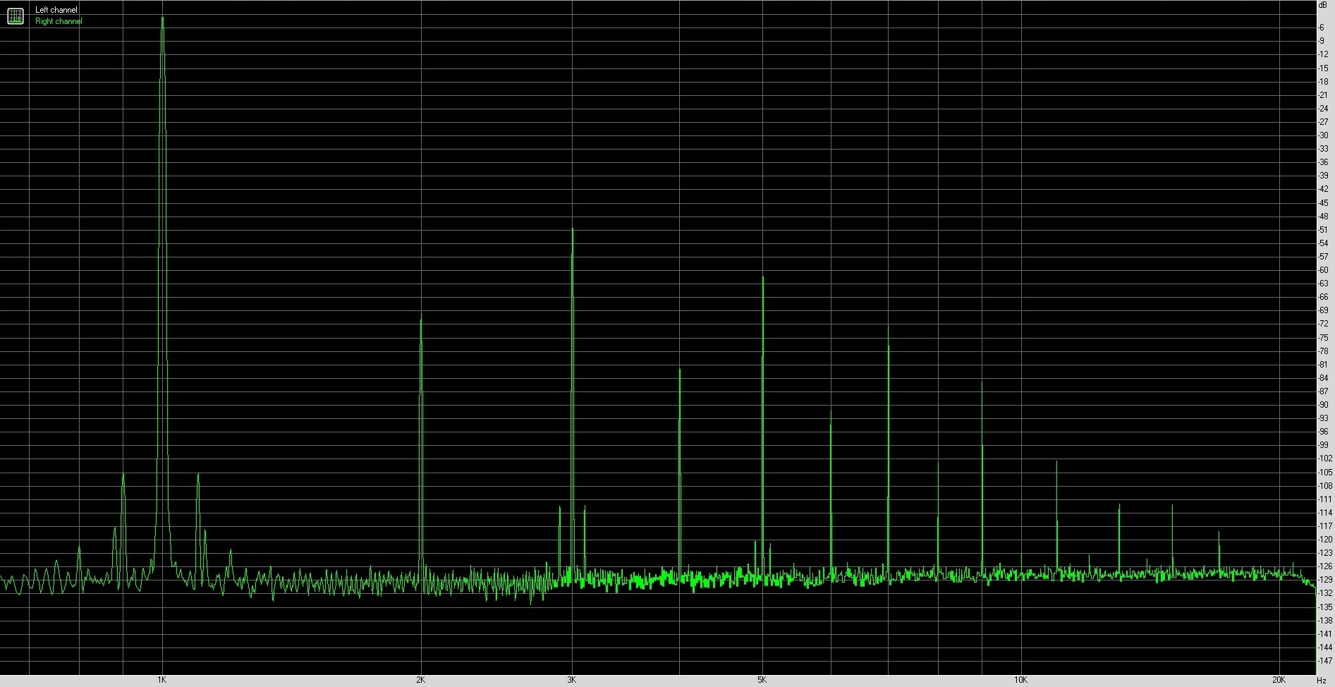

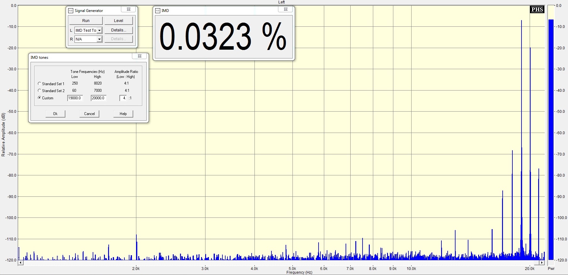

Lehmann BCL Rebuild, measurement of beta version of my own PCB.🙂

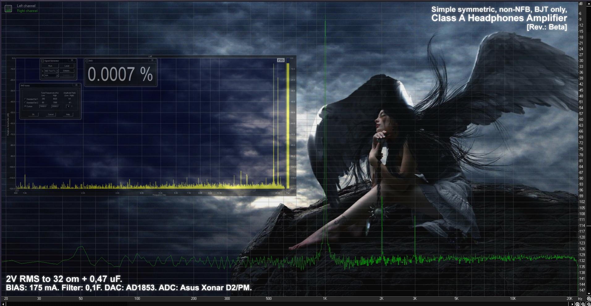

An impressive THD figure, do you think this is the result of the increased BIAS current of 175mA ( the orig. circuit is 40 - 50mA BIAS)?
Is the quiescent point stable with 175mA? , have you changed the value of the emitter resistors (10R)?

Yes and no. I had some tries with different BIAS currents on my test setup (breadboard).
In one case BIAS ran away till transistors started to smoke. I don´t know what happened, probably a mistake in my setup? I had a debate about that with damon1983 (via PM) and he stated that it´s no problem to increase BIAS up to 500mA.
In the moment I can´t give any instrutcions, because I don´t see clear regarding this topic.

It's A interesting mod. I will waiting your comments but 500mA BIAS is not a little aggressive for this amp?
Yes you are right, 500mA BIAS is overkill for a headamp.
But anyway, higher BIAS requires bigger heatsinks. I´m not sure if original heatsinks are sufficient.

500 mA will destroy crappy BD139+BD140.😀😀😀😀
And original stock heatsinks are not heatsink, it's like a scary joke.😡
I don't know, why they made bias 40 mA for discrete's class A. If needed low power amp - THS4062 (as example) will be enough.🙂
2V RMS to 4R+0,47uF measurements. (THD 1 kHz=0,46%) (BIAS=175 mA)
