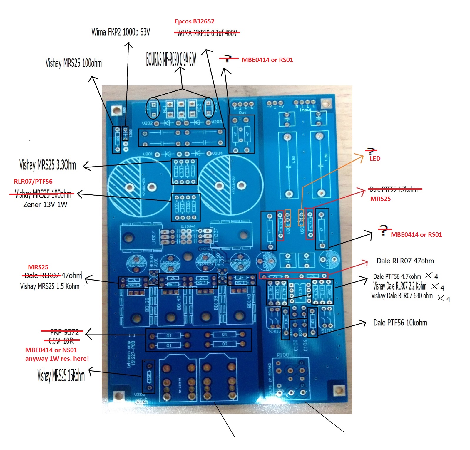

hello i am building Lehman clone and i want it will match to original lehman linear se or superpass it. i have clean board and few parts ordered. i gather some help and this is waht i am gather until now. i know basic soldering. help me to complete the parts that i need.
this is the parts that i ordred so far
ok, cleve i checked the list that you gave me and put things. tell if it is everything correct.
and there are 3 question marks that i wasnt sure what to put on.
cleve is the resistors is 1/4 and only 2 is 1w. i want better resistors than vishay, the wiam is better than epocos. look at hificollective
Resistors | Hifi Collective
there are plenty of resistors but most of them start with 0.5w can i put higher ones. i want some good quality resistors. i want the amp will be good.
If you continue on this path I fear I wouldn't be able to help you...you're missing completely the point.
  1. You MUST use adequate wattage rating resistors, or your amp will blow in you face
  2. Vishay makes among the finest resistors in the world (both measuring and listenting)
  3. Most 'audiophile' resistors are nicely coloured, they don't sound better.
If what you value most is the price, the most expensive and best sounding resistor HiFi Collective has in stock are VISHAY VAR (made by Charcroft on license), it doesn't tell you anything?
And no, you can't use them in place of MBE0414, they're rated only 1/8W...
BTW if you really want to use a resistor stocked by HiFi Collective use Kiwame 2W, they will fit perfectly and sound great (a bit coloured of course but in a nice way)
Not all Wimas are that good, quite all metallized caps are overly coloured, the only really excellent product they make are FKP2 (film/foil, not metallized).
Wima MKP10 are quite good too but the Epcos used by Lehmann are not worse in that position (more neutral, though).
BTW you asked me if your pic interpreted correctly my BOM, which doesn't indicate MKP10s.
thnx, i will consider all this, sure i will use 1/8 for all and only 3 1w.

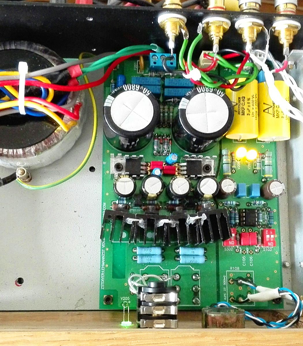

OK, My amp is working now. 😀😀
With the OPA2134PA, offset is 1,4mV and 0,54mV and I haven´t noises. The sound is nice, very spacious and detail.
Now I want to replacement the wima 0,1uF caps (I have the diode mod). Andreas told me that I can use low ESR cap. OK, I have a pair of Sanyo/Oscom 10uF/25V that I think it´s be right for this position. 😕😕 If it´s necessary, I have tantalum caps but I would like check the Sanyo before.
Them I replacement the Nichicon Gold Tune for Mundorf Mlytic on the PSU.

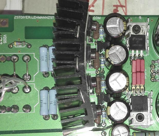

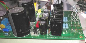

Well, among all builds going on here, I finally got around to tinkering with the BCL clone again.
I drilled and tapped new holes in some heatsinks I had that won't fit the PCB if not raised a bit. I'll add glue (heat tolerant) to the "clips" holding the heatsinks together. They stay in place fine without them, but it doesn't hurt to take extra care nothing goes wrong.
I also swapped heatsinks for the vregs, I had to modify those slightly as well.
Jumpered the position for "switching" HP jack if I want to use this as a preamp only.

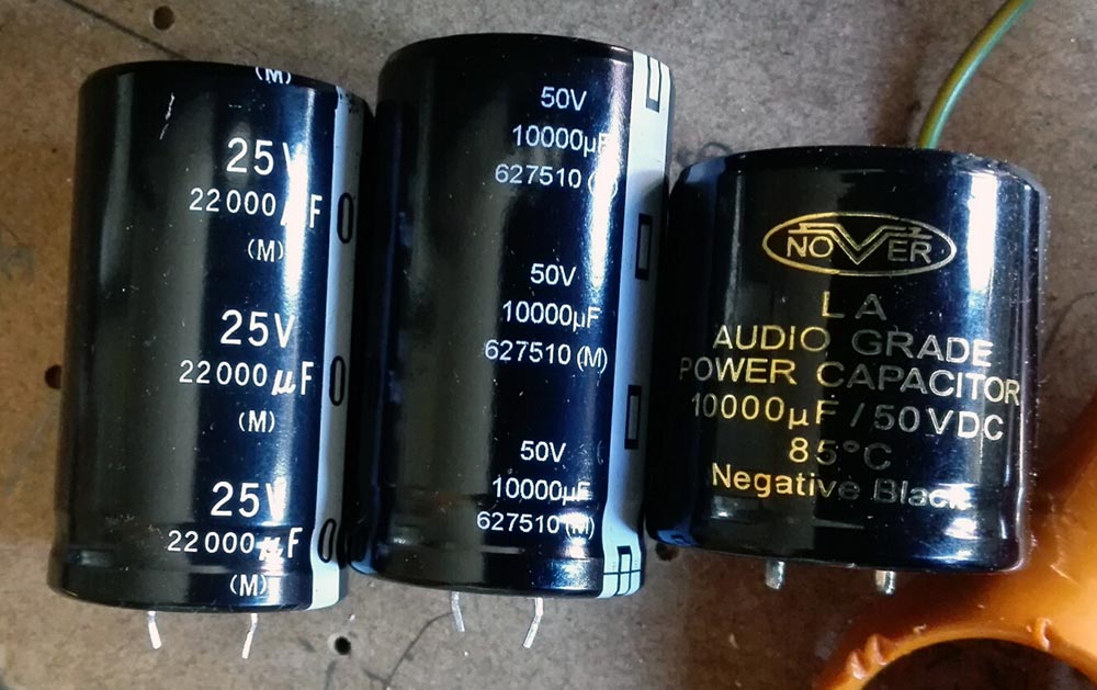

Looking at the board, I'm considering swapping the NCC PS caps for Panasonic ha's 10.000uF/50V(63V? I don't remember now). I have some unused ones laying around.
Edit: I also have some never used Nover that came with a faulty TA2022 BTL board. No clue if they are legit though. The Panasonic TSU's are more for fun, overkill and not high enough Voltage rating.

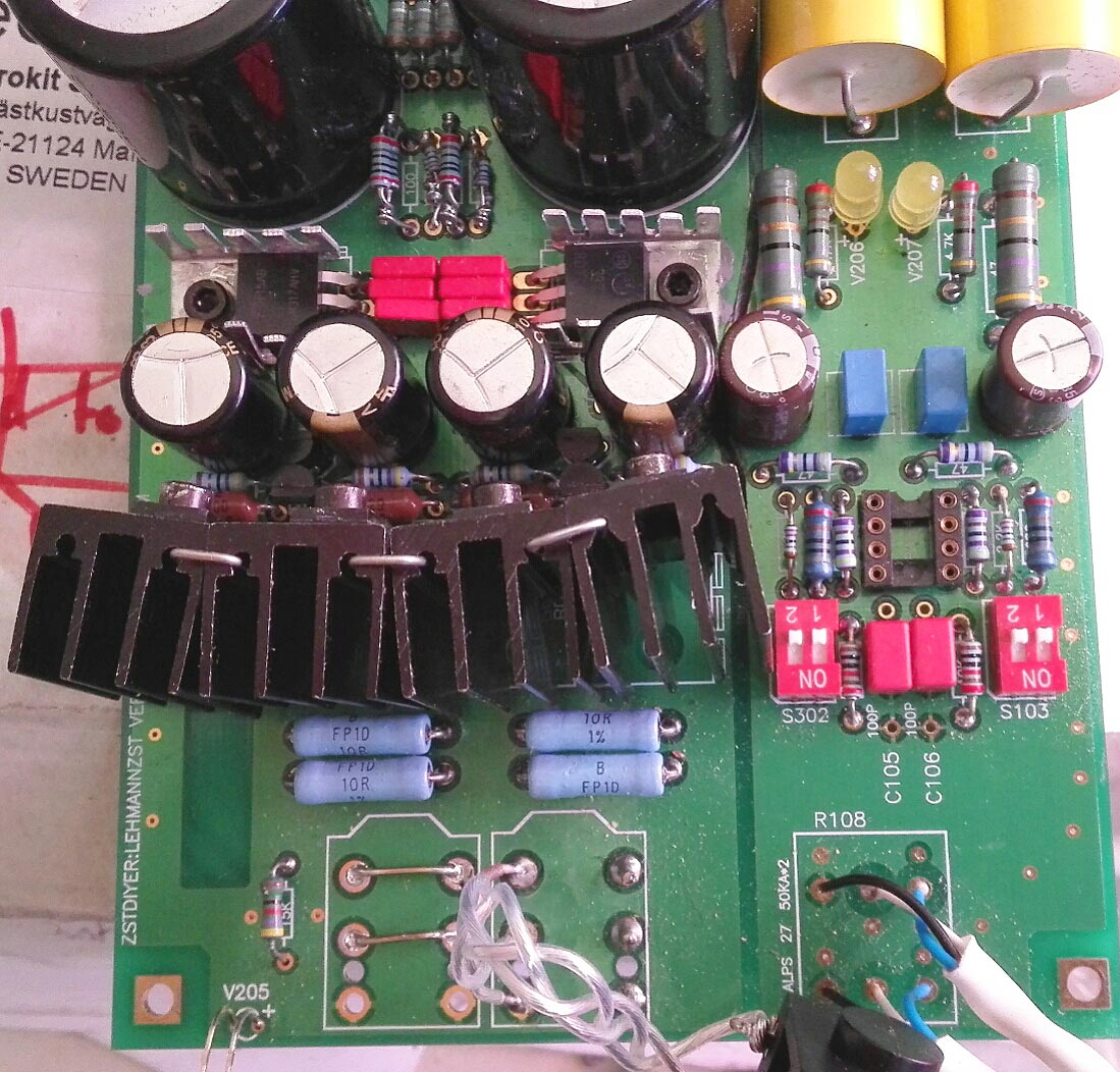

Well, it works and the heatsinks doesn't even get moderatly warm.
DC offset is +9.9mVdc, equal on both channels when warmed up for 10min or so..seems to stay around there.. It starts of lower strangely enough.
It also spikes a bit at power off... I do have a HP protection board assembled somewhere though.
I did the capacitor and zener mod while tinkering with the board.
I used BC 10uF/63V for the vregs.
I put some caps on the bottom of the board as well.
Under each PS cap (6800uF) I put:
3.3uF Pana FC
0.22uF Pana FM
100nF BC MKP
I put in an OPA2132 as I didn't have the energy to sort through my OPA2134, I know one or two of them are busted and they got mixed in with the good ones.
These boards are not the greatest quality tbh. I have a ton of experience with desoldering and rarely lift islands etc, I almost did that on this board though.
Sorry about the bad pic.
