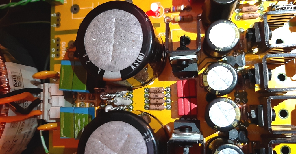

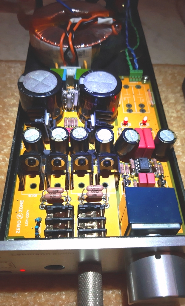

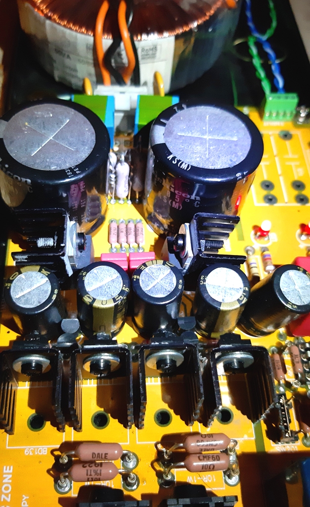

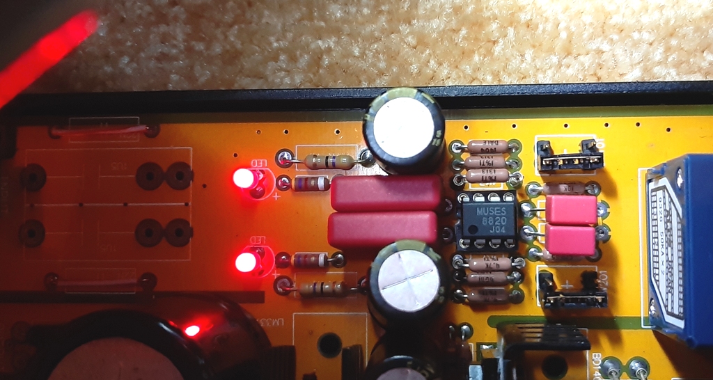

And here are a few picture of my 'upgraded' PCB, populated entirely by parts from Mouser (apart from the transformer).
Nice. I used mouser parts too.

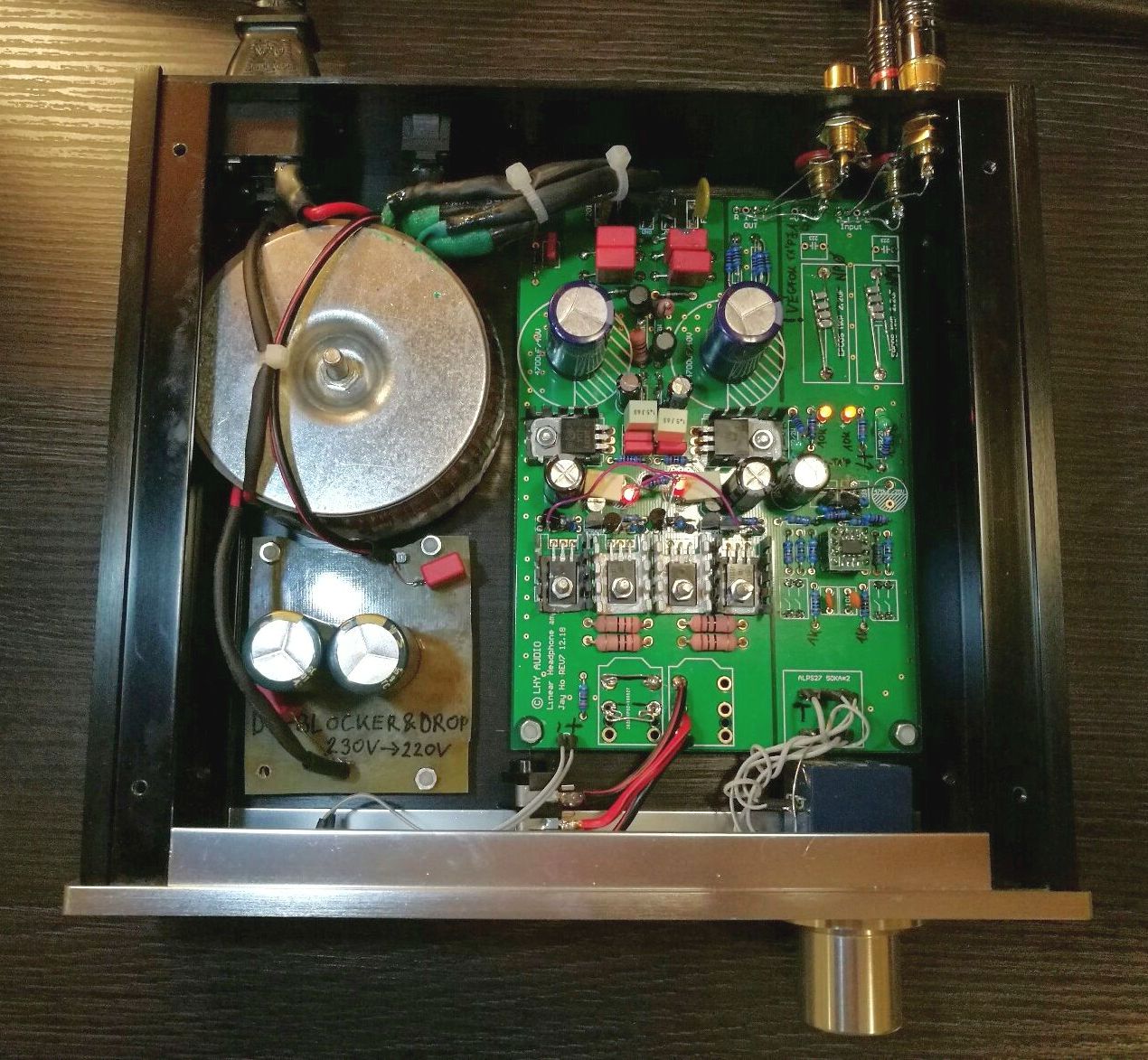

Reconsidering BCL
Hiya,
I've built my version recently because found my PCB bought long time ago.
I used CCS instead of 1.5k ohms in the diamond buffers created "Walt Jung buffers", and changed to global feedback with 150p local feedback cap around the OPA and ferrit beads on the output, outside the global FB loop.
LC filters are applied on supply rails.
Zener mod (remove 1.1k!) and biasing OPA into class-A are also have to be mentioned.
To avoid transformer buzz, DC-Blocker and 12V drop is applied in the primer circuit.
Sound: a completely new category than the original: open and virtually distortion free to human hearing (not just for measurement gears). 😎 To achieve this, sort the input caps or use NP0, and a good OPA!

Hiya,
To avoid transformer buzz... If trafo has a hum - his place in garbage. 🙂

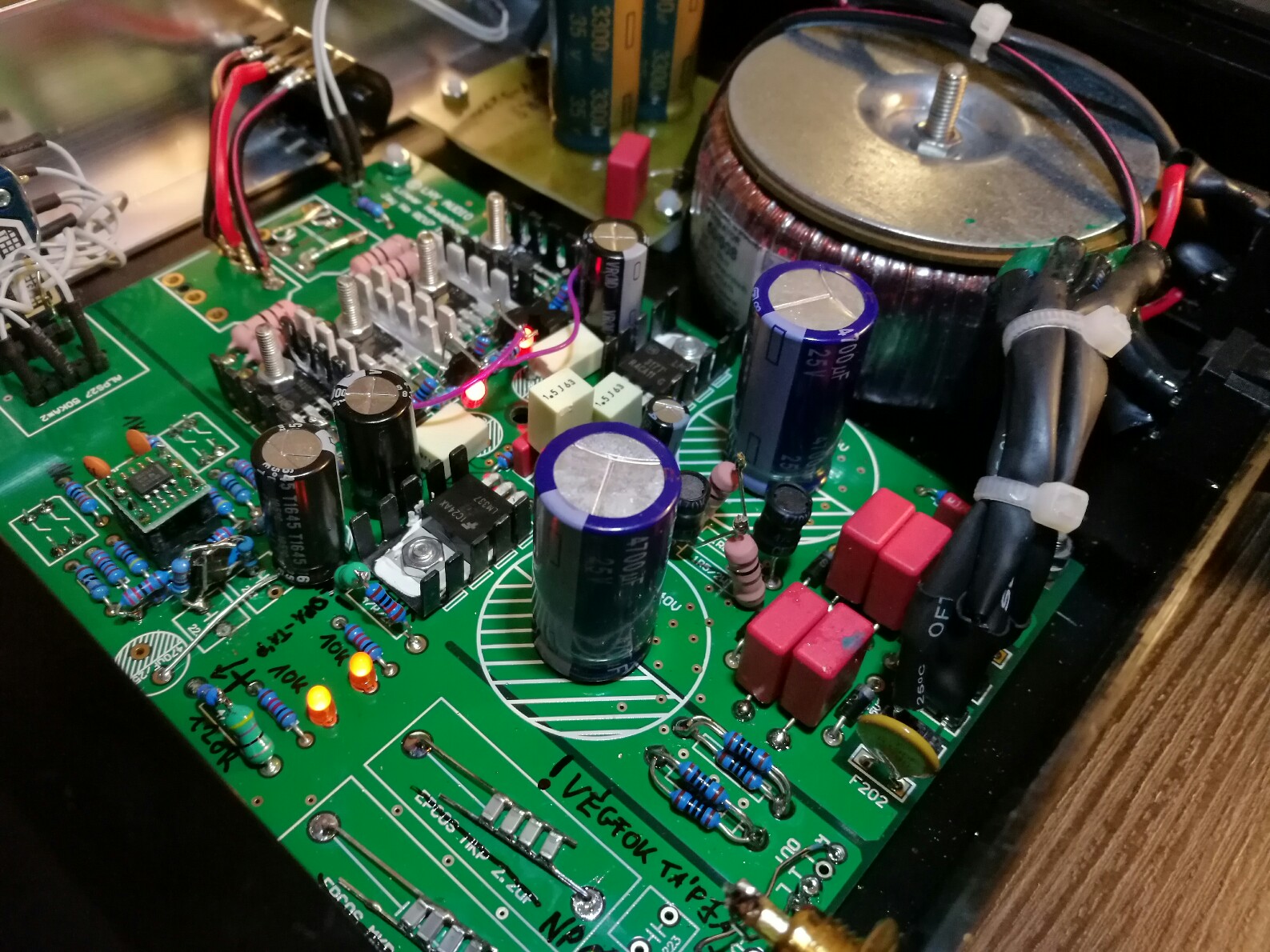

My BCL clone is now performing preamp duties, and very well I might add.
Since I have a little bit of headroom on the heatsinks for the output devices, I may raise bias for those at some point.

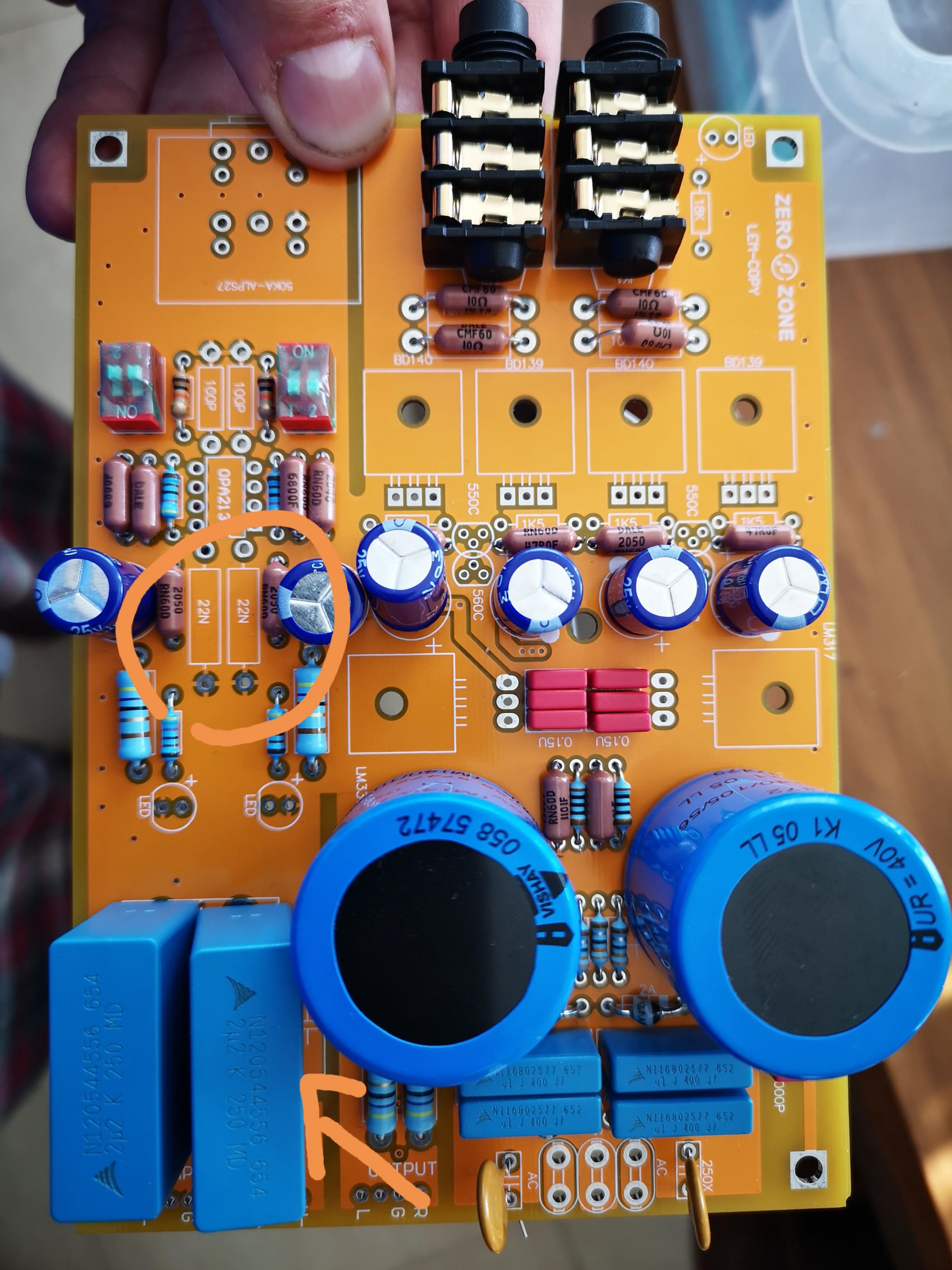

I can't see clearly at your photo how much space you have left, but it seems you need to replace those larger capacitors to make some space. I used MKT1813 0.33uF axial capacitors by Vishay there.
But i completely removed those input caps since I feed signal from AC coupled devices.
I now have just a wire link there.
For the two 0.022uF caps in front of the opamp, you can install 2 x 0.01uF polysterene capacitor (Xicon 23PS310) in each side.
One on top of each other.
Their width is 10mm, so typically they would fit in between the capacitors, albeit a bit tightly.
Measure the space among the capacitors to make sure they are 20mm or wider.
Just measure the hole spacing and use Mouser or Digikey to search for adequate Polypropylene Film capacitors. Since the width is restricted I suspect your choices might be quite limited, but you should be able to find something.
