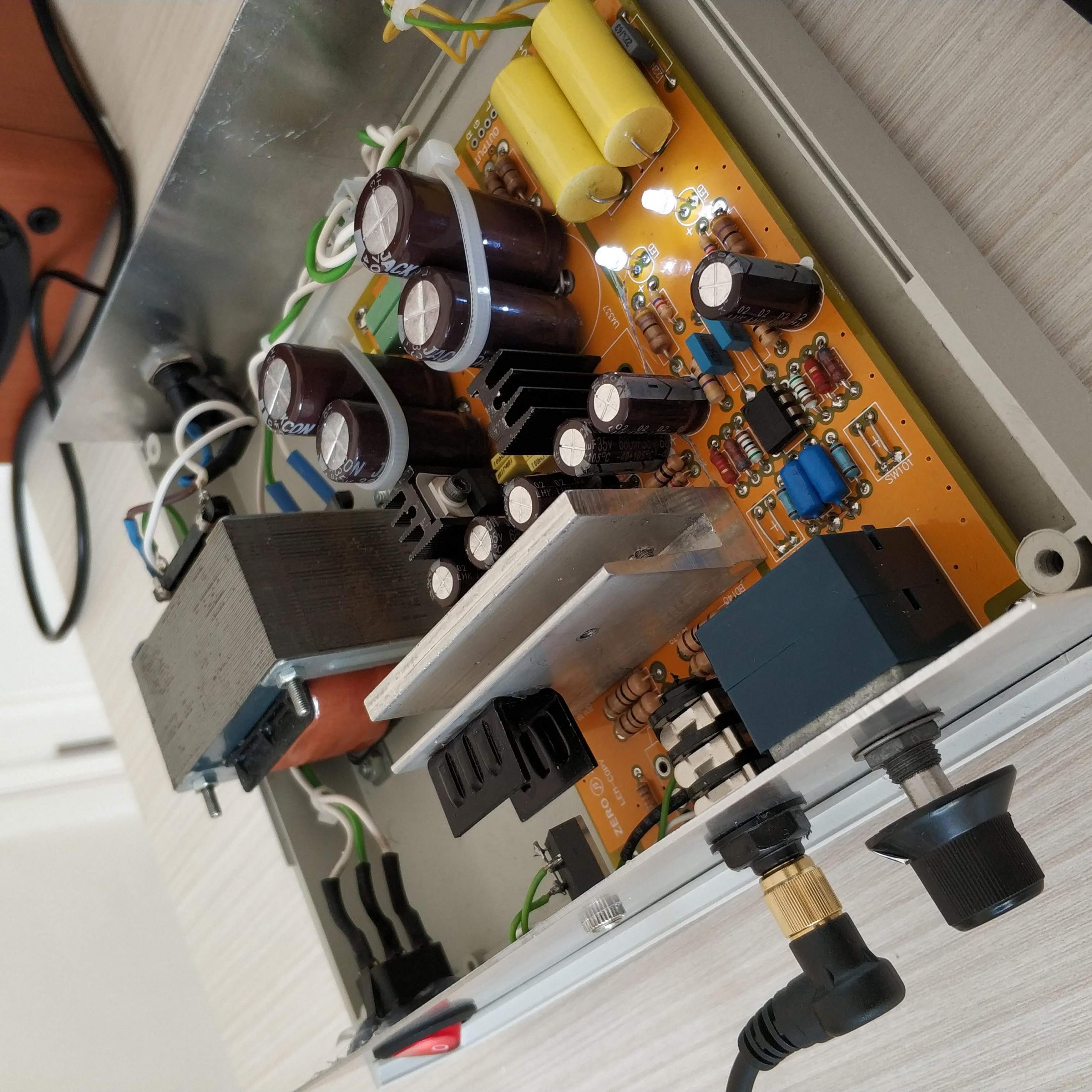

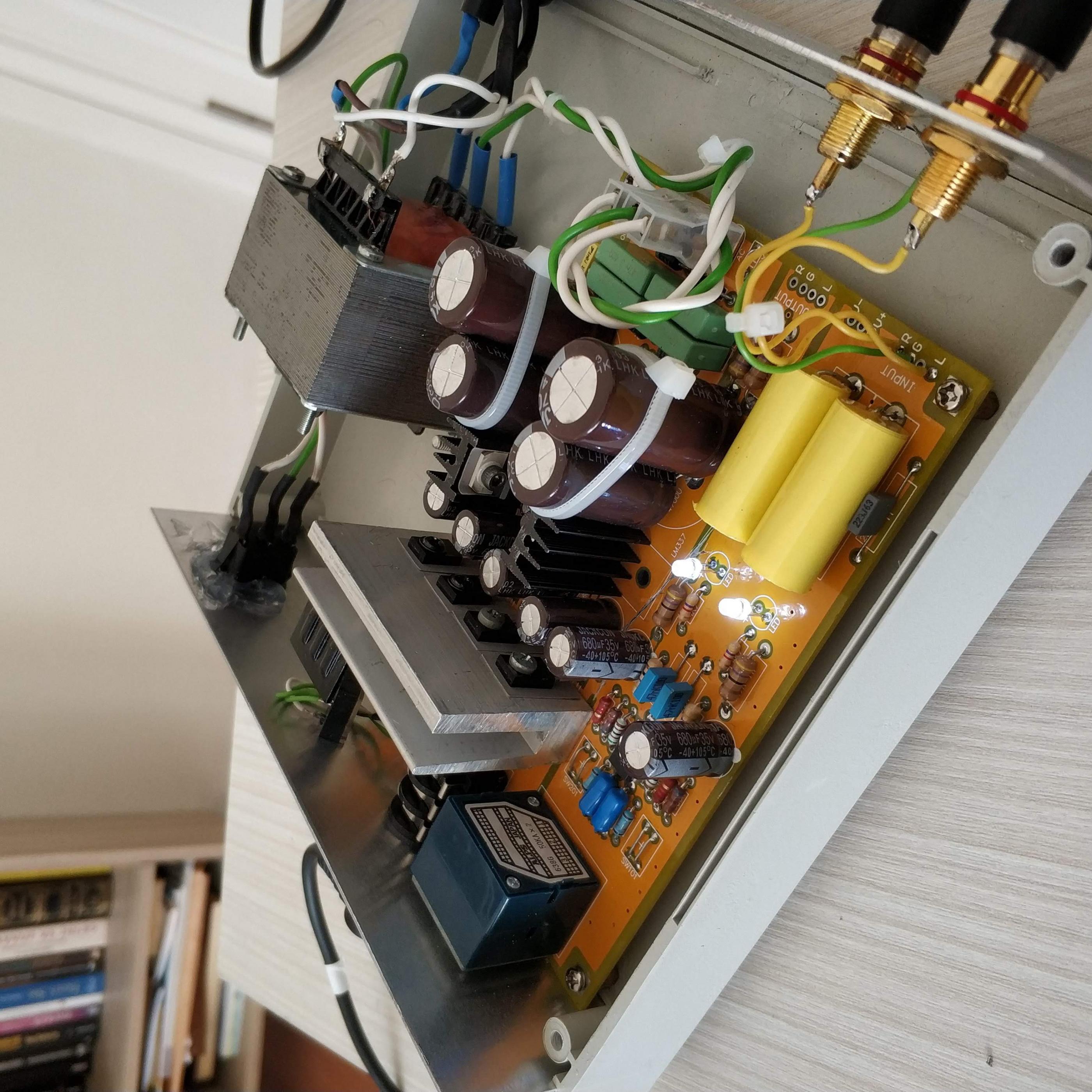

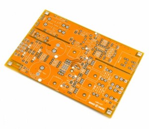

Hello!
I have a couple of yellow PCBs kits.
One populated with the parts included as complete kit and another one that I bought bare and have populated myself with upgraded parts from Mouser.
Both sound good but I am inclined to believe that the upgraded 'Mouser board' sounds better.
I have also another PCB (either blue or green-can't remember) coming, so when it comes I will look for any differences.
The yellow PCB is a 'ZeroZone LEM-Copy' and I think it is pretty well made since it has tolerated well with all the soldering/desoldering that took place...
And something for the gurus:
I get a DC offset of around -15mV on the right channel and around -5mV on the left.
This has been pretty constant with several opamps used (OPA2134, LM4562, OPA2227, NE5534, MUSES 8820). The only opamp that resulted in a lower DC offset was the NJM2068. It achieved -11mV right, -1 mV left. Actually, this opamp has been a pleasant surprise regarding its overall performace/price ratio.
Anyway, I 've ordered a couple of 200Ohm trimmer pots for each channel that will go in place of the two 1.1kOhm resistors next to the 100Ohms ones on the board. I'll use them in series with a 1kOhm resistors to adjust the Voltage regulators, in hope of lowering the DC offset.
Is this a valid approach?
Do not worry. Ask what you want. 🙂
Yes, this mod. will help you reduce the offset. It is not the only way but it is one of the simplest and most effective.
