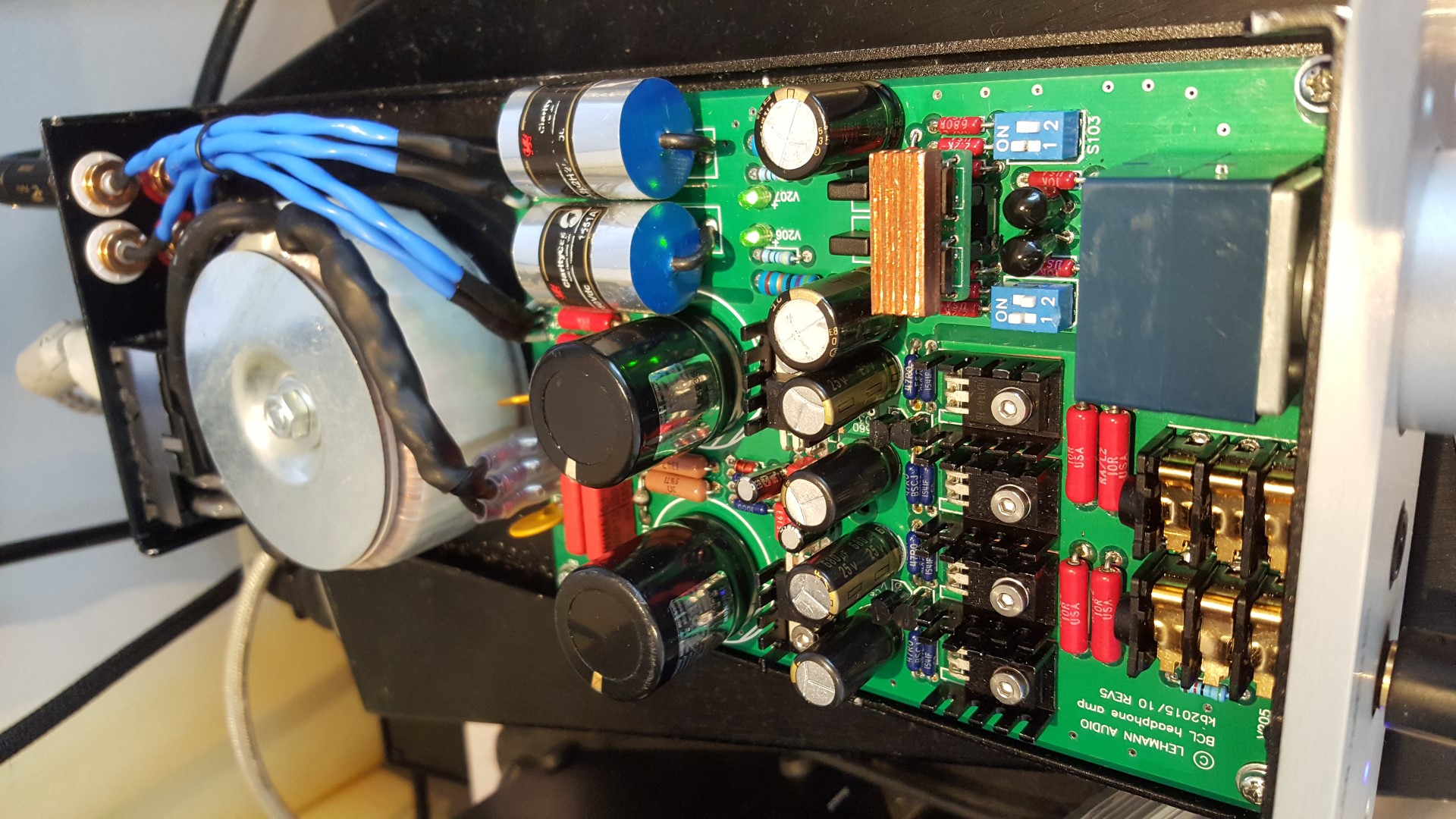

I've been playing around with the Lehman a bit. Placed back the original resistor values but upgraded them to RA resistors instead of the blue DALES.. Can't say it makes much of a difference.
What does make a big difference are the PSU output caps. These caps are influencing the sound even more than the electrolytes at the opamp.
I've played around with several sets and found out that they are very sensitive when pairing with different opamps.
I had the Nippon LXY 560uf 35V caps in place and found that the OPA2604 (or dual OPA604s) sounded good but veiled in some kind of way. I decided to roll my OPA627s and this created a more clear sound but on the thin side.
So I remembered from the build up and experimenting with different sets of psu output caps that these could influence the sound quite a lot. For example the LXY 560uf 35V sounded more 'full' and lesh harsh than the LXY 470uf 35V and the Panasonic FRs sounded to thin but more detailed. But at the time I used one opamp to keep the device constant.
I have bought myself some 680uf 25V Panasonic FMs and 680uf 25V Panasonic FRs and tried different sets with different opamps and this were really day and night difference. switching caps mad me want to switch opamps really quickly. I've been using OPA627s and OPA2604 for the comparisson.
I've learned that different caps especially sound different in poor designed circuits.. Well it's not a secret that the PSU of the Lehmann is not of world class and quite simple.
Right now I'm cruising on Panasonic FM 680uf 25V as my output caps. The 680uf FRs give a bit more clarity but are also thinner and more tiring.
attachment.php
