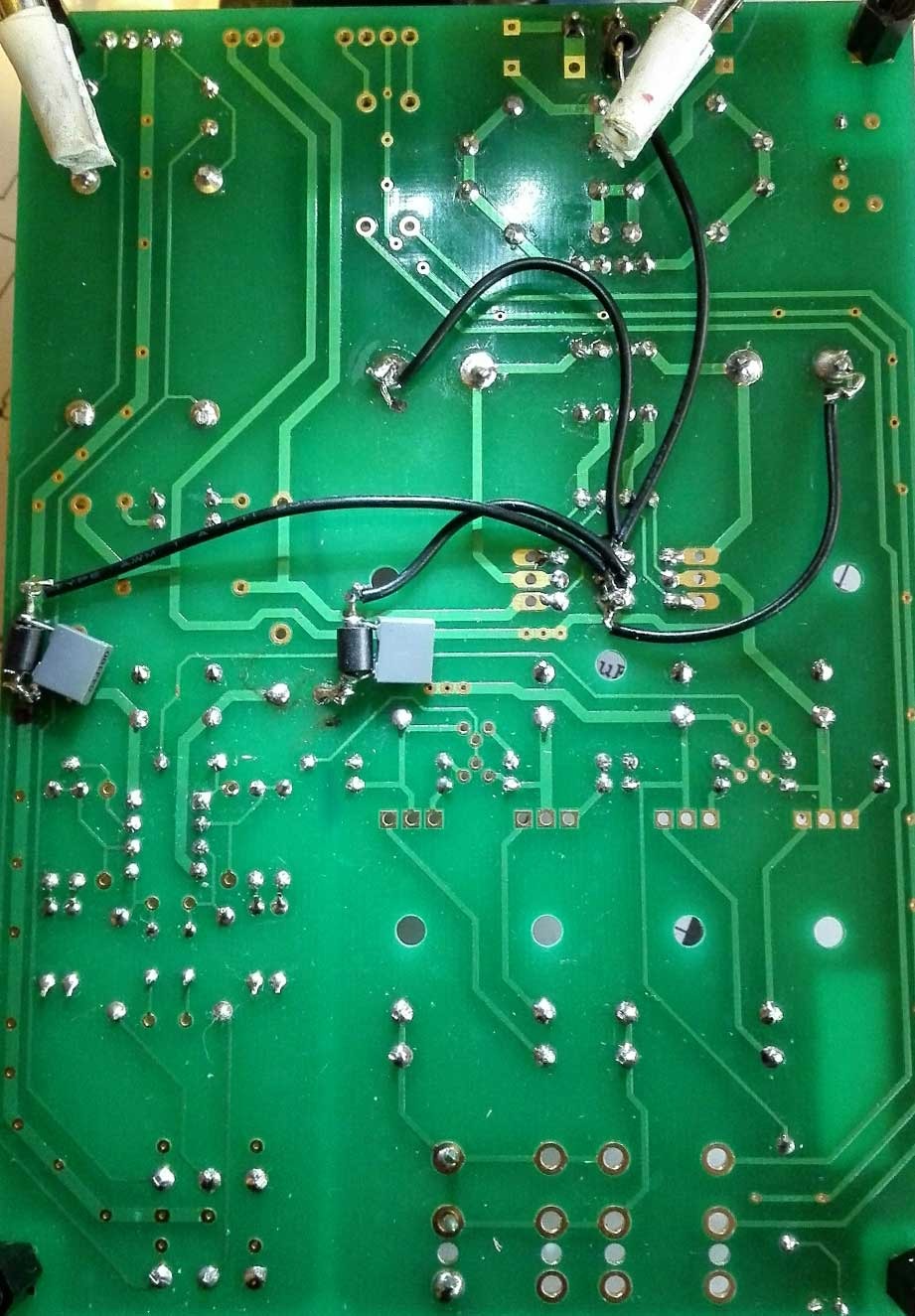

By the way, I had a closer look to the pics of your pcb; you did a cut through the groundplane. Is there still a connection between the planes? I can´t see the bottom side, so it might be there. If not - you got a problem ;-).

I've made a star-gnd under the PCB using a ferrite bead parallelled with a 100nf cap between the GND points and the star-gnd.
Writing from my phone, don't have pics of that on it.
Edit:
Found a bad pic, but you get the point.

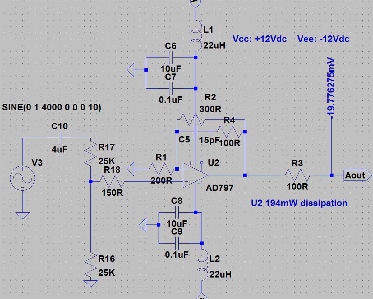

I also have a mod to try on the XP7, putting 22uH very low impedance inductors in series with the supplies to the AD797's.
In ltspice it is an improvement, remains to be seen if it is in real world application as well.

I plan to use AD797 in my hp amp. project, so please can you tell me what will be the improvement using the series inductors in the supply rails.

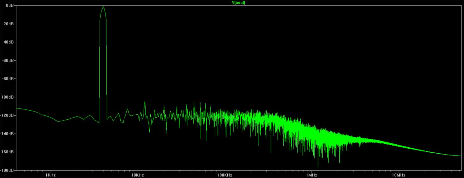

Thanks. This makes me curious, I would be very pleased if you could post the graphs when you have completed the simulations.🙂
I ran a quick simulation now.
I'm the first to admit that I'm less than an expert on designing audio or using LTSpice.
For example I used two resistors as a "simulated" pot...
