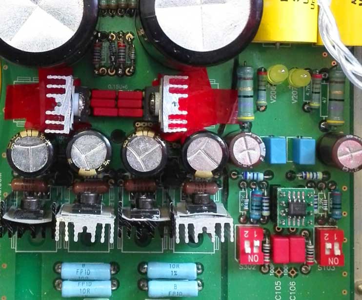

I had some time to tinker some more with the headamp today.
I noticed that the first heatsink to heat up is the LM337.
That and that I get about 13mV one channel and 15mV on the other (nothing plugged in) tells me something is off.
I'll start with measuring parts around the vregs, then if they all measure ok, I'll swap the LM337 (the one fitted is ON, not by choice but that is what the supplier sent so the rest are the same brand).
I've made sure heatsinks are not toughing surrounding parts both visually and by putting transformer tape (mylar or capton, I don't remember which is which now) on the PCB under the heatsinks for the voltage regulators.

Did you isolate the lm337 from the heatsink also ? It should make good contact with the heatsink and isolate heatsink from the board.
You could just swap it for another sample, but have you paired all resistors ?
Yes I know, I tried both with TIM only (Phobya Nano-Grease Extreme) and with a pad between heatsink and vreg.
Still, as they heat up fast there should be good enough contact between IC and heatsink (thermal transfer, not electrical contact).
All resistors are tested with LCR-meter/transistor tester and all have the same value.

Runs the LM337 significant hoter then the 317 ?
Have you measured the output voltage of the regs. and as well the input voltages? They should be symmetrical (with slight variation of course). Also the BIAS current of the outputstage would be of interest (Sorry if you already posted it and I missed it).

I don't know if it is significantly hotter, I can only estimated the difference since I simply put a finger on the heatsink.
It does get hotter, and does so faster.
After a while the other heatsinks get very hot as well.
I have not measured regulated voltage yet.
I don't think the circuit runs that high in class A, I don't remember the values now and the values I do have are from simulations in ltspice.
I'm writing from my phone, so I don't have any info in front of me. Just what I remember.
Transformer is a 2x15vac toroidal transformer.
Please do measure DC offset, would be nice to have the values of the original 🙂

I'll remove the PCB from the enclosure and go over the board one more time with the DMM.
I'll swap the lm337 while I'm at it just in case as I have plenty.
