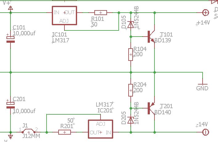

People say the power supply is the achillesheel of the circuit. What is meant by this? This weak spot would result in what? Less speed? Worse rhythm? Less power?
The power supply design is pretty simple and nothing special and most of all the opamp decoupling is poor and in general the RC filter on opamp supply lines is better than nothing but it doesn't isolate much the diamond buffer currents that reach the opamp.
The zener mod gives a first nice improvement but performance would improve replacing the 47R resistors and decoupling capacitors with even a simple transistor/zener based shunt regulator like the one I've implemented in my My_Ref variant:

Not speaking for people in general, only for myself but any classAB amp is going to create noise on its power supply. Noisy power supplies are the no.1 enemy of great sound in my experience - and my experience isn't unique. There is a reason classA is revered and in my estimation the reason is that it comes with quieter supplies.
This weak sport would result in what? Less speed? Worse rhythm?
Definitely inferior PRaT.
Less power? I have no better amp to compare it with, so it's difficult to hear things that are as good as I can have them at the moment.
You can compare against your own amp - adding more caps or increasing the bias in the OPS may well indicate that what you have now isn't transparent.

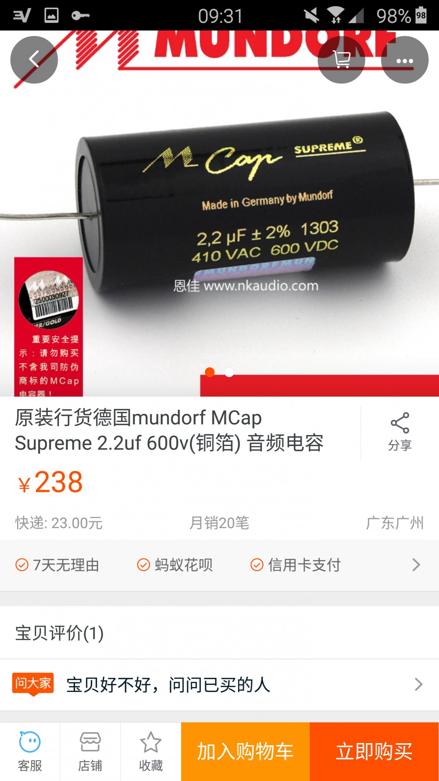

What do you guys think of claritcaps esa caps?
They are about twice the price of the standard mundorf mkp caps (which I find the most hideous parts from my device). Since ClaveFremen noticed me about that removing the input caps with a good DAC makes a big difference I guess there is still a lot to be gained here.
The claritycaps look very nice as a bonus and from what I've read they seem to be quite alright. The mundorf caps won't go to waste. They will find a place back on the other board which will be tuned as a pre amp for my active speakers since they require a different sound than my headphones to my liking.
Wasted money, not much better than MCAP and not so balanced.

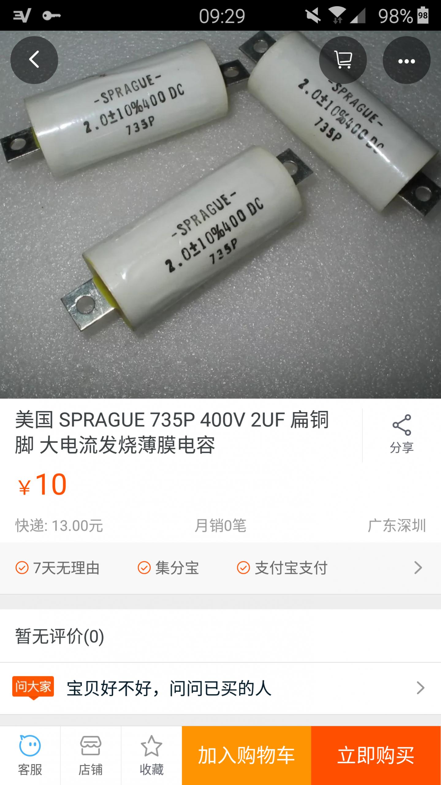

Vishay V735P is a much better choice or even better Mundorf Supreme (plain ones, not the oily or silverish ones)
These are all I can find and they look weird to me!
At this price range the Mundorf supreme caps are just not an option they are also twice the size of the normal MCaps and wouldn't fit nicely.
But thnx for your response!
The v735p I've used were with normal copper leads, I don't know how those strange terminal will sound.
Try to look also v730p, also good but a bit less full.
