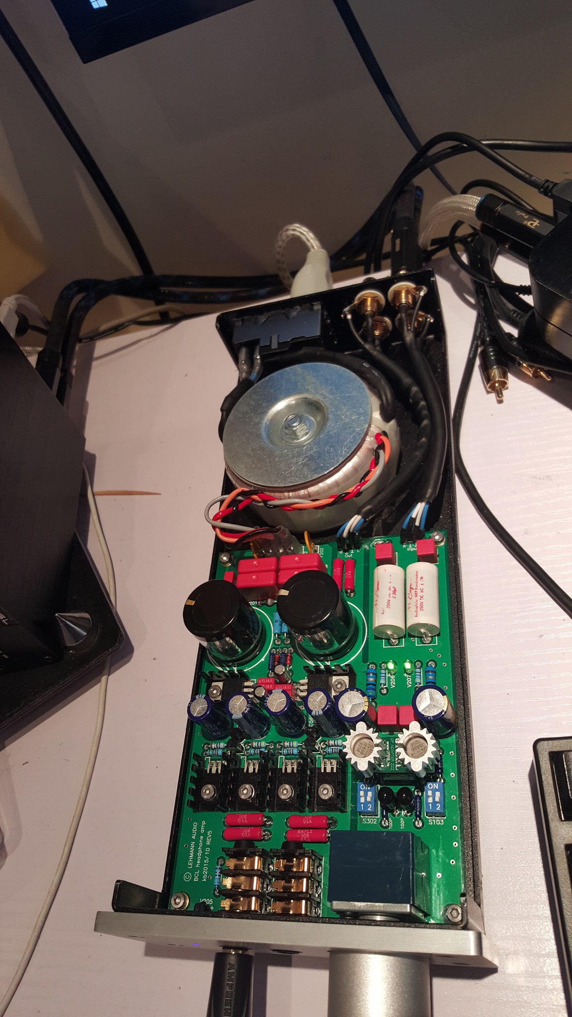

This is the Finished device for a while.
Nice lookin' ey!

The first of the headamps that will be compared to the BCL clone is done.
It's the AD797+BUF634 headamp.
Only had time to listen to it for about 30 minutes, and with Sony IEM's as I never hook my Fidelio X2's up to a new build.
First impressions are good though.
DC offset at max 8.4mV with signal(music playing) and HP's connected. But declining with time.
XP-7 clone?
Yes, the PCB is this oneXP-7 clone?
This and the BCL was originally intended as temporary until I got my own perf boarded headamp done.
Now I might keep one of them even when done with mine.
About the XP7, in my own simulations with AD797, I found that an inductor in series with each supply was benefitial.
This PCB does not have that, I might cut the +/- traces to the AD797's and put a low resistance 22uH inductor on each at some point.
Not having much experience with these opamps, I own three versions but don't know which is the better one?
AD797AR, AD797BR or AD797AN(only one of them in DIP8).
It's a very good sounding headamp too, it has a bit less dynamics than the Lehmann clone but it's as good and easier on the ears.
Parts selection is critical, though.
If I can I would suggest you to use the same blue dales used by the original manifacturer and, on the contrary, ditching the tantalums.
I've had incredibly good results with LZX on the BUF634 (buy the DIP version, it sounds fuller and better dissipates heat) and Silmics II black/gold on the AD797.

I've used Roederstein, Philips and Dale resistors, Silmic II's, MKP380, MKP418 and FKP2 (220pF).
The opamps are AD797AN and BUF634P, I have AD797AR and AD797BR as well.
Got some more parts populated today.
Btw, swapped the FC's for Silmic 100uF and Pana FM 680uF
The 47R by the opamp-socket are 0.1% (Vishay BC MPR24) the rest 1% but all matched.
I used 2x200R and 2x2K2 (in parallel) by the vregs.
The 47R by the Dale's are Vishay BCcomponents MRS25.
The 3R3's are Vishay MR30's.
Thinking of measuring the BC550C/560C's today to find good matches.
Boring and time consuming though...hopefully 50pcs of each will give decently close matches.
