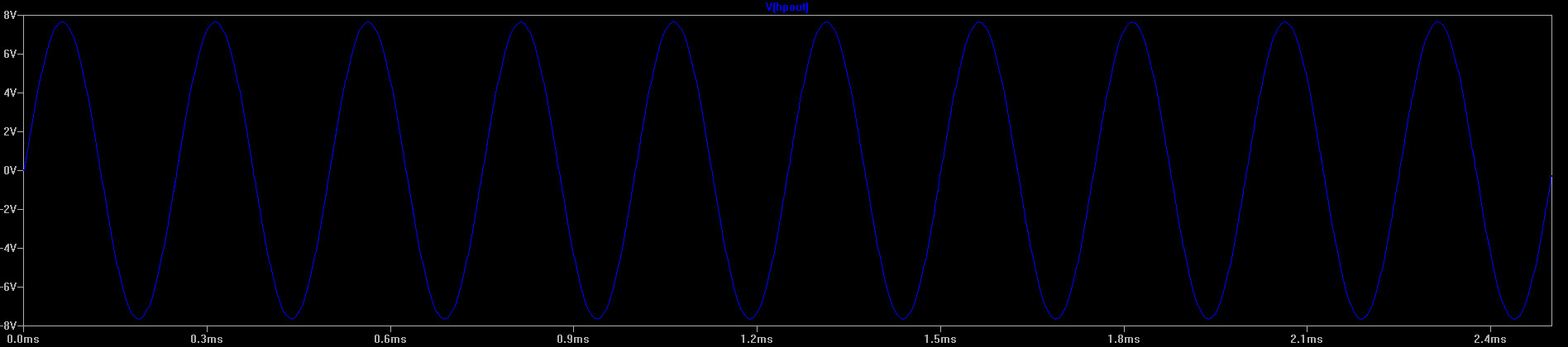

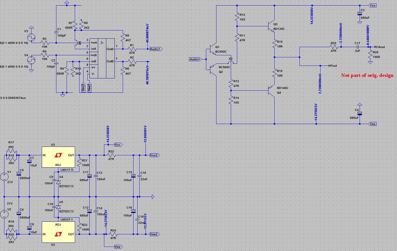

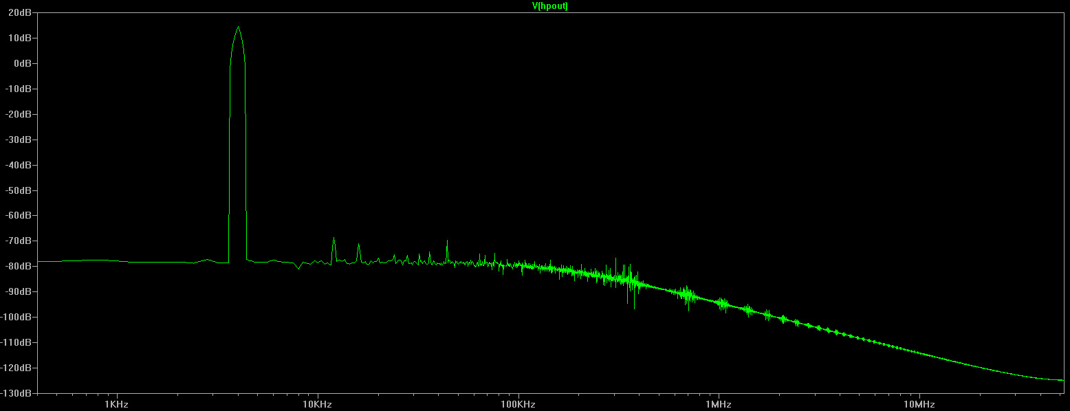

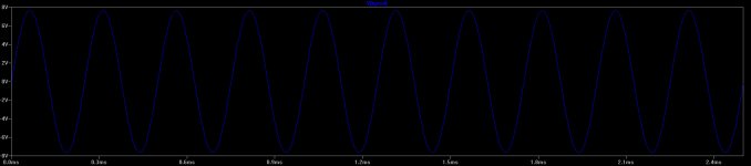

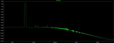

I did some sims in LTSpice to see what gain was the better choise for OPA2134 (well that is how it started). I then implemented the suggested mods and ran transient and FFT. I also added a cap and resistor to the RCA output to see if that would effect the sims, it didn't...but it does help protect amps etc if the BCL is used as a preamp.
Interesting to see that the DC offset is not zero even in simulations.
Now I did this while drinking my morning coffee so there's the chance that I made a mistake somewhere.
Thought the results might be of interest.

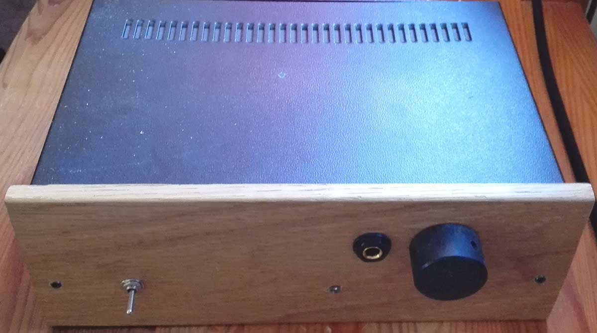

I ran the headamps first real test today.
I had it on for about two hours, fed by a Raspberry Pi 3 running piCoreplayer.
I used a pair of Sony IEM's as I don't want to use my Fidelio X2's yet.
@ 1h45m DC offset was +6.1mVdc/+6.3mVdc measured at the HP jack and with the vol turned all the way down.
Too soon to say anything about SQ, but atleast I consider it stable enough now.
Opamp: OPA2134
Gain: 680R resistor to gnd and 2K2 resistor NC.
This headamp runs hot. I had no problem holding a finger on the heatsinks or any of the caps. But I can see why caps age when using heatsinks connected to the PCB on every heatsource.
In retrospect I'm happy I had to go the weird way I did with heatsinking the transistors. Atleast their heat won't effect how hot the PCB and its components get.
Heat from the Vregs is enough to heat up the caps closest to them. I did use Phobya NanoGrease Extreme thermal compound between those heatsinks and the PCB though. It is a very effective, non-conductive TIM.

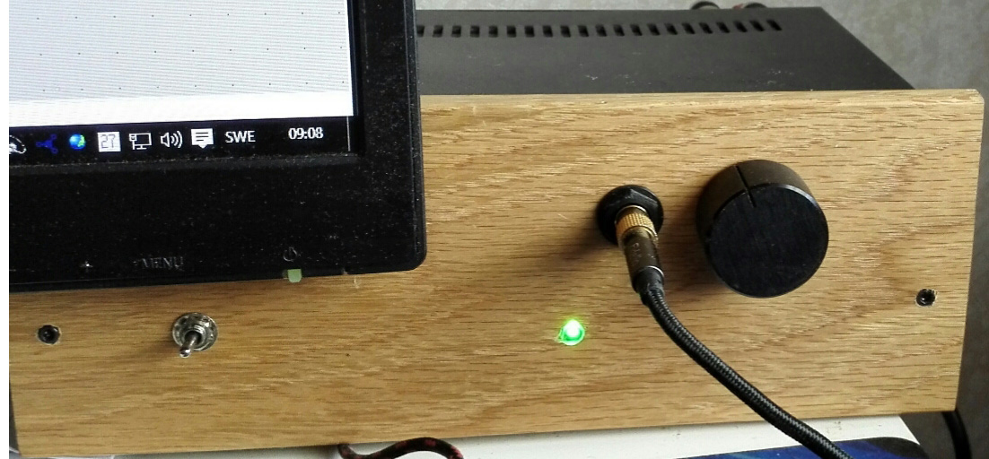

I've now been listening for a while to the "mkII" via the Fidelio X2's.
I'm very pleased with the sound. Though much more burn in time is needed.
This headamp and these HP's seem to suit eachother very well.
Using OPA2134, Gain set to +18dB (IIRC, 680R to gnd).
Interconnects are DIY 99.999% 0.6mm silver wire in ptfe, litz-braided.
I know alot of people will frown on that but I like those cables.
Total time the mkII has been playing is less than 10 hours so there's alot more to expect as the headamp settles.
