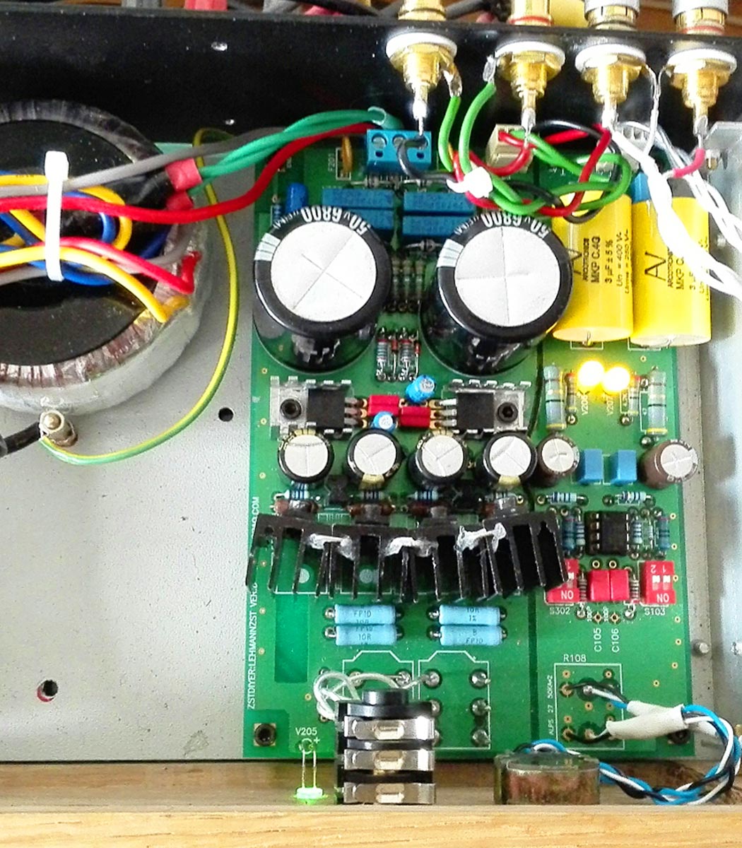

And original stock heatsinks are not heatsink, it's like a scary joke.😡
Thank you, that's how I feel exactly and why I tried other solutions with what I had at home.
With my first bcl clone, I could feel heat radiating with my hand over the board (somewhere around 10cm above or so). With this build, not nearly as much.
I would like use other board for this amp... some like this.
This is nice board with space for heat sink. I found this photo in Head-fi thread.
Here, you can increase BIAS without issue of hot
I did some tests on my BCL right now regarding BIAS and THD
I soldered just a 10R resistor parallel to each 10R emitter resistor (only for one channel), so I got 5R emitter resistance. Like expected BIAS increased from 40mA to 80mA.
First I must admit that my soundcard is not the best for THD measurements, output directly connected to input gives in the best case 0,004%.
The measurements were done with 1kHz 450mV rms to a load of 22ohm.
BIAS 40mA : THD=0,012%
BIAS 80mA : THD=0,004%, that means somewhere below THD of the soundcard
I think this nice improvement is not that big surprise but the question is, will it be audible?
To perform a listening test I have to modify also the second channel (it´s quick done), but at the moment I´m occupied with my family.
Temperature of transistors with 40mA is about 45°C, with 80mA about 70°C (original heatsinks), so it was not a problem during the short period (10 mins. or so) of measurements.

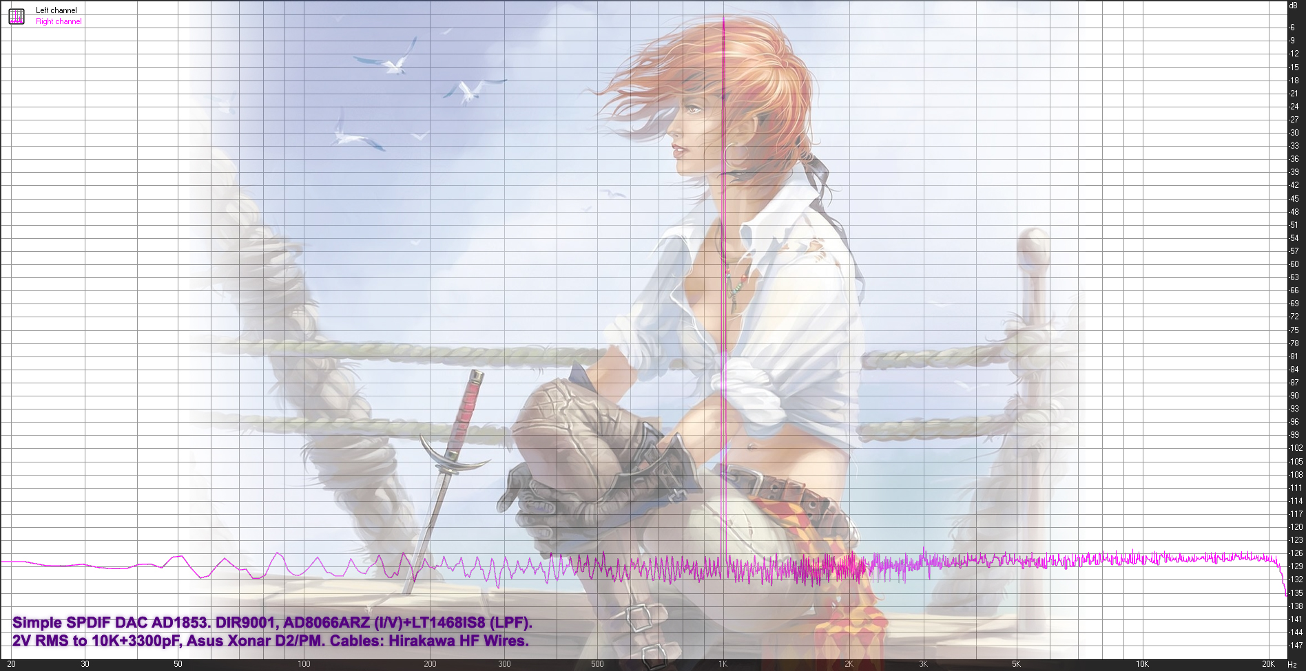

AD8066/65 very good OpAMPs (especially for I/V converters, I using it in my simple DAC AD1853).🙂

Second channel is ready.
Before listening test I wanted to check the temperatures. With closed box the temp. increased to 80°C ! (after 15 mins). Ambient temp. in my small workshop in the cellar is relatively cold 20°C, with let´s say 30°C ambient temp. we will go to 90°C or more. I see no way to do this mod. without enlarging the heatsinks.
But it should not be a problem for my listening test, with opened enclosure and powering off from time to time to cool down the amp.
