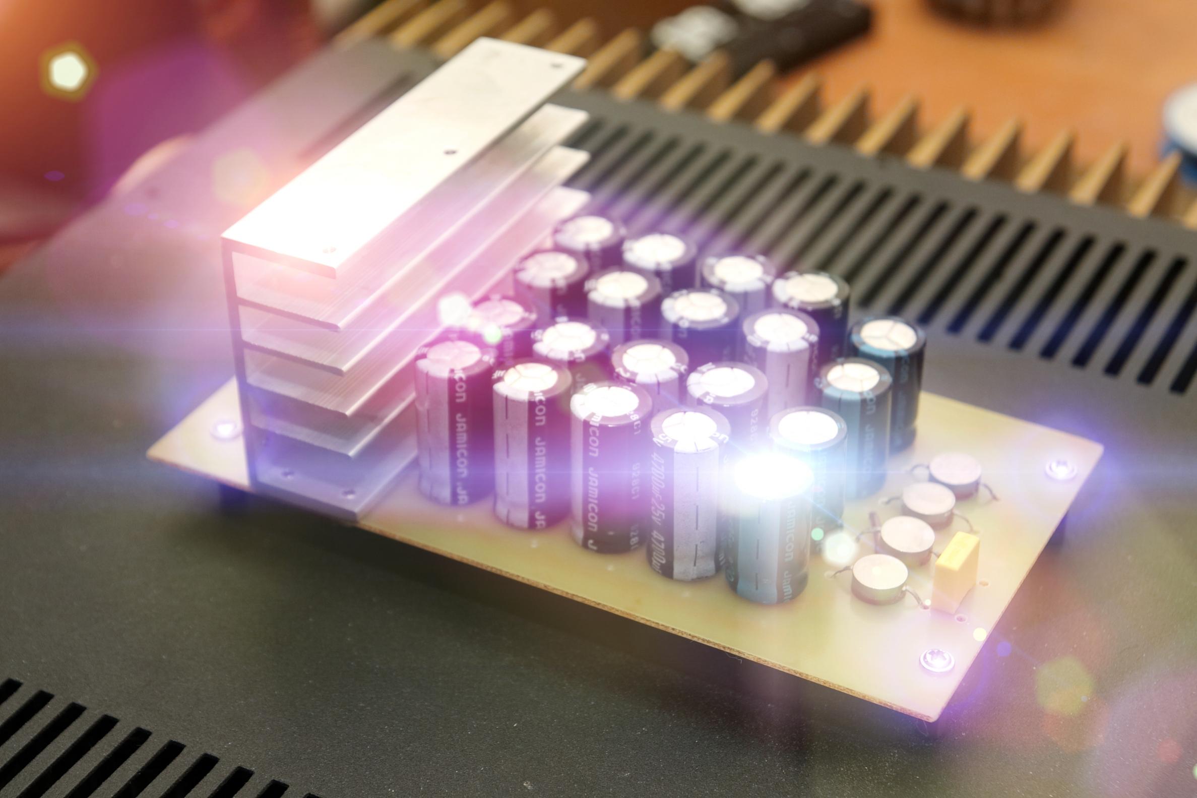

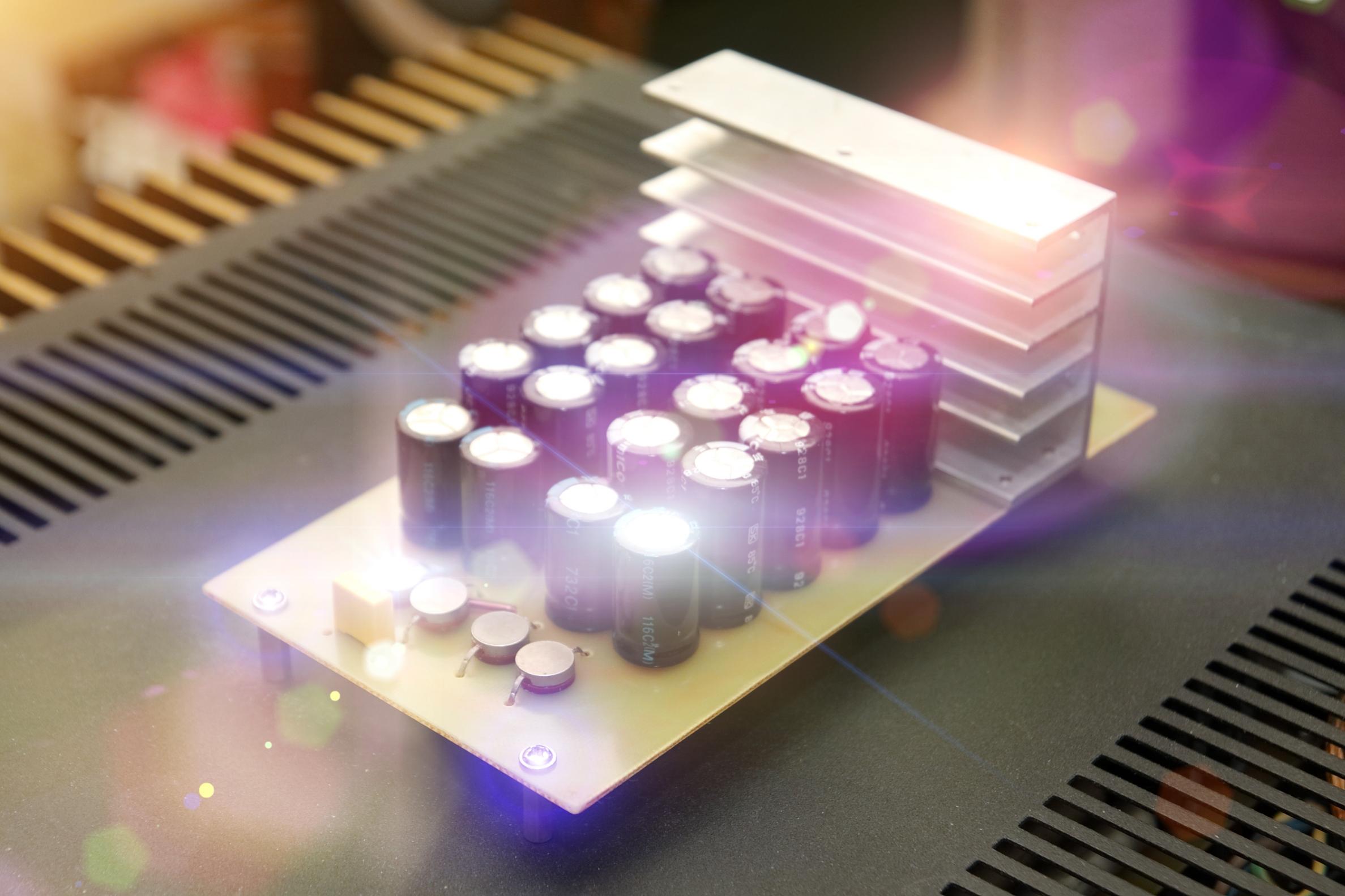

You'll unlike my PCB. It was 1st version "low-noise" ZERO. (Noises on 50 and 100 Hz were not bigger, than -110 db).
