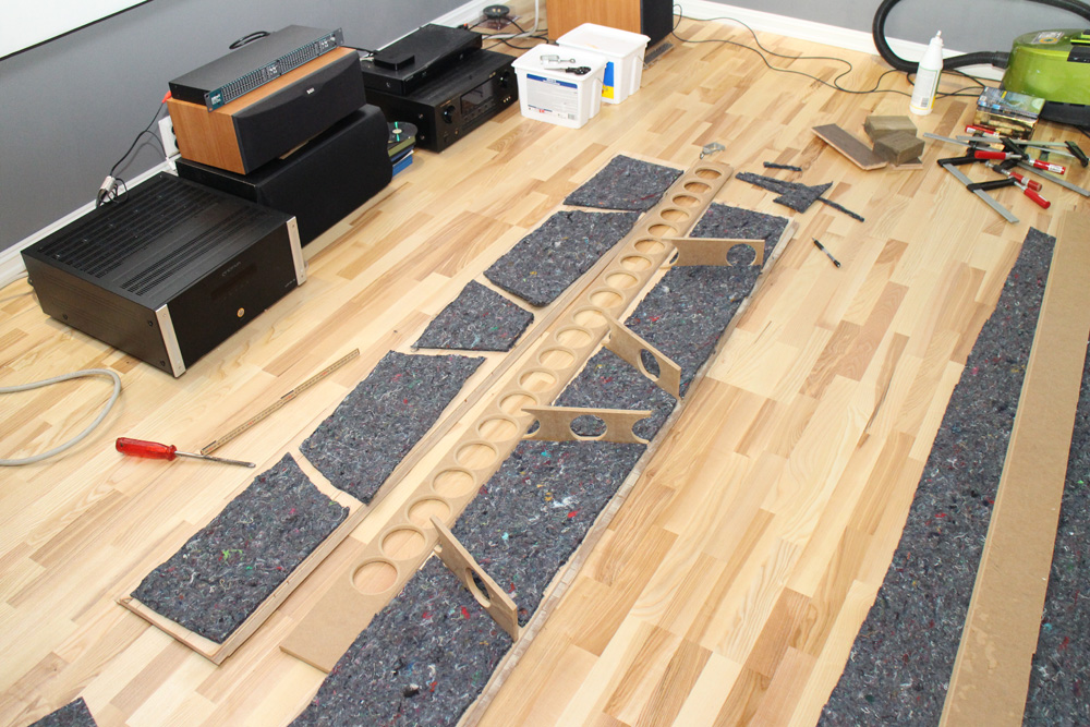

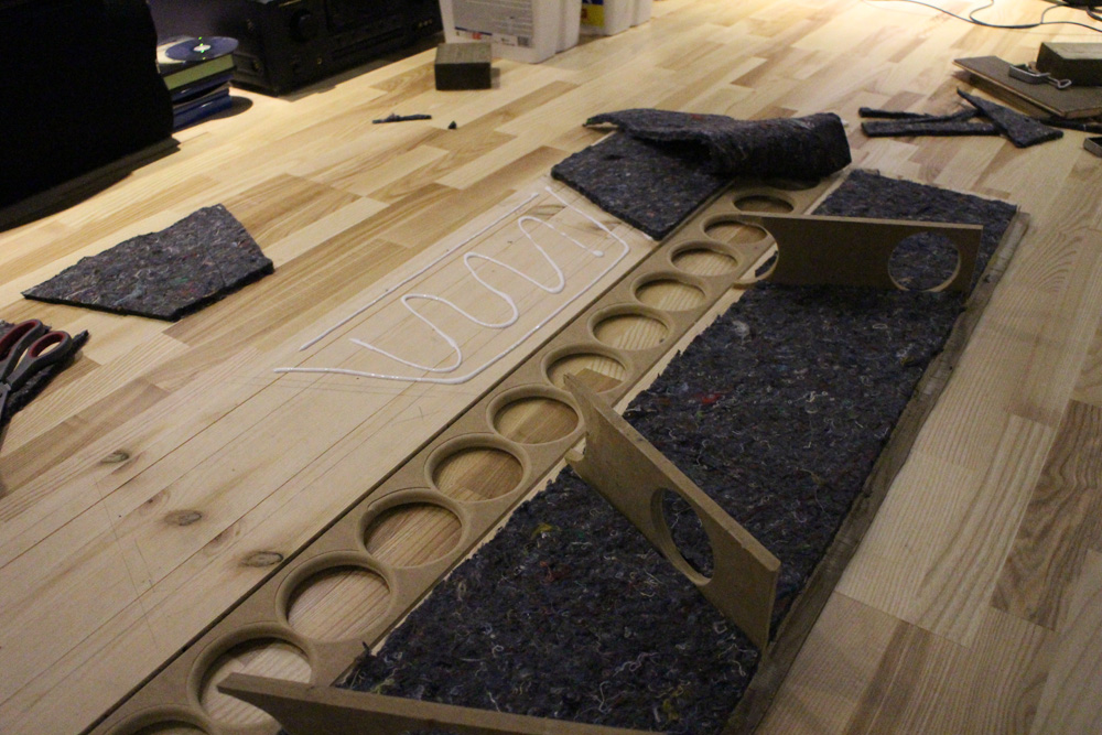

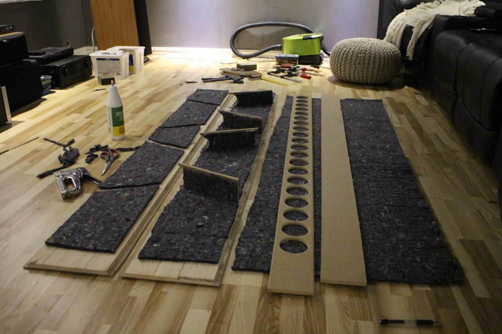

Halair Column - my line array build (20 FR drivers)
Getting there 🙂

wesayso said:
Second one goes fast! Great work...
Time permitting you'll be there in no time ;-).
Every little helps 🙂 Front baffle is now glued and clamped down, 80 holes predrilled for the mounting screws... If time is available tonite I will start to prepare the internal wiring 🙂

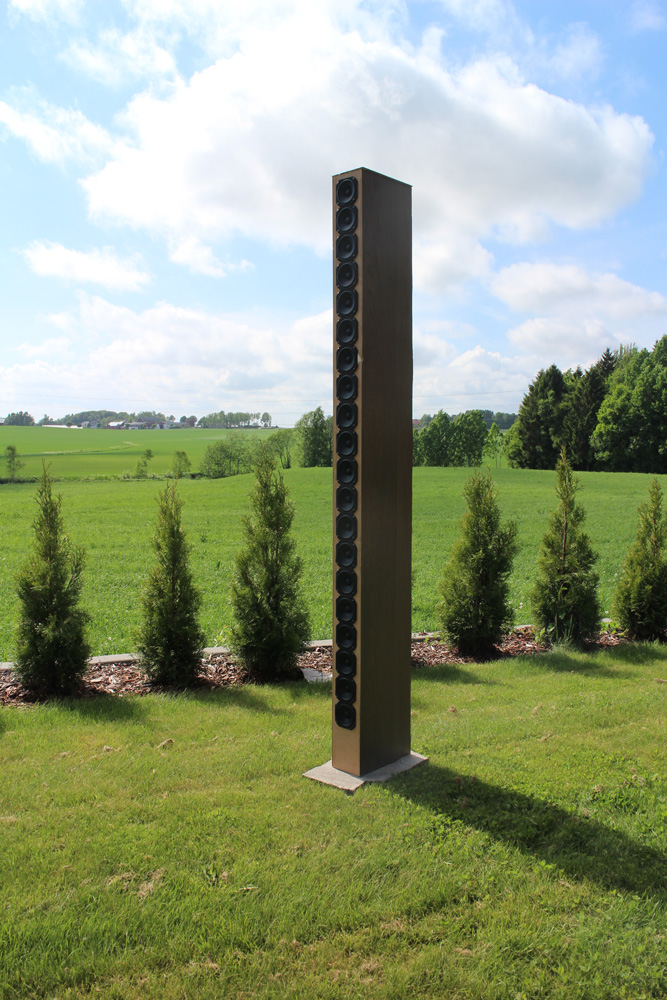

Took the first line outside in the sun to route excess flange materials off and also put in on the scale. 27,5kg (60lbs 10oz) with base on.
Nice! The photo reminds me of something on Easter Island or Stonehenge 🙂
Hehe, I should build a complete 5-channel setup and place it all in my front yard, that would be a "proper" Stonehenge!

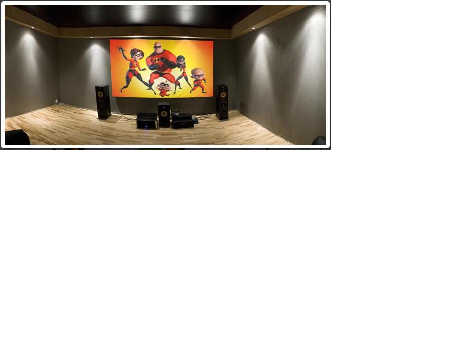

Late 2012 we got ourselves a new house and we had in the basement a surplus room with no immediate use for - so a home theatre room it became 🙂 About 20sq.m in size, with concrete walls/ceiling and no windows. Perfect starting point 😉 I am using a Sony VPL50VW Pearl projecting onto a 265x150cm screen (About 110")

That's a very nice PJ you have. I currently have a Panasonic PT-AE4000 with 80" screen. Originally had a 106" screen, however, being in the living room the setup was to awkward and a compromise was made... Don't know how much work you've done on the HT room, if you ever look at doing a material surround for the PJ screen [Bat cave style..] look at black Devore Velvet, one of the least light reflective materials you can use. Great for black levels and boosting on-screen contrast... 🙂
BMS - the first room we put the PJ in had windows on the whole side wall (facing west) and it was only usable during mid winter (Sun down from 5pm). We moved into this house in dec. 2012 so it worked nicely untill spring - which was a nice incentive to get the dedicated room sorted. I have attached an image of it. Its not a bat cave but kept fairly dark, ceiling is black paint, walls are dark grey. Soffits yet unfinished, might use red or black molton for those. (Molton is a fabric used in stage construction/scenes etc, very low on light reflection) I will check into Devore Velvet, thanks for the tip 😀 I intend to incorporate absorption panels for this room where needed, part of the reason for getting the umik-1.

Those soffits could be made into effective bass traps, remove the side panels [left open] and stuff with Rockwool or Acoustic foam and cover with fabric like you intend... Found a nice site about room acoustics with links to DIY absorbers / diffusers etc.
The soffits are today closed but unfinished so point of no return is still ahead of me 🙂 While closed they are not hollow as 50% of the internal volume is filled with glass insulation. 60cm wide, full height, then 60cm open (around the downlights) then 60cm filled again. The intention is to prevent resonance from this closed volume. I can adapt as you suggest to make it a bass trapout of it. Sound treating the room is definitely on my to-do list 🙂 Main idea is to have absorption in front of the listening position and diffusion at the rear, but that is as far as my knowledge on the matter extends hehe..
