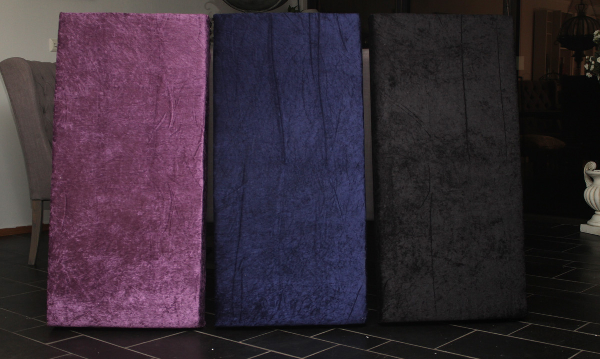

8 of these done :)
2" air gap, 3" Rockwool covered in velvet.

My side projects with acoustic panels is now coming to a close, finished the 12 panels yesterday night :spin: So now they are ready to be placed around on the walls/ceiling :)
When that is done I need to direct some of my attention to the soffits which as in desperate need for closure.

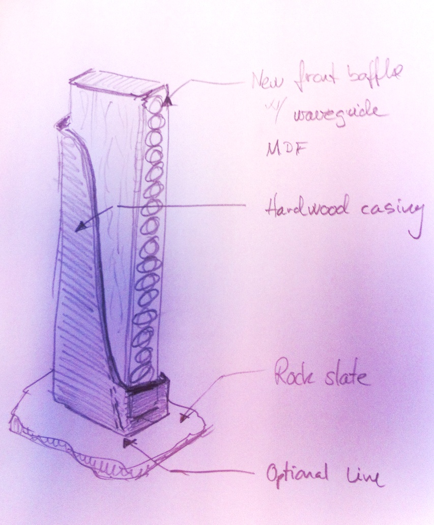

As far as the arrays goes - They need to be properly finished... They are operational but not finished :no: I have considered a front baffle mounted over the current one, incorporate a wave guide perhaps but not sure how to go about it.
Also, consider adding a extra layer of hardwood to enhance estetiques and alter cabinet resonanse. See attached image for idea.
Cabinet color solid black, casing same or brown - absolutely not sure :confused:
What do you guys think?

Nothing wrong with pimping the arrays a bit :D.
I like your sketch, but I wouldn't use that thicker piece sticking out on the bottom of the baffle. But you could still make it out of the hardwood for contrast, but make it flush with the baffle.
I'd also opt for a flexible substance/layer between the hardwood decoration and existing enclosure, sort of a CLD arrangement. For instance a glue that remains flexible after drying or maybe some MLV (mass loaded vinyl). I will use the MLV between (and behind) my 2 aluminium baffles that way.
Are you sure you want something in front of the speakers? Don't make it too thick if you do. Somewhere between 6 to 9 mm or so. You will run into the close spacing of the speakers that will limit the waveguide you can get.
I tried to make my baffle/waveguide design an extension of the speakers, and decided to go that way because it gave me a chance to keep the rear baffle thin (among other things). That thin back plate should help with the breathing on the back of the speakers.
Is your wish to use it for functional reasons or beauty? Using a ~ 4 mm thick plate surrounding the speaker frames would also be an improvement I guess. Sort of like how I did my test box:
As far as colours go: get the missus involved in this (lol)
The front baffle main function is to eliminiate the raised edge of the driver basket and adding a waveguide (although CC will prevent 360deg waveguide) seemed trivial. Covering up the mounting flange of the driver basket is also a bonus as I hate the idea to remove the gasket/glue residue on 40 drivers :spin:
However a smooth transistion similar to yours might be desireable aswell.
Black it is :p for sure....maybe

I second the idea of making your front baffle as thin as possible. Don't make huge waveguides for your arrays.

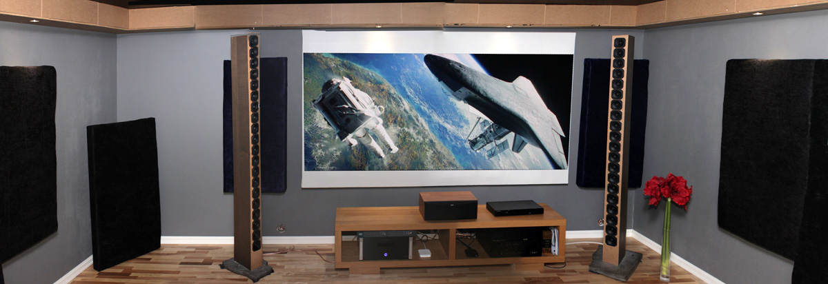

BTW - here they are in their full glory :) Quick and dirty photo merge...
Front wall is 16-1/2ft wide and the arrays are 6ft1" tall for size reference.
The arrays are toed in quite a bit and this works very well for stereo imaging in each of the four seats. The centre double seat is the sweet spot though :roll eyes :rolleyes:
A few of the acoustic panels is showing - these did wonders to the overall SQ in the room.

Yes, the SQ is superb and by far the best setup I have ever listened to :) I watched a movie a couple of nights ago (Gravity) and the stereo image is spot on and despite being in space there is a lot of "air" to it - indeed most pleasing :D In a little while you will know what I mean ;)
