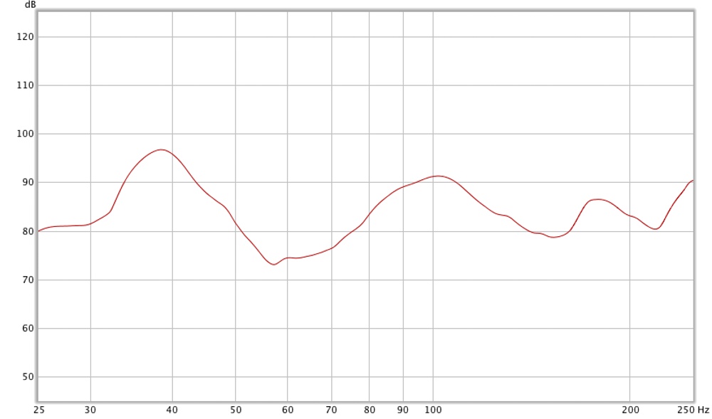

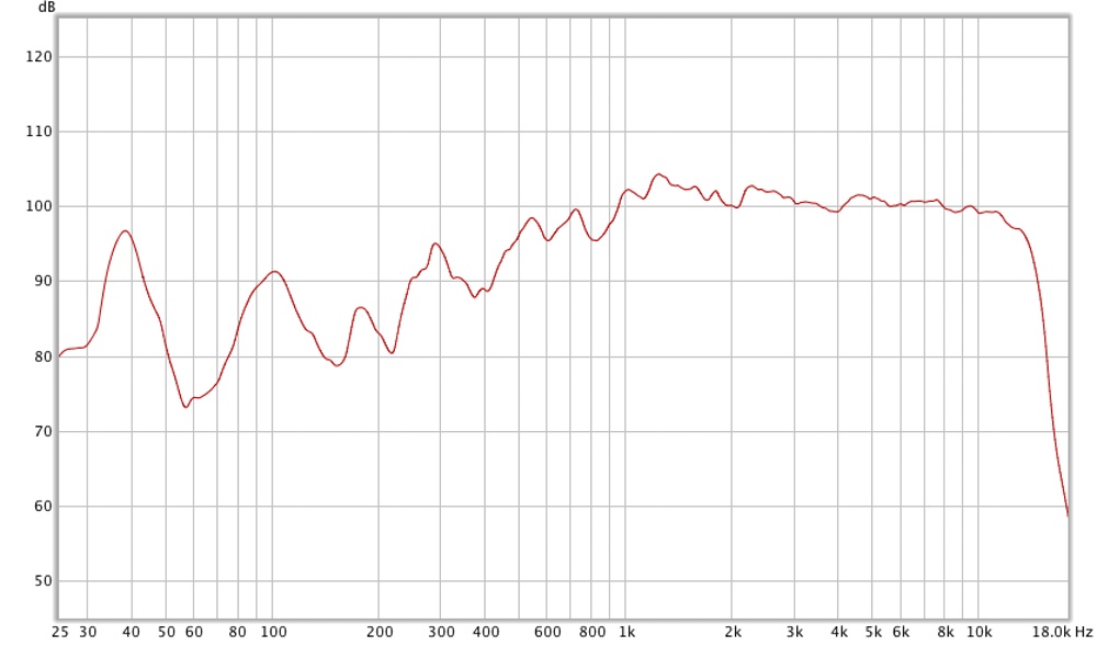

Got REW up and running, first sweeps made:
These are non-EQ´d sweeps btw and running system in stereo in a untreated room.
I need to learn to use REW properly, any input appreciated 🙂

I guess some of those peaks are room resonance. Going down to about 38Hz... that's really impressive! Now I'm thinking about upgrading my drivers! 🙂
I usually use 1/12 smoothing. I'm pretty much a beginner in REW as well, but ask your questions and I'm sure we'll be able to answer.
As for my readings, I have a mic stand and I place my omni mic exactly where my head is when I listen to music. Make sure you have enough headroom when you make a measurement, stay in the green, red means you clipped and the resulting sweep will not be accurate.

@ Perceval; I used 1/6 smoothing for these but is 1/12th used more widely perhaps? From my earlier experience with the DM604's I know that there are issues with the room. I should sweep the DM's to see whats going on 😉

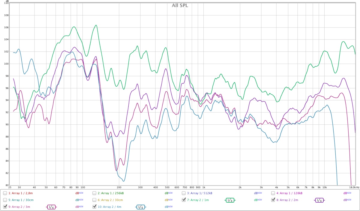

You will discover some problem to measure on LA ...need some distance to get a good result ..

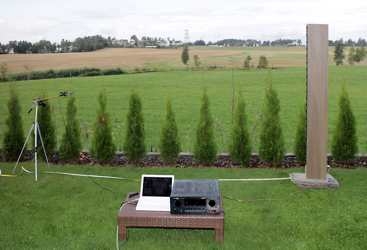

In your experience, what measuring distance is needed in order to get good results (true readings) Forecast for the next few days is rain so I am reluctant to take them outside...
good place to measure in listening position....but try also to measure one unit in near-field-
so can you se if the driver behave well in the box..
do not expect a super linear curve from the LA...so many unit give some hole and top..but it can normally not be heard
i sit about 3 meter from mine..but it will be better about 4 meter,,

Got to take the LA´s outside today 🙂
No EQ performed for these tests.
The complete set of mdat-file is found here - http://halair.com/rew/Outside.mdat
If anyone knowledgable with REW could try to interpret the finer details I would appreciate that, in case I have missed some quality to these measurement 😉
Nearest reflective surface is minimum 5m away.
