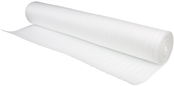

The craft EVA foam sheets that X mentioned would work well IMHO. If your lucky you might find some with self-adhesive backing. If not, something like 3M craft mount or photo mount spray adhesive would work well to attach the foam sheets.
It'd be a fairly quick job to do, maybe a couple of hours at most...
A hardware store may carry some thin foam on a roll. You may be able to get a sheet long enough for a one piece baffle, glue that on top of your baffle and just cut the holes with a knife before mounting your drivers again.
Some of those foam sheets have some finish/patterns to them that may be nice to leave as is.

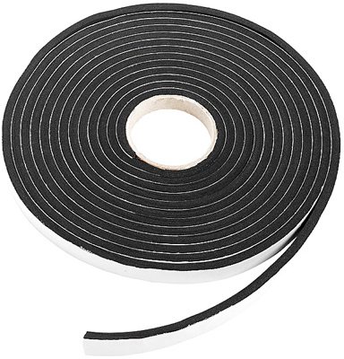

I buy 1/4" foam they use for sealing around windows and doors, it bends nicely around speaker frames and 1 side has enough glue to keep it there.
I also use it to seal my boxes if they are designed to come back apart,

I have 1/4" neoprene door/window sealer on hand (pictured dark roll) with adhesive backing. It is pliable enough to bend around the Vifa easily. Optionally I can also use foam sheets (white roll) intended for wooden floors which is 2mm thick. In other words it doesnt look like I need to source some special hardware to accomplish a tight seal 🙂
The Vifa frame is plastic, it will bend. Taming the mechanical trade-offs are the goal here 😉 While small leaks might not do much harm it do lessen the array potential so optimizing each factor / compromised area will improve the system performance. And the more power one insert into it the more will the difference be

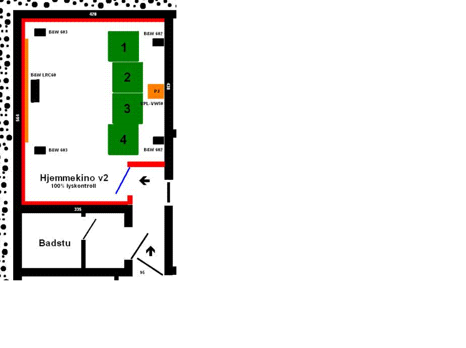

My room isnt ideal as far as hifi-room goes, drawing illustrate that well but it is what I got. Viewing/listening position is close to the rear wall so I think some diffusion will be needed here. QRD panels probably.
1.reflections will be dealt with absorption panels, 2" thick 2x4' panels or so. In addition the viewing screen is made with acoustic transparent fabric so I can place some absorption material there as well.

Be aware that QRD panels have a minimum effective distance dependant upon the panels frequency dispersion range. QRDude is a great program if you fancy making your own 1D or 2D QRD panels before tidying up 🙂
BMS - thanks for the heads up 🙂 I was thinking in the line of Skyline diffuser but the close proximity to rear wall might make that less viable based on your info. I could move the 4seat recliner a little more forward though... hmm...
As far as treating the room acusticly my first requirement will be to measure in-room frequency responce, then add partial 1.reflection absorption where required 🙂
