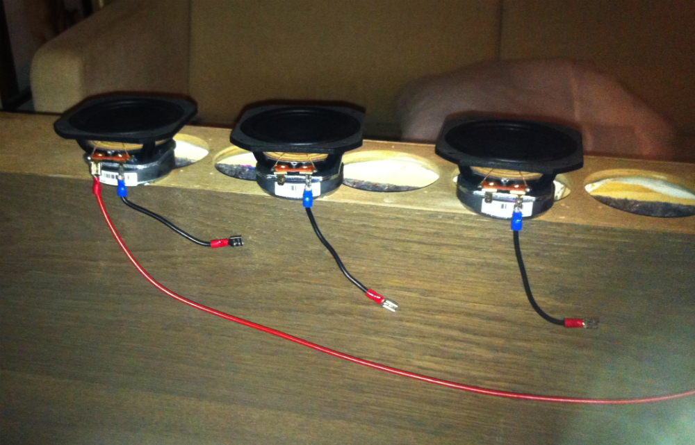

Btw - how do one measure total resistance of the driver circuit once all is connected?
I mean - as per Thiele-parameters a single Vifa TC9 have a DC resistance = 6.3ohm which mean if I measure resitance with a DVM it should read 6.3 ohm - correct?
And - measuring the complete array should then give me a reading = 5,1 ohm?

Yes, I beeline your calcs for 4 series 5 parallel with 6.3 ohm per driver nominal DCR seems right at about 5 ohms. If one of your drivers moves the wrong way under the DC voltage test it will be very easy to switch the polarity with quick connect terminals. The nice thing about quick connects is pulling a single driver off (if front mounted) once all is assembled. De soldering in place with a driver dangling out the front of a baffle is a pain and not always easy to get a good cold solder free joint.

I measured 5,2ohm DCR for the whole array tonite so all connections are good and wiring is correct 🙂 Pulled everything apart in preperation of finishing the top/bottom of the cabinet - which basically is as far as I am getting tonite...😱

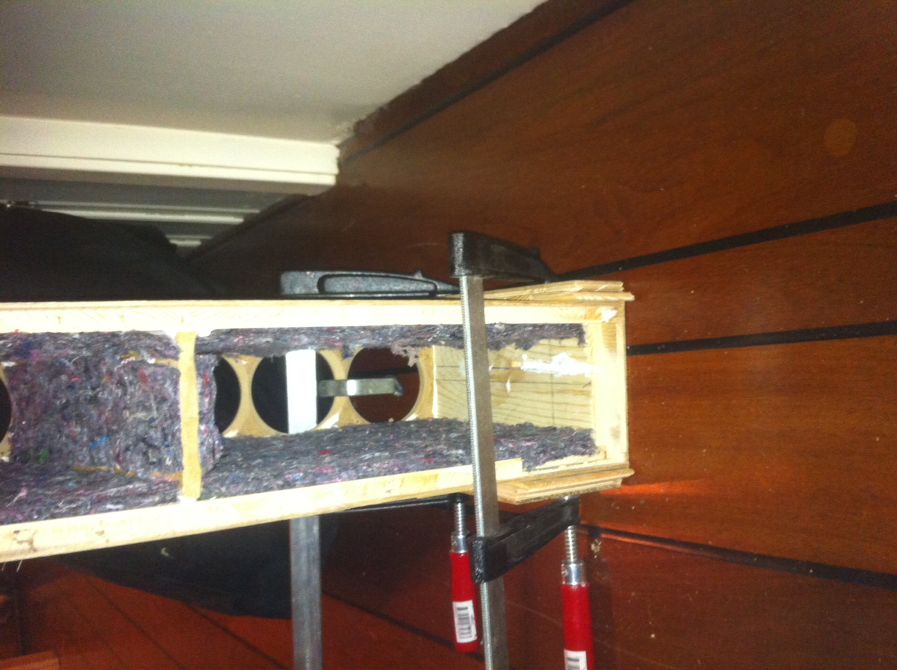

After a excruciating long week last week I found 30min of "me-time" last night and managed to fabricate the top cabinet plate (floor tile) and also the bottom insert (MDF)
I need to prefabricate structure to the bottom in order to fix it solid to the floor plate but regardless of that I am now able to glue the top/bottom shut - my intention is to do this this evening...
Once that is firmly in place I will start installing drivers and wires, finish of the base support and rear baffle 🙂 I havent taken any pictures of the few latest efforts yet but will try to bring some images to the table soon 🙂

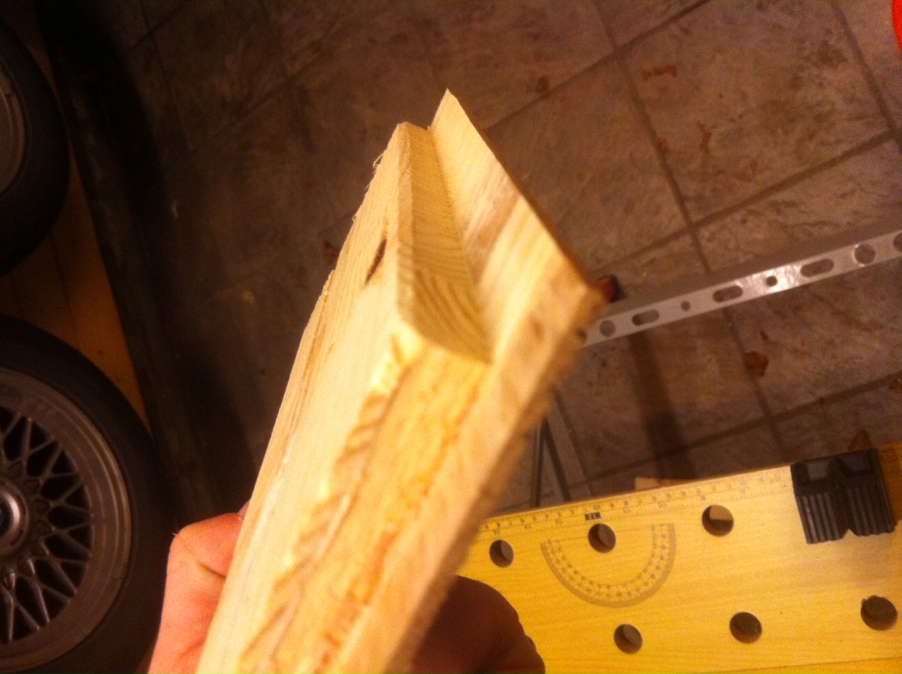

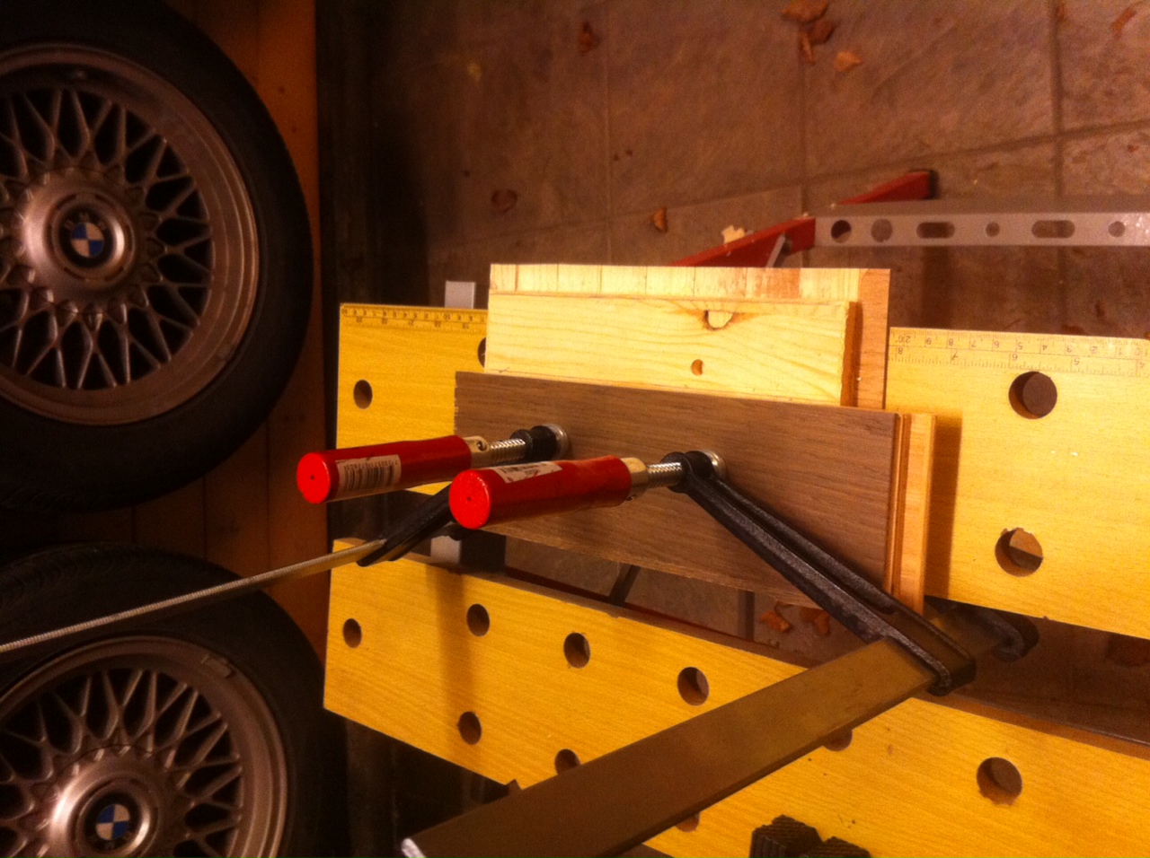

Two days ago I prefabricated the bottom and top plate, however they were slightly oversized in width (2mm or about 1/12") so didnt get to glue them in immideately, Had a quick session in the garage yesterday nite routing it to correct size and also managed to glue them in.
The bottom plate will recieve two more plates to give it thickness + side bracing but as of now top/front/bottom side of the cabinet is closed 🙂 Today I will route the top plate edge flush and then the wire/driver installation can commence 😀

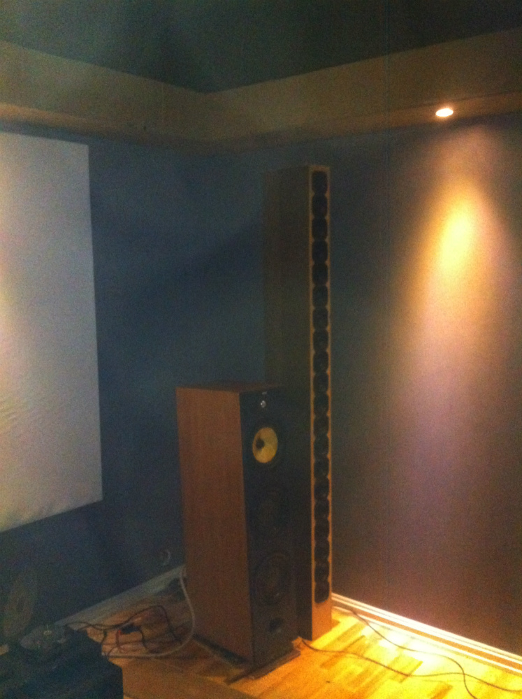

Finished wiring both baffles tonight. Resistance looked good, so I went with a test run BEFORE mounting everything up tomorrow. Good thing I did!
Even though I had already checked all my drivers (or so I thought), one driver didn't work anymore. It was a lot easier to replace it with the baffles off.
So, don't forget to do a test run before you close everything!

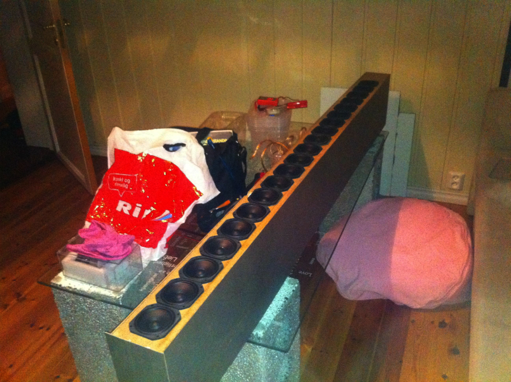

Images from yesterday, apologize for the crappy imagery but I simply havent had time to document it with imagery finesse... Doing 15mins there, 10 here, half hour then etc 😱
Ignore the pink bean bag, I had a young helper on thursday morning (19months old) 🙂
First image show how the 5 groups are wired, I hooked up +/- on the first along with the single wire going to the next. Fed the first driver into its place, hooked up speaker 2 and continued untill the group was done. Then fed a +/- line down to the center of the array. Did this for each group resulting in 5 +/- pairs at the center. These were then connected in parallell and soldered to a single speaker cable.
Before hooking all groups up I measured resistance of each group and did another check when they were all in parallell - all good 🙂
As far as putting music through the array I only had sound on it for five minutes and at low sound levels. Didnt see the point in doing a more extensive "test" as the cabinet isnt sealed or dampened yet. This is for next week as I am away this weekend. I also need to prefabricate the parts for the second array... 😀
