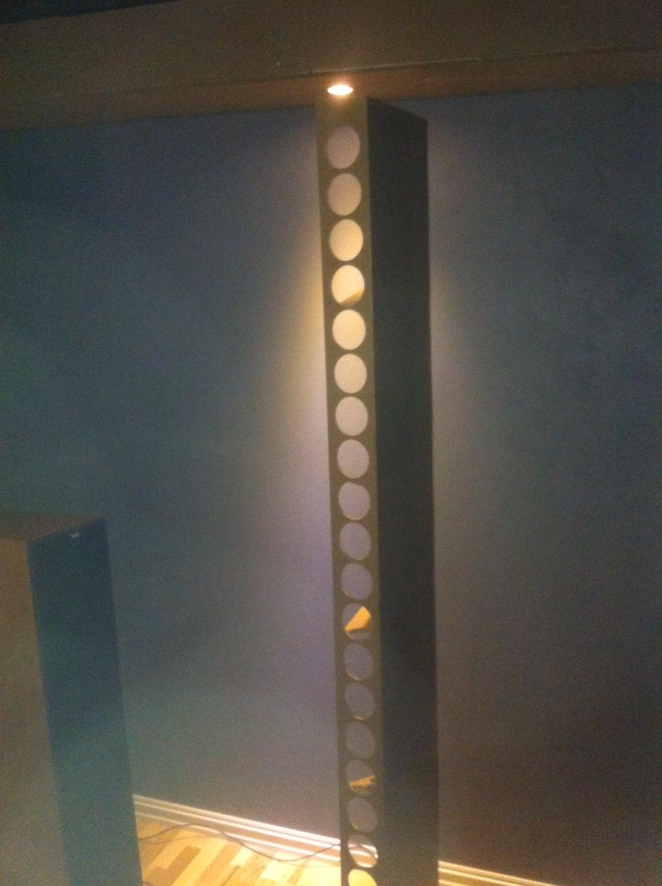

Quick update - before I went to bed last night I got to glue the front baffle to the first side panel 😀
Made sure the side panel was lying true flat, had to weigh down the ends to make it sit right then lined up the front baffle. Used squared supports to make sure the baffle sat right then ran a good bead of glue down the edge before placing the baffle in place.
Checked the glue joint this morning before leaving for work, looks all right and added a bead of construction glue on the inside to properly seal the joint. Not for structural reasons but to get a "smooth" rounded edge 🙂 Tonite I will try to get the internal braces glued up and perhaps also the other side panel. No pics yet though...sorry 😉

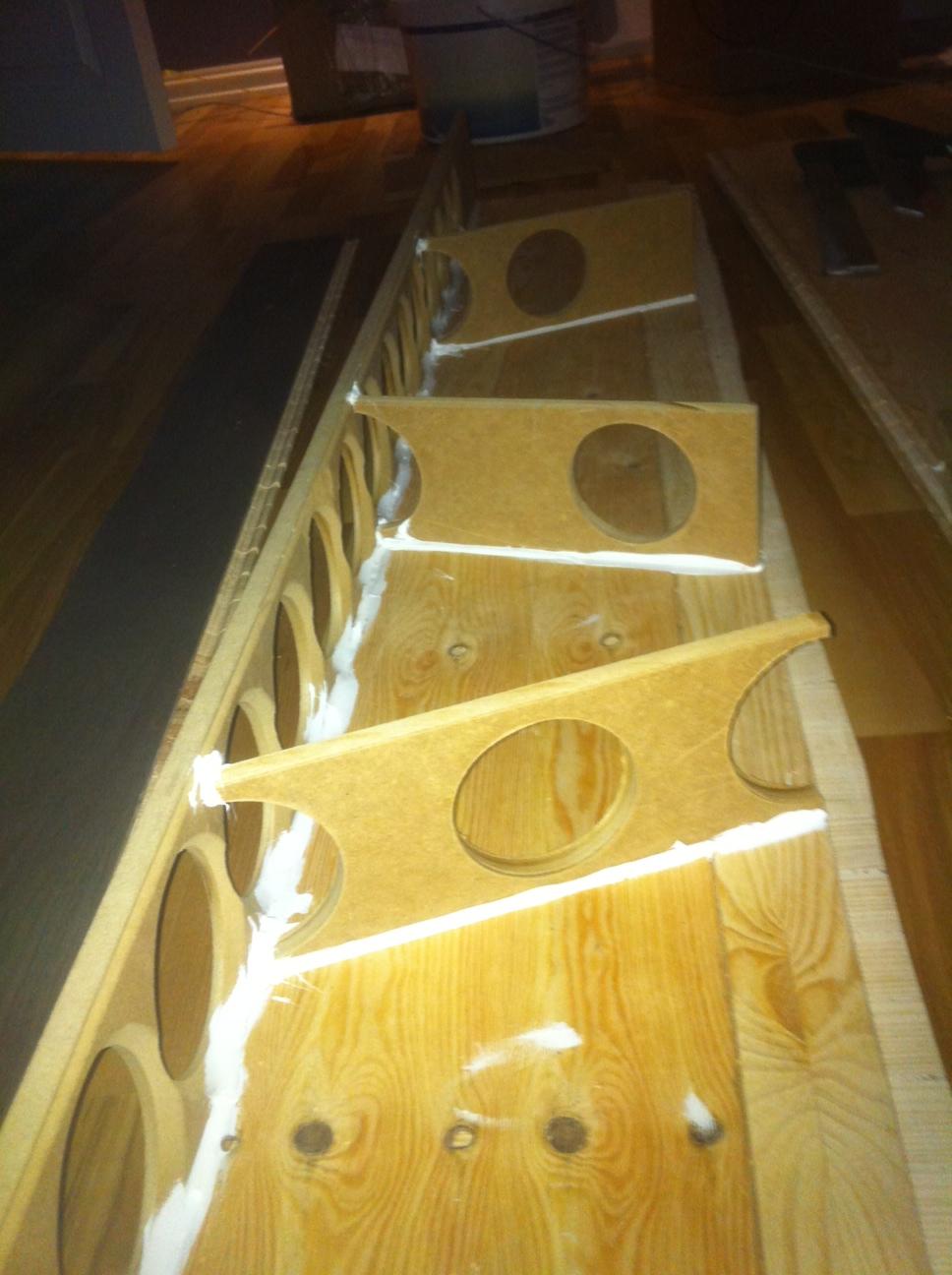

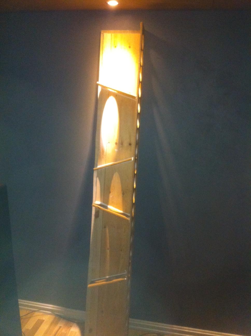

Father-in-law is celebrating his 60th birtday on Saturday and family is flying in so this weekend will be a wash as far as speaker build goes... However I did manage to glue in the internal brackets yesterday and current status is whats shown in the pictures 🙂
The glue joints are solid and the structure feel quite solid as-is 🙂 Very happy with that 😀
1 - Used constructional glue for the brackets and as fillets.
2 - Column standing up 🙂
3 - Still far from sealed 😉 I will add a 5th bracket plus mounting structure for the base. But now atleast I can prepare the other side panel and hopefully be able to glue it in soon...

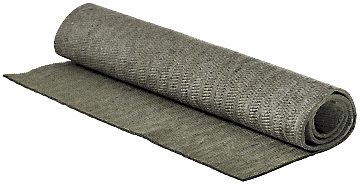

The good news is that I now have both side panels for the first cabinett done and it will be glued tonite. I also found cloth for sound isolation in about 6x3' rolls and 1/4" thick (pic). I intend to line the inside of the cabinet with this using spray glue. I intend to use a fair amount of damping inside and I recall 100g/10l (4oz/gallon roughly) - does this seem right or is my guess as good as yours? 😉
