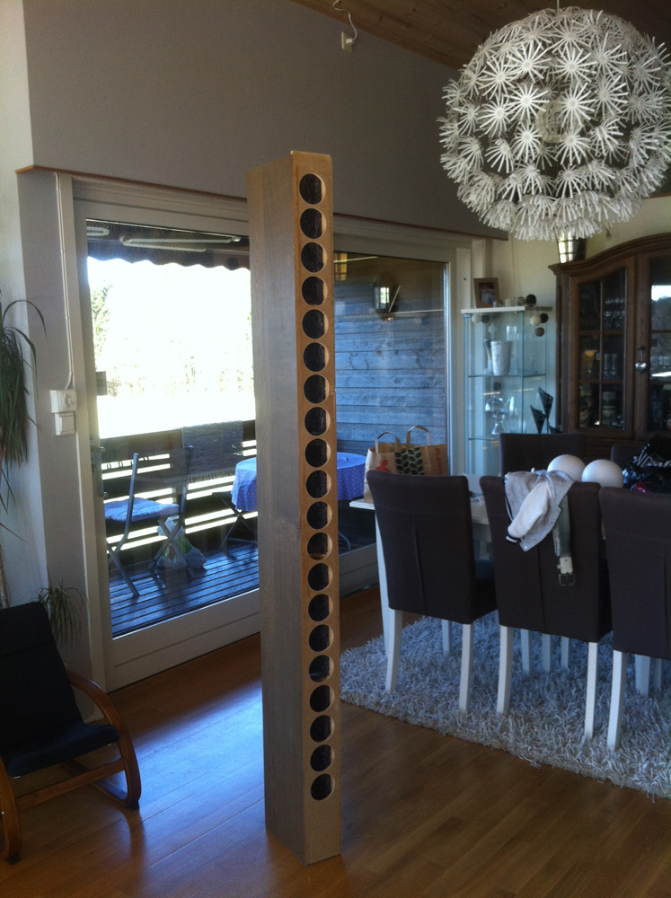

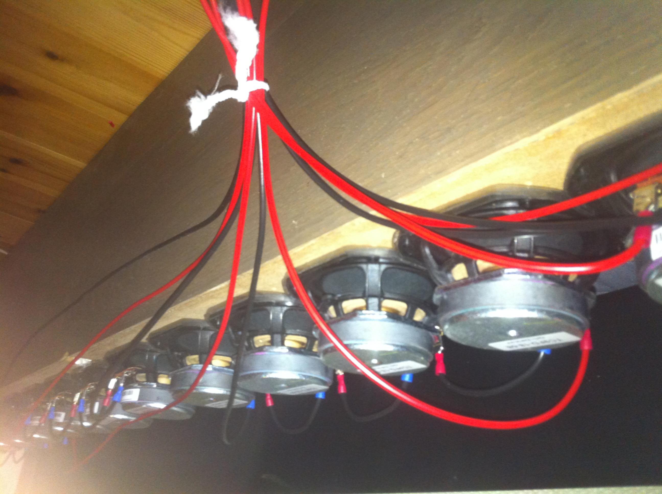

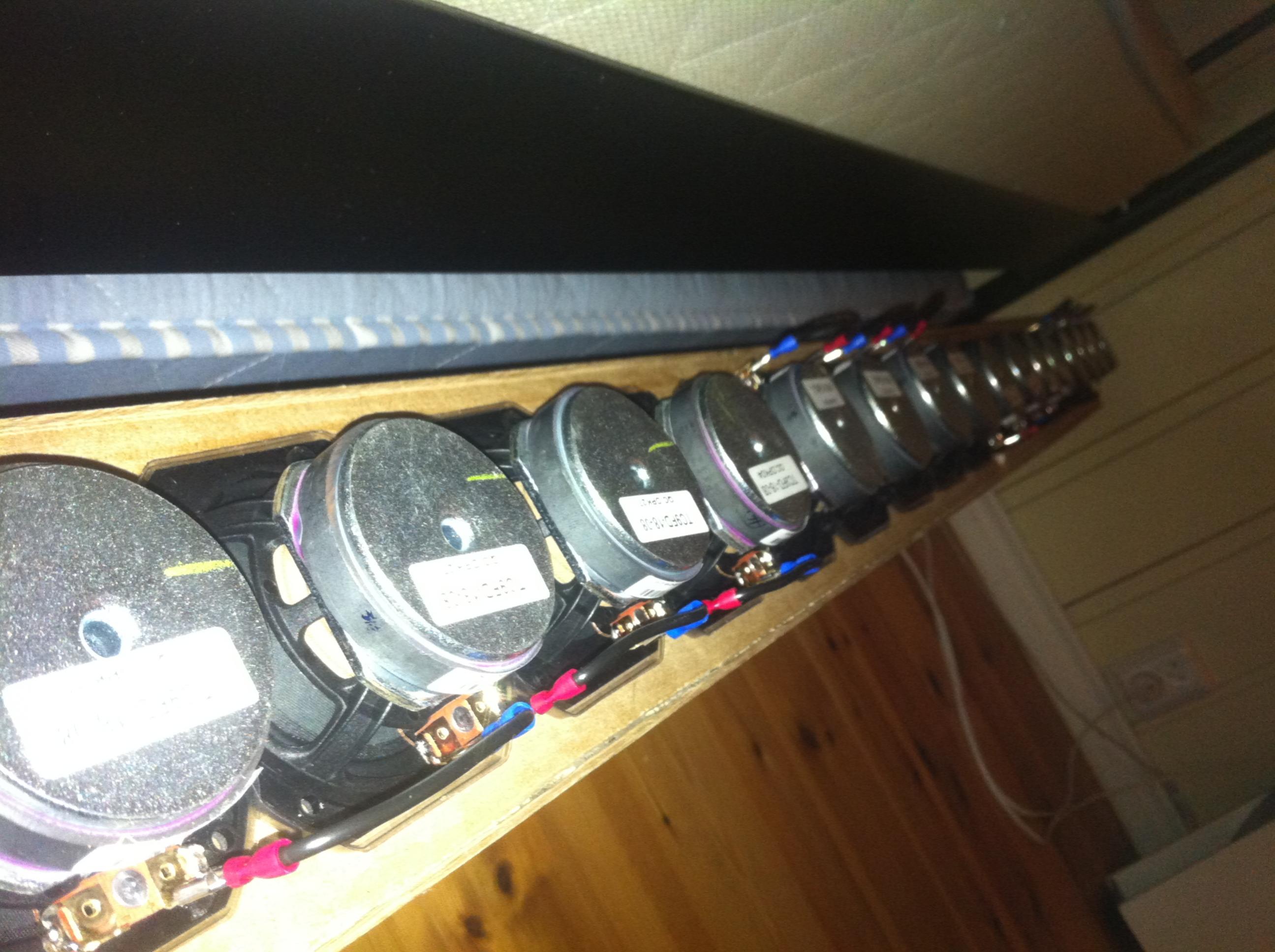

Images shot yesterday, when working against the clock good photo´s is a chore so these are just iPhone-shots 🙂
Inside lined with felt and both sides are now completed. The lip of the side running past the front baffle have been routed flush, however the cheapo router failed me again as the router bit started to shift out of the chuck causing the tracer BB to enter the driver hole = a little chunk of desired material removed.. 😡 You can see this on the right side of the 7th driver hole from the top.

Yeah, the smaller mistakes dont affect SQ anyways 😉
Sayrum, thank you 🙂 The felt is 7-10mm thick. The rear baffle will get two layers and in addition the internal volume will get additional stuffing - hope it will be enough 🙂
