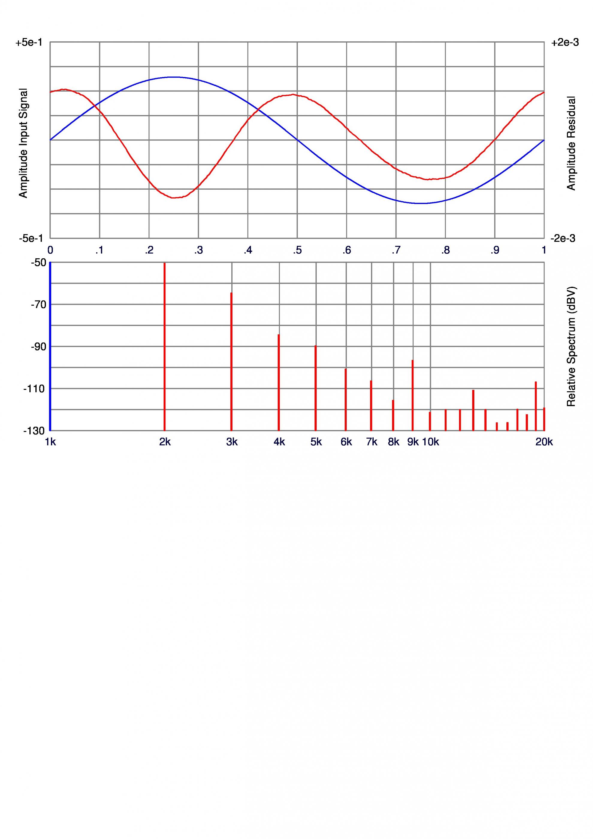

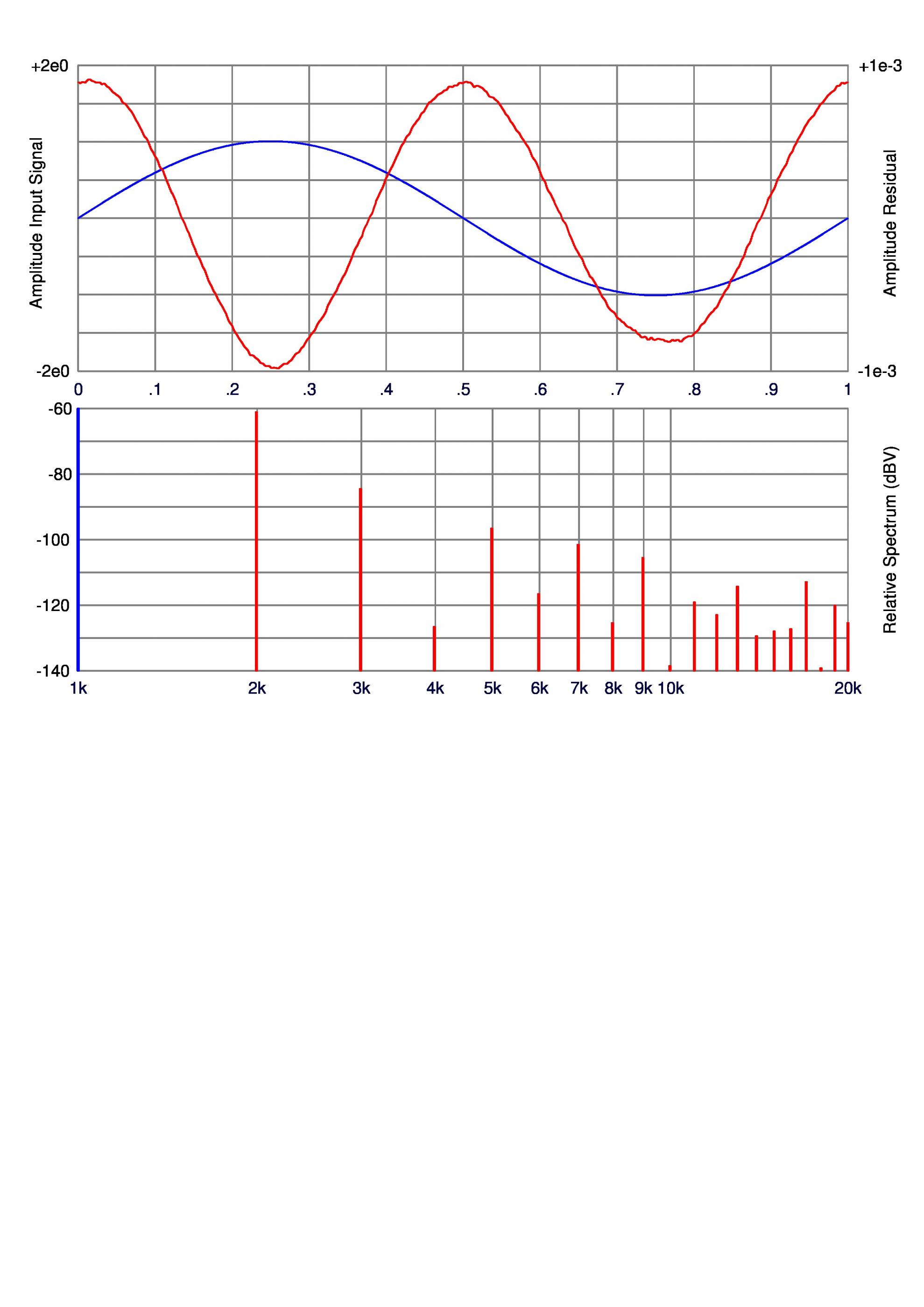

A software that also shows the residual:
DiAna
There are two examples of my latest toy. A DEF amplifier with UJN1208K and IRFP9240. The Vout are 2.55Vrms and 8.29Vrms @ 8Ohm (maximum allowed by the measurement system). I used an EMU1212 with Pete Millett's sound card interface.

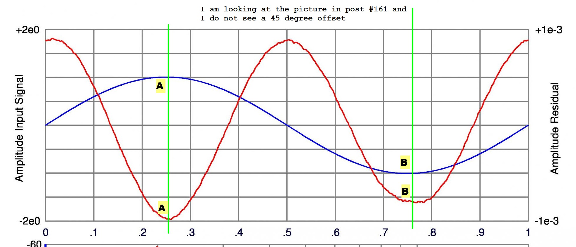

Look at the picture in post #156.This shows neg. phase H2 (lower trace).Look at the fundamental where it crosses the x axis going positive and take that as your reference (0 degrees).Now look directly below that point to the H2 trace.You will see it crosses the x axis ahead ie: + degrees ahead of the fundamental by approx. 90 degrees referenced to the H2 which is +45 degrees referenced to the fundamental.LTSpice shows harmonics referenced to the fundamental,in my sim I use 1khz as the fundamental.So if I see my H2 is +45 degrees that is a perfect neg. phase H2.Nelson explains neg. phase H2 as having a negative peak at the same points along the x axis as the fundamental has its positive and negative peaks.
I am looking at the picture in post #161 and I do not see a 45 degree offset.
No there is a little more than 45 degrees but less than 90 degrees,I said perfect is 45 degrees,its still negative phase H2,there is a range.
When I say 45 degrees is perfect I mean the H2 is 45 degrees referenced to the fundamental which is 90 degrees referenced to H2.

I don't see 45 degrees
Forget about H2's degrees,look at how much advanced H2's positive going zero crossing is ahead of H1's (using H1's x axis degrees),its about 45 degrees.
Forget about H2's degrees,look at how much advanced H2's positive going zero crossing is ahead of H1's (using H1's x axis degrees),its about 45 degrees.LTspice refers its harmonic phase angle measurements to the degrees of the fundamental.

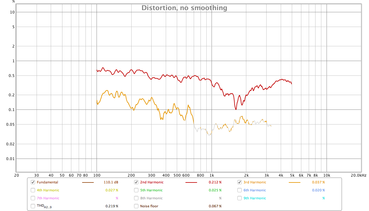

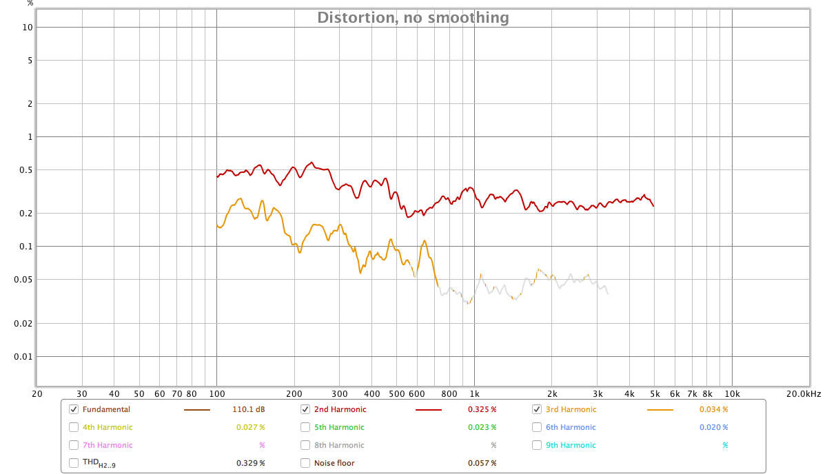

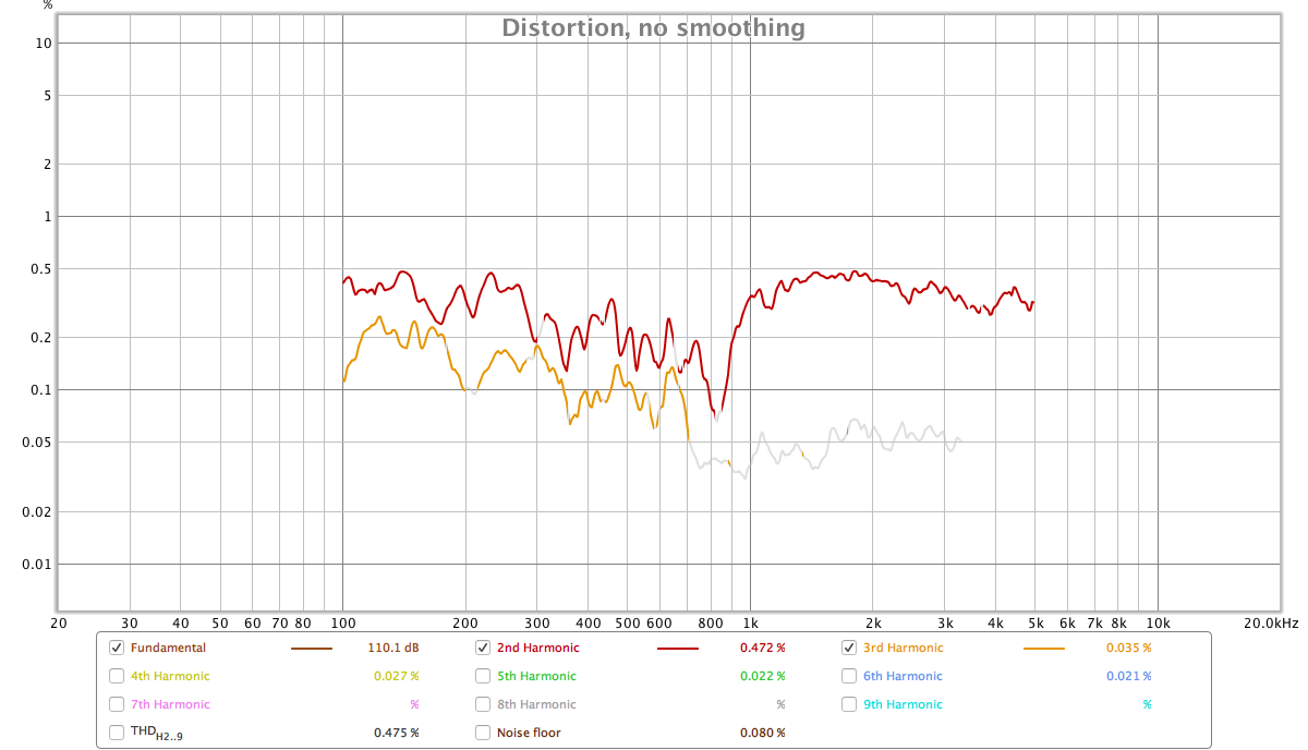

A major part of SET sound signature should be H2, but you may want to limit frequency response as well. Vintage 600:600 line transformer should work well for this.
It would be a good idea to measure H2 of the speaker output. It seems like actual H2 we're hearing is heavily and unpredictably affected by the speaker network design, unit H2, and (possibly) time alignment.
Is this another reason why many SET guys love FR?
Showing plot is 2 way BW3 @810Hz, driven by AJ.
No H2 - positive H2 - Negative H2
