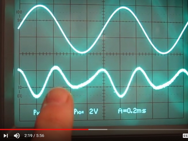

I am talking about the schematic to build a notch filter to transform an oscilloscope into a distortion analyser. It is to display the waveform of the distortion like pass is doing in his writing.
This permits to determine the polarity of H2 etc etc
it is not a spectrum analyser that gives only the intensity of H2 and H3

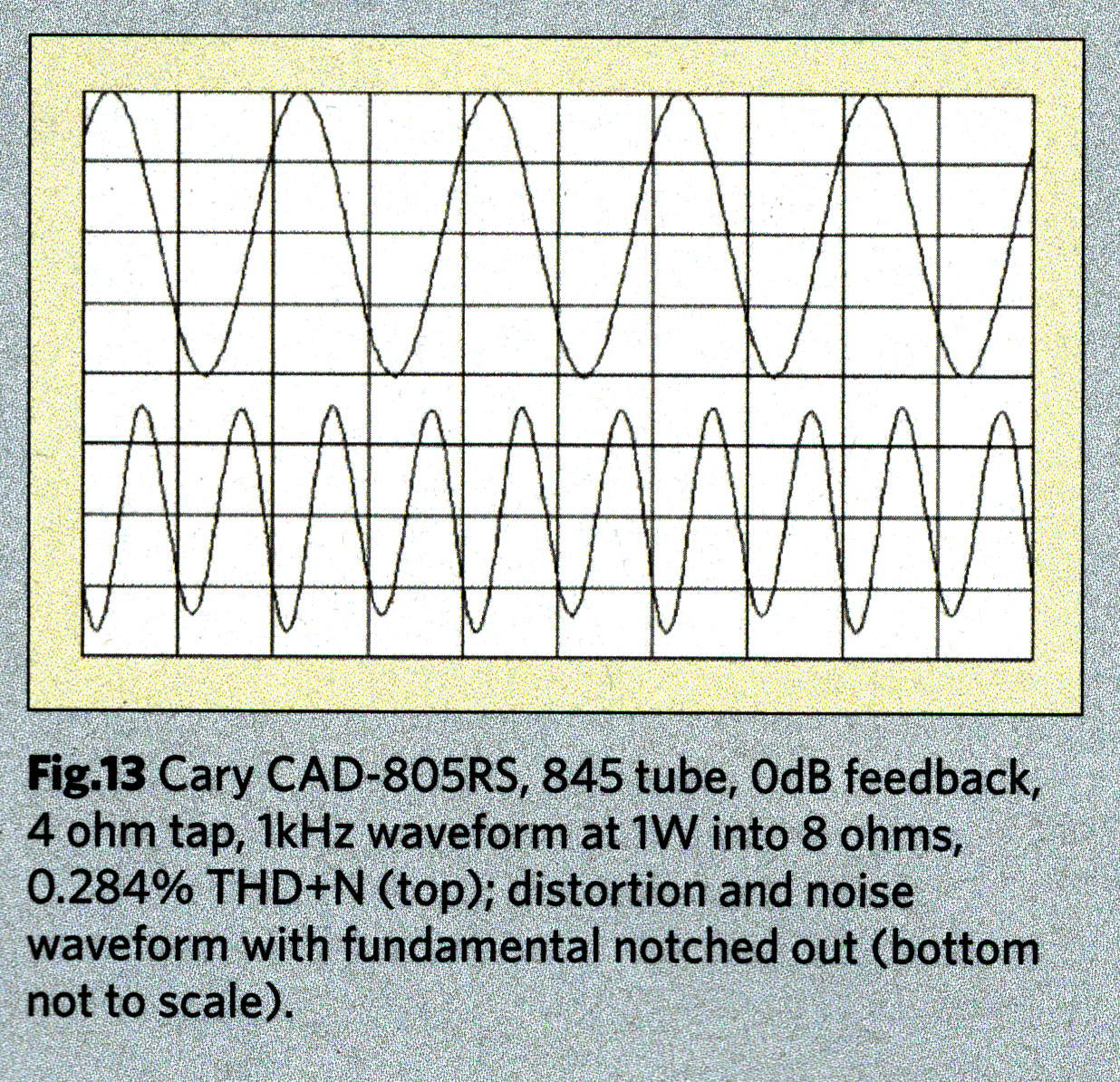

I found this little figure in the Jan 2019 issue of Stereophile. It's part of the measurements section, in a review of a tube power amp.
Anybody want to positively state with confidence and complete certainty, whether this tube amp produces "positive phase" or "negative phase" distortion? And whether the distortion is H1, H2, H3, or something else?
