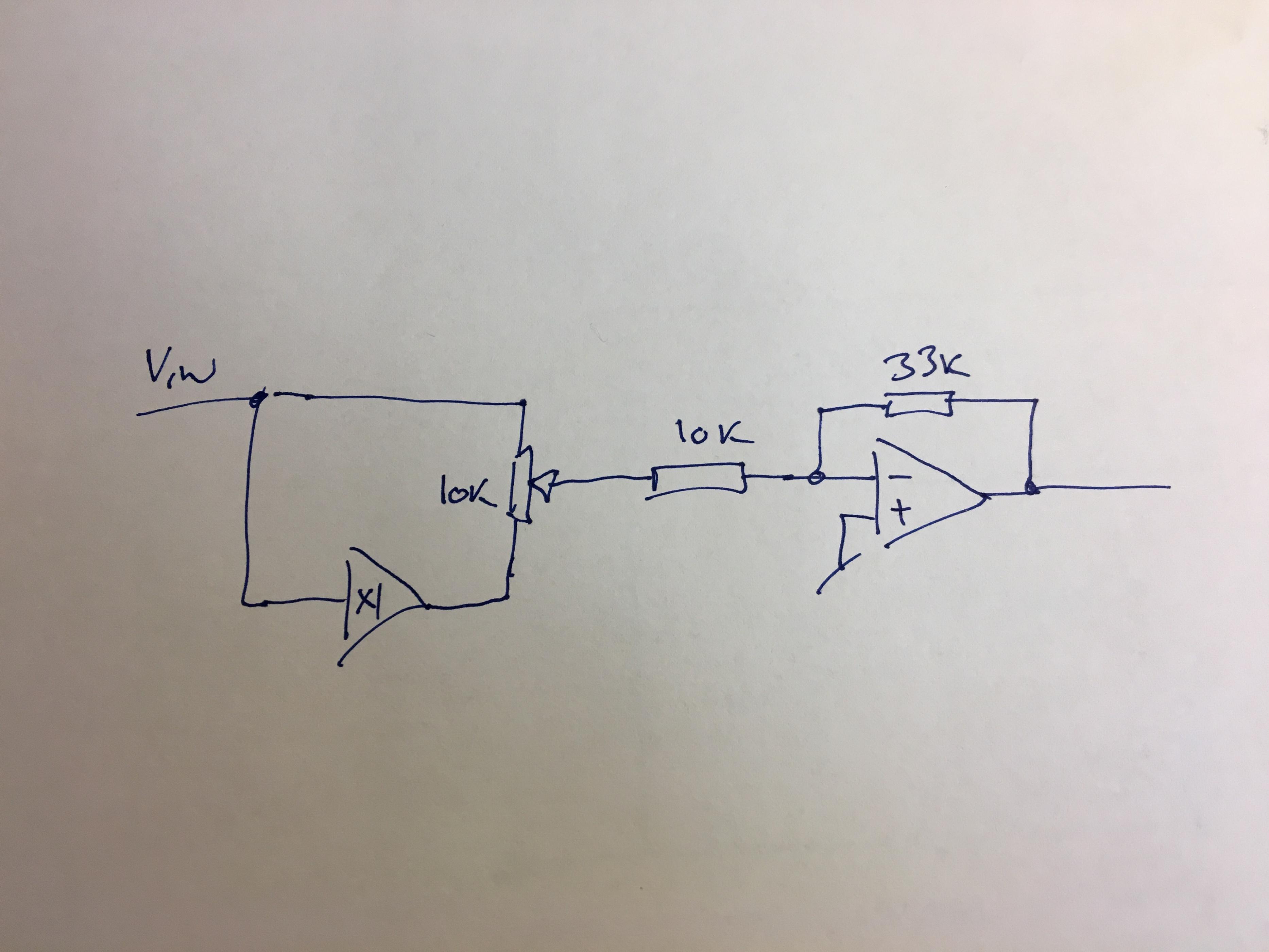

Listening to a H2 inspired circuit ... and I really like it.
I think it brings more spark and room to the music. Only tried it on my small (but quite ok) "PC speakers" .... close range listening.
Have tried to sim all kind of modifications but the simplest is the best of producing the wanted mainly H2 distortion.
Would like to add a second stage to make it into a non inverting unity gain stage ... but keeping the distortion quialities ... any suggestions?

Maybe you would want to consider a circuit where the inverter is
optionally on the input side or output side. Picking one versus the other
allows listening to + phase second harmonic or - phase.

Thinking about making it variable ... see picture.
I need it to front my input circuit of my class d amps of -3x
Guess I could just take the output at the source instead to have a 1x circuit ... with the same properties ...

Sounds like a nice way to avoid switching cables at the speaker.
For those like myself with limited electronics design skills, is there a way to do this with the existing H2 board?
The posted schematic is not enough "Betty Crocker" for me.
Not really. You'll need to add one or two DPDT relays, a switch, two or four transistors, a handful of coupling capacitors, and 1.5 handsfull of resitors to set the gain and to bias the caps.
Using ICs won't reduce parts count dramatically since you still need the relay(s), you still need the coupling caps, and you still need the gain setting resistors.

I was also thinking about this. "The normal mode of operation" as I would call this H2 generator, is the assumption that you have an "ordinary" amplifier, ie not SE, an amp that does not enhance second harmonic and that does not invert phase (most commercial amps). In that case, by adding H2 circuit, you would introduce a small amount of positively-phased second harmonic, but since it is inverting, you would have to invert speaker connections at the output of am amp, in order to "bring back the overall phase". But, by doing this, you would invert the phase of the second harmonic, which would now become nagative, as is the intention of the circuit.
The problem arises if your amplifier already inverts the phase (Zen amp for example). By adding H2 circuit, you make one more inversion at the input, so now you have to reverse your speaker connection, in order to get "the right phase". But, in this case, you will get positive second harmonic, both from H2 and the Zen amp, and your result may not be as expected.
Hence, for such cases, it is necessary to "invert the phase once again". That also applies if you don't want to invert speaker connections in case of an "ordinary amp".
So, the simplest thingvwould be to build an opamp based phase reverser, which is basically an opamp which input goes to - input, with 100% feedback. It't easy to do, I've seen such circuit on some "subwoofer phase switches". On the other side, I don't know what (negative) efect can an additional opamp with 100% feedback have on the sound, so maybe we want a different solution.
Sorry if all of this sounds confusing, but it is actually very simple. Remember, the aim is to get the right overall phase at the speaker, while adding a small amount of negatively-phased second harmonic.
I am saying this because I have seen the tube buffers added on front of amps that do not invert phase. The result of this is the addition of positively-phased second order harmonic, but we want it negative.
Now if what I said is confusing enough, maybe Nelson can draw a simple schematic 😀 😎
