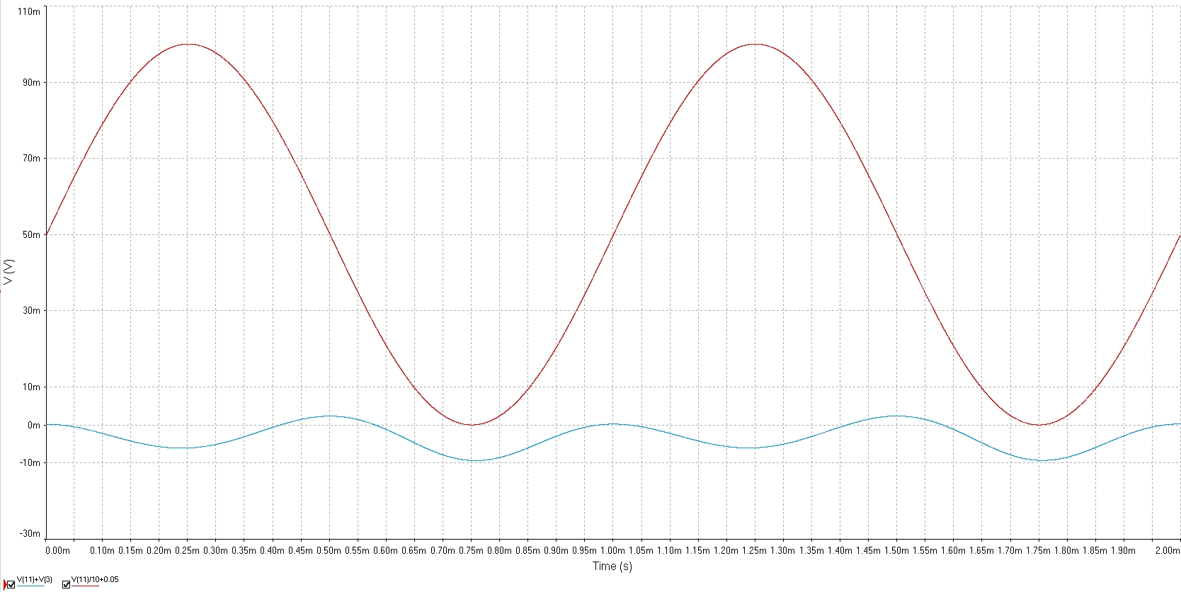

This is my very humble position: analyzing only the signal amplification stage, we have two design philosophies. One of them is where the signal should be preserved as similar to the original and that the discrepancies with the original fall below the thresholds of perception according to the level involved in each particular case. For this design philosophy the guidelines to reach the objective are widely known and it is only a matter of following them (it could be a bit boring for the designer, since there is no place for personal imprints).
The other design philosophy is based on adding or removing certain qualities of the original signal to try to cause a certain perception in the listener, through and in conjunction with the transducers and the surrounding environment. This is where I believe that it will always fail in the attempt, since the universality of parameters to keep in mind to achieve the objective is infinitely broad and, even, based on the opinion of a finite sample of listeners, that sample is never enough to finish gestating a product that everyone likes. Just to give an example, the opinions of the sample of people that we try to take as valid for the development of our system can have a validity only temporary and even dependent on the mood of the moment of those same people. Fashion or tendency in the acceptance of these altered qualities could influence, but it could also happen that after a certain period, the same qualities lose acceptance due to the appearance of new trends or fashions. While this philosophy has its entertaining side for the designer, it can entail serious fustrations as well.
I have always wondered if these intentional subtleties in sound would not be largely masked by the single variation of the temperature of the surrounding air inside the chassis where the amplifier circuit itself is housed. I have seen amplifiers of all kinds, but none with controlled temperature of the interior and exterior atmosphere. It is a fact to be able to find differences of ambient temperatures of up to 30 ° C. That is a difference that markedly alters all the points of the circuit.
And continuing with the simulation of my circuit, I have obtained something very similar to the one proposed by Nelson Pass:
There is a paradox with the temperature: if we intend to keep the Tj of the component constant to maintain a certain quality parameter unchanged, we must control the temperature of the surrounding air and keep the dissipation of the component in question constant. With a variable signal crossing it, is it easy to implement it in the short and long term, given the typical inertia of the scenario?
The ACA (it inverts) has a negative 2nd harmonic phase, I verified it. When I hooked up the H2 as a preamp, the 2nd harmonic phase goes positive as (I think) Nelson predicted. The ACA has feedback and over most of it's range THD <1%. What happens if you use a P channel JFET and a negative rail to make the H2 ???
That depends on where you operate it on the load line. Adjustment of
supply voltage on the H2 will give you either phase, and this works as
well with a P channel part.
