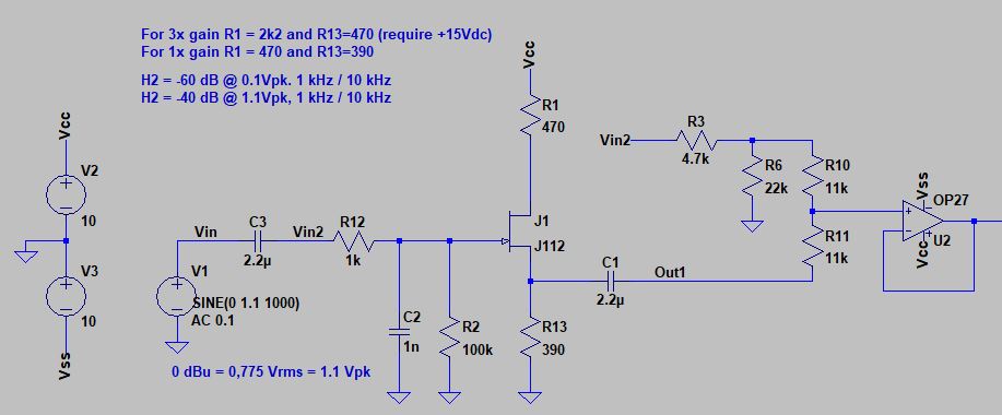

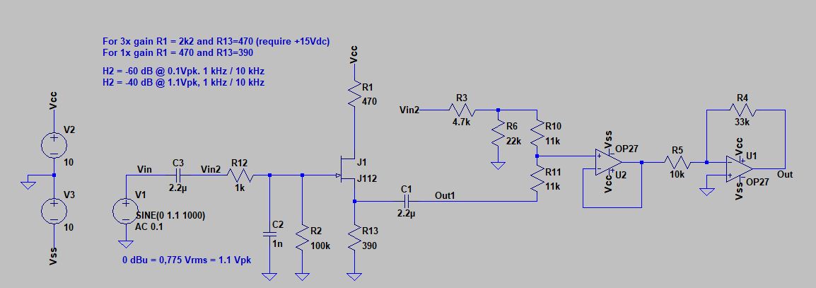

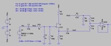

This sims ok.
You can leave out the buffer, if you are ok with the volume being lower in the mid position and in either end position. The following inverting amp can also be omitted if you just vant the unity gain
R10 and R11 is the potentiometer here set in mid position (22k lin pot)
This sims ok.

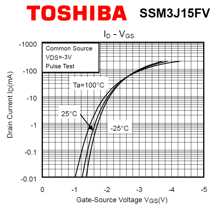

is there a combination of jfet type (j111, j310 etc), bias and supply voltage that could give the same harmonic signature but with more output level? 4V instead if 1.5V
this would avoid me to put an extra preamp stage to drive a low gain amplifier
Finding out the answer will require a LOT of lab experiments using a distortion tester and a bunch of other equipment. However I think that if you decide to try it, you will have a lot of fun and expand your knowledge considerably.

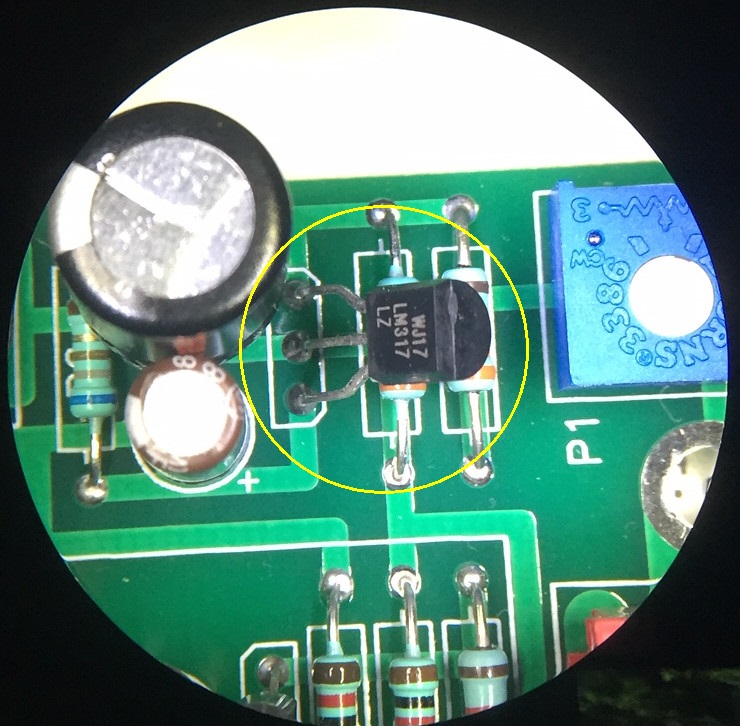

Thanks, Mark. See my follow-up questions in maroon below...
Maybe the pronoun "it" might be the source of your confusion (2nd red box in attached H2 manual below)? To what does "it" refer?
"It" is the voltage regulator (1st red box in attached H2 manual).

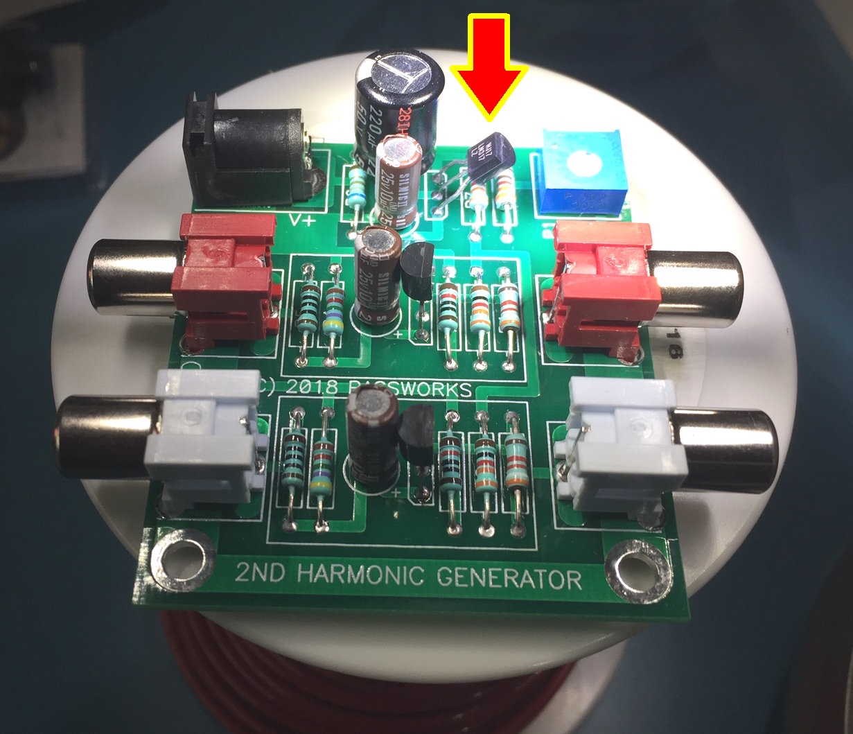

I see the "it" as well as the P1 adjustment pot on which I made hash marks to denote Nelson's setpoint.
However, I do not see the 317 regulator position marked either on the actual board or the Red/Green PC board rendering in the manual.
Which component on the board is the regulator? The tall black cylinder next to P1?

Bear with me here...
When I google LM317, I get something like the figure below which shows the regulator as having 3 legs and a tab with hole at the top.
I DO not see any components like this on the H2 board. I DO see 3 half cylinders with 3 legs but NO tab at the top. The one closest to the P1 pot has its curved surface facing the pot. I am guessing the round vs flat surfaces determine the pin assignment?!

I am so brave, that I dare to bend the pins on one of the components! And then snap a photograph. Look on my works, ye mighty, and despair. (P. B. Shelley)
_
Thanks for bending over backwards 🙂 to help me out!
NOW since there is no tab at the top as with the LM317 shown in my pic, how are the pins ID'd from left to right...or from top to bottom in your right-hand photo?
The package is called TO92.
Here is a link to the data sheet.
See page 3.
http://www.ti.com/lit/ds/symlink/lm317l-n.pdf

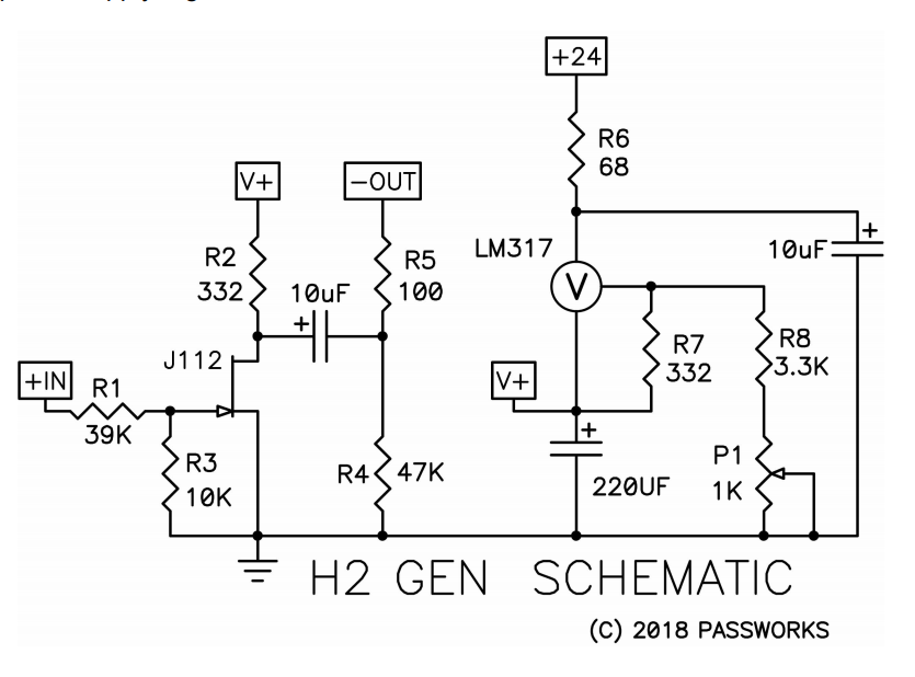

I see that such a simple circuit still causes a lot of confusion.
I will try to explain the way I understood it,someone else may correct me if I am wrong:
1. This circuit, as is, is a common-source little preamp with the attenuation on the imput, with the aim of not providing net gain (ecen though there is signal gain-it is inherent in the design)
2. As such, it always flips the phase of the signal, and it generates second harmonic which is always in positve phase.
3. But, since the circuit inverts the overall phase, in order to get it back you have to do one more inversion. Assuming tha your power amp is non-inverting, the simplest thing is to reverse the speaker cables. By doing this, you have your overall phase "back to normal", but the second harmonic that was generated by a H2, which is positive, is now flipped, and looks as negative.
Easy, isnt't it? 🙂
By the simple change of voltage you can change the amout of second harmonic distortion. Do do confuse this with phase change. Phase can be changed at the speaker terminal, ir by addition of another line level circuit that flips the phase and ideally does not introduce distortion (it could be a j-fet, mosfet, IC and maybe a transformer). I hope Nelson can provide us with a nice solution (transformer+buffer).
Regarding the voltage meter, once we know the useful range of voltages, we could build an analogue meter. I would call it "sweetness" meter 😎
