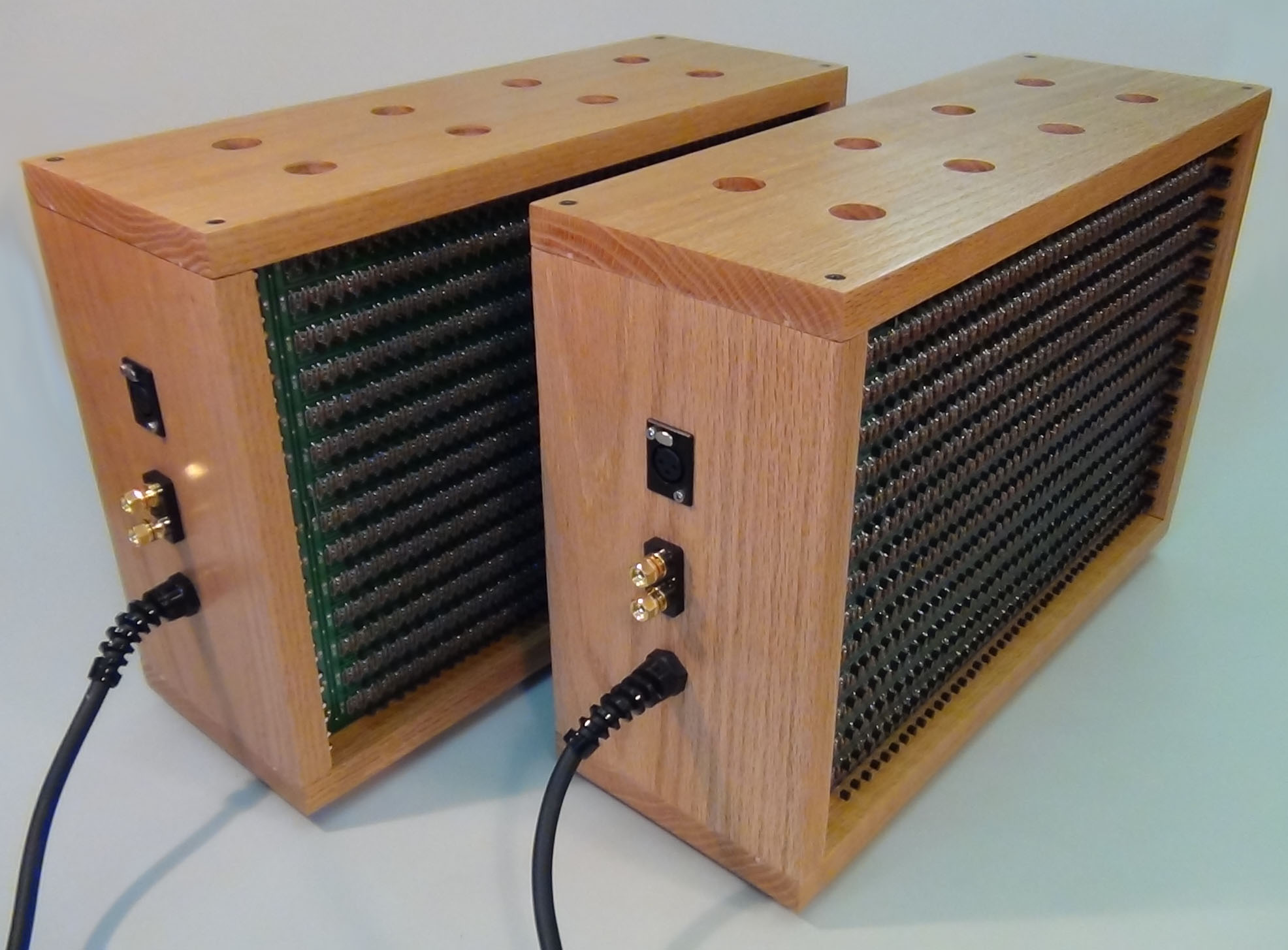

My guilty pleasure amplifiers are the Beast With 1,000 JFETs.
