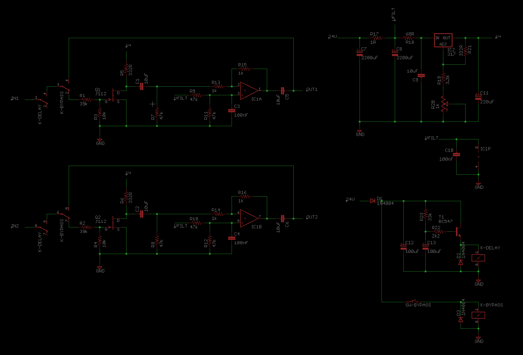

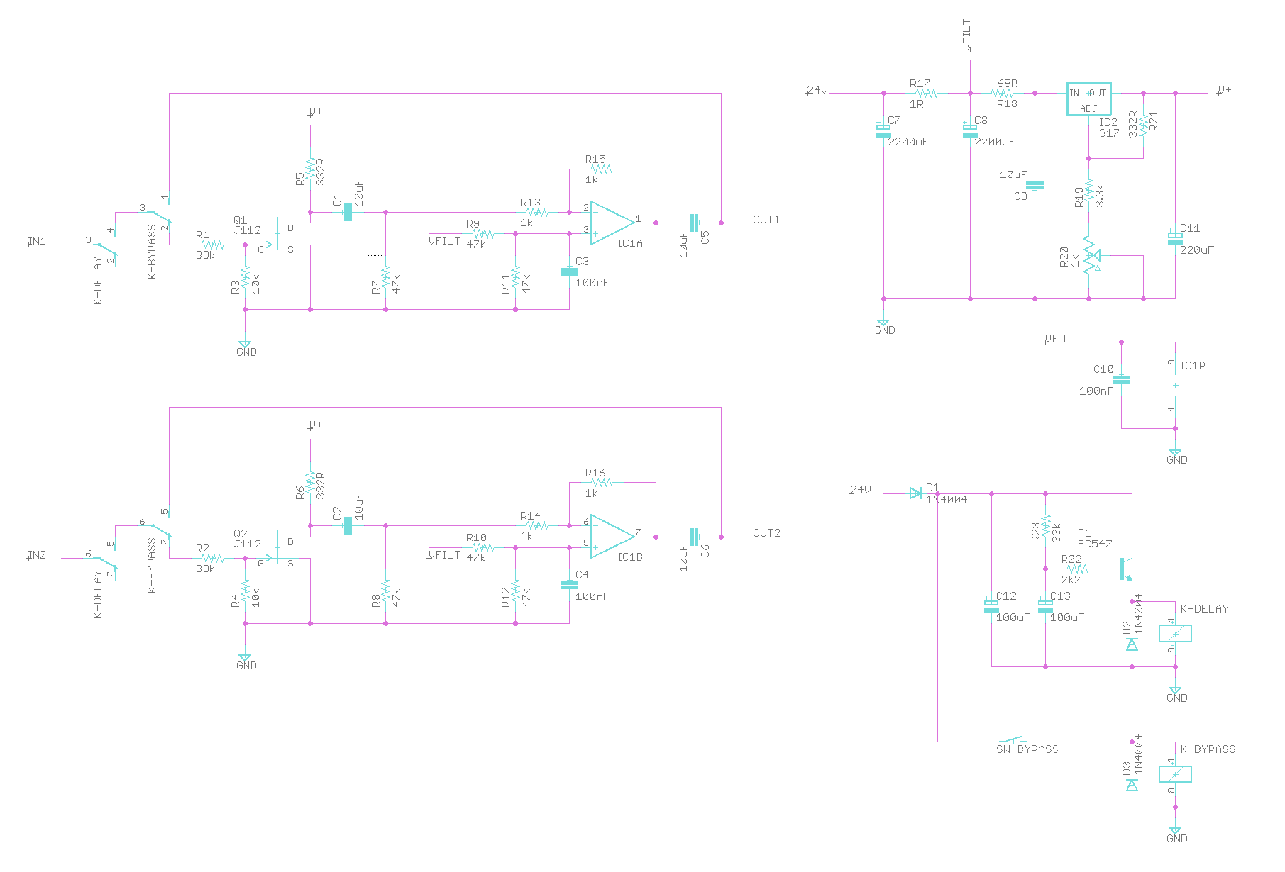

Sanity check
I've put together a circuit incorporating Mr Pass's H2 generator followed by an inverting stage plus delay and bypass relays.
I stayed with the lone 24V input, so the op amp is running in single supply configuration.
How does this look? Any dumb mistakes?
Feel free to suggest changes . Once it's solid I'll post the gerbers here.
Hi, I worry that in "bypass" mode you might have a deadly fight because the input to your box is shorted to the output of your box. If the input is from your phono preamp then it's fighting against the output pin of opamp U1.
Also you might prefer to connect R7 to (VFILT / 2) instead of to ground.
Inverse color palette (white blackground) image attached
Thank you for the input Mark
Okay, I'll add a relay for the output as well.
Would a simple resistor divider do the job?
Duh, wait, I just realised what you meant . Ignore the last part of my previous post.
