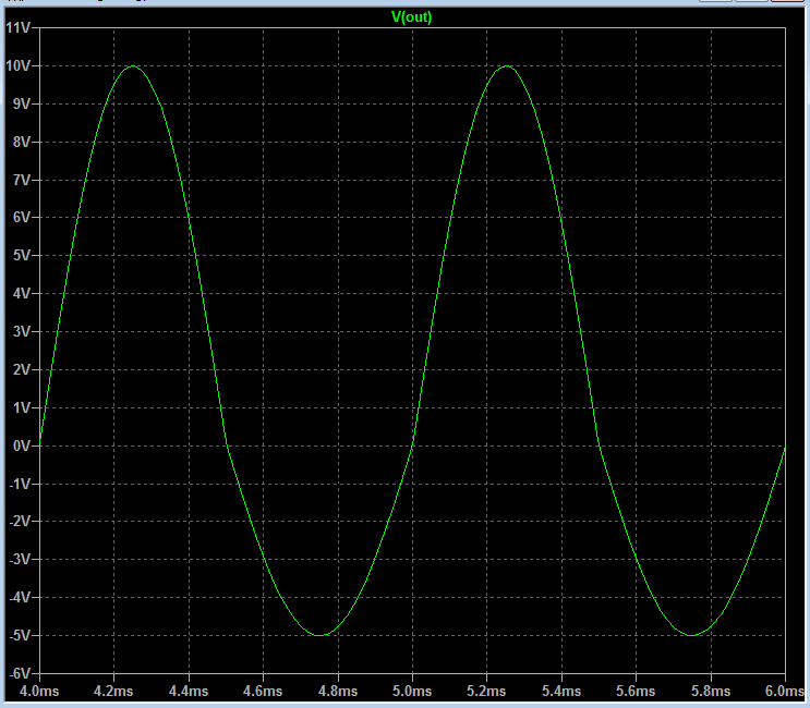

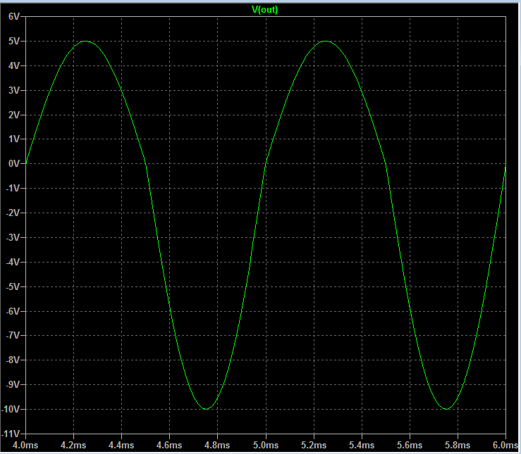

As Nelson addresses in his H2 paper, the residual distortion waveform of the H2 product can be either positvely or negatively phased, relative to the fundamental waveform. I'm wondering how to predict such relative phase between the fundamental and H2 residual from only the amplifier's schematic. In other words, before building and measuring the working circuit.
Ken, if you remember how to calculate Fourier series from school, it's a pretty straightforward exercise.
Just define "waveform 1" as (sinewave of amplitude 10 on the positive half cycle) plus (sinewave of amplitude 5 on the negative half cycle). Calculate its Fourier series.
Then define "waveform 2" as the inverse: (sinewave of amplitude 5 on the positive half cycle) plus (sinewave of amplitude 10 on the negative half cycle). Calculate its Fourier series.
Waveform1 is the output of a circuit whose puller upper gain is 2X greater than its puller downer gain.
Waveform2 is the output of a circuit whose puller downer gain is 2X greater than its puller upper gain.
Because they are (wildly!) asymmetric, waveforms 1 and 2 will have a lot of 2nd harmonic distortion "H2". One of them will be positive phase H2, the other will be negative phase H2. Fourier series will tell you which is which.
Then you can open up to a brand new page in your engineering notebook and write:
HOW TO GENERATE NEGATIVE PHASE H2:
Design a circuit whose puller upper gain is (GREATER, SMALLER) than its puller downer gain.
{Circle either the word GREATER or the word SMALLER according to your Fourier results}.
Here's an illustrative example. I created two waveforms in the LTSPICE circuit simulator. One of them has 2X greater amplitude on the positive half cycle, the other has 2X greater amplitude on the negative half cycle. Then I told LTSPICE to calculate the Fourier decomposition of those two waveforms. The results are clear: one of them ("FOXTROT") has positive phase H2, see blue box. The other of them ("GOLF") has negative phase H2, see green box. Which is which? I won't say. I don't want to rob you of the joy of discovery. Do the calculations, have some fun, and reap the rewards of diligent effort!

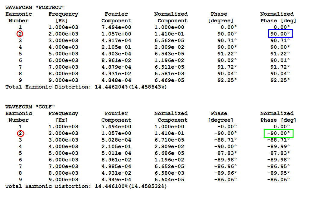

I have a question.In the LTSpice distortion readings is the phase of the second harmonic referred to the first harmonic? ie: Does 90 degrees 2nd harmonic phase mean that it starts at the 90 degree point of the 1st harmonic?
The quickest way to find out is to make a little simulation circuit which sums a 1kHz ideal sinewave voltage source with a 2kHz ideal sinewave voltage source. Then run LTSPICE .FOURIER analysis on the summation. When the two ideal sources are displaced by +60 degrees (according to your definition), what does LTSPICE call that? +60 degrees? -60 degrees? Or some other number?
Thanks for the tip. +90 degrees 2nd harmonic is perfect -ve phase second harmonic according to Spice. The degrees are referenced to the harmonic ie: 2nd at +90 degrees=1st harmonic at +45 degrees.
I should clarify one thing.My reference to the 1st harmonic at +45 degrees does not mean is was at +45 degrees while the 2nd was at +90 degrees in the spice log.The 1st was at 0 degrees.I just meant that 45 degrees 1st equals 90 degrees second time wise.

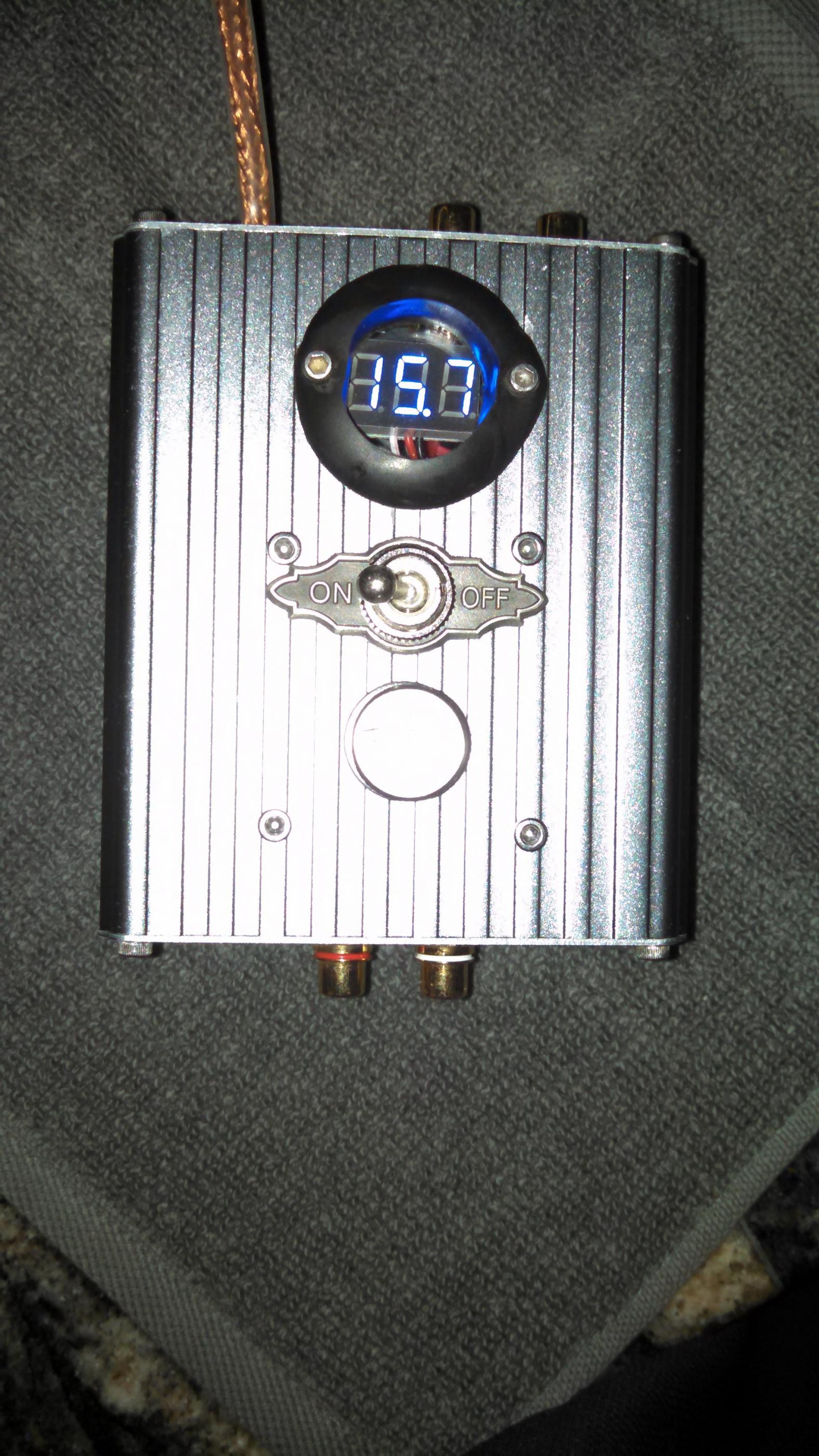

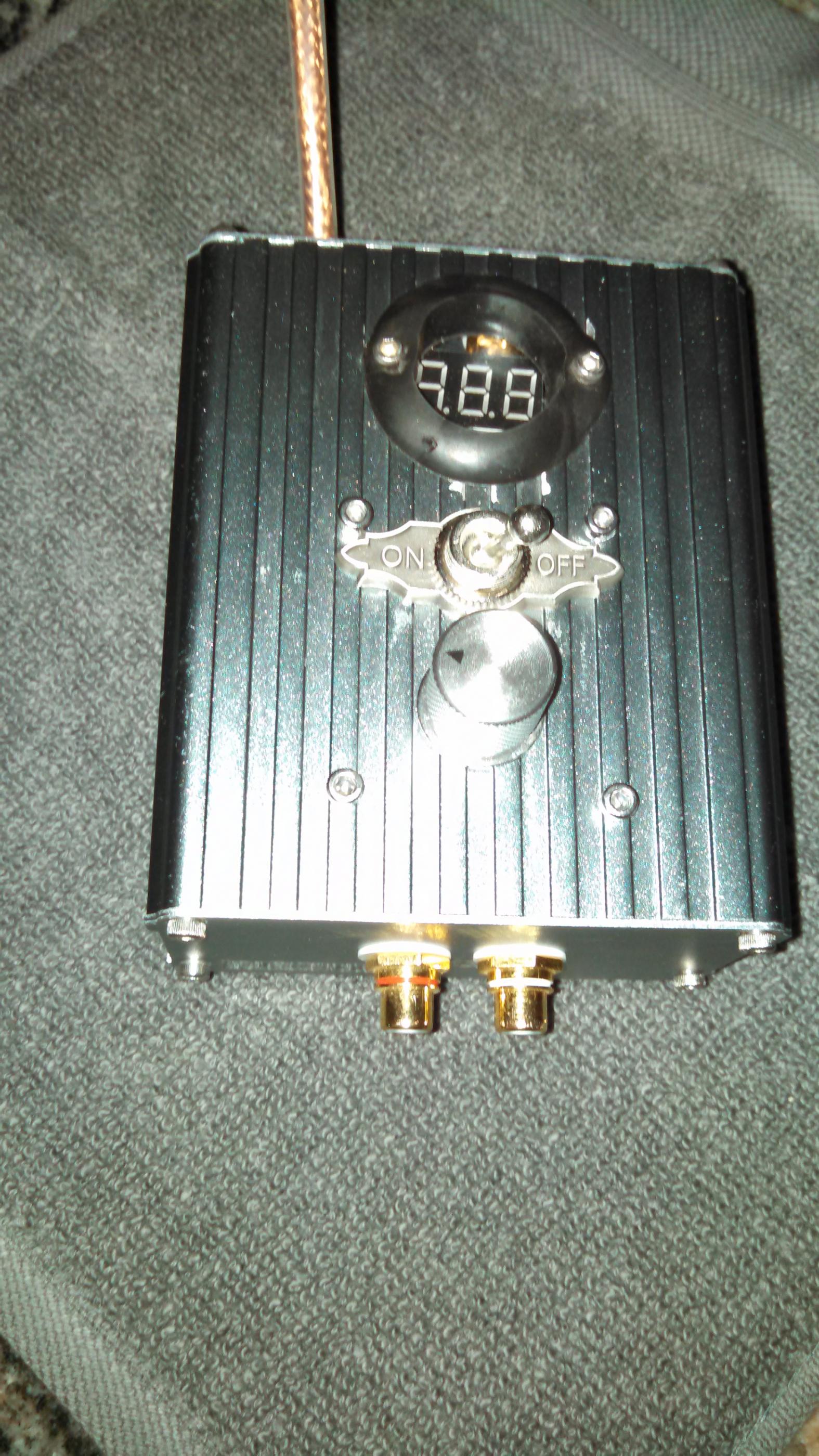

I started by replacing the board mounted RCA jacks with chassis mount jacks. I also hard wired the wall wart power supply.
My build started out pretty vanilla but as it progressed I decided to go steampunk. I added a meter powered by 9V Lithium (since powering with the internal supply resulted in noise), then I put in a switch for the meter, and finally a pot so that I can experiment with +/- voltage settings all without needing to "pop the hood". I fabricated a couple short RCA interconnects to go from my preamp to the H2.

Hello Big Guy.
Thank you for explaining and showing your H2 build. The external digital VM and the tuning pot are an enhancement [as you said above] for facile experimentation. I hope that your experiments will cover both negative and positive phase as the sole variables. I look forward to your upcoming impressions.
Thanks for your advice to acquire an H2. H2 is valuable. I'll PM Mr. Pass.
N.B. I do not have access to PM Mr. Pass.
Mr. Pass: I'd love to acquire an H2. Thanks.
