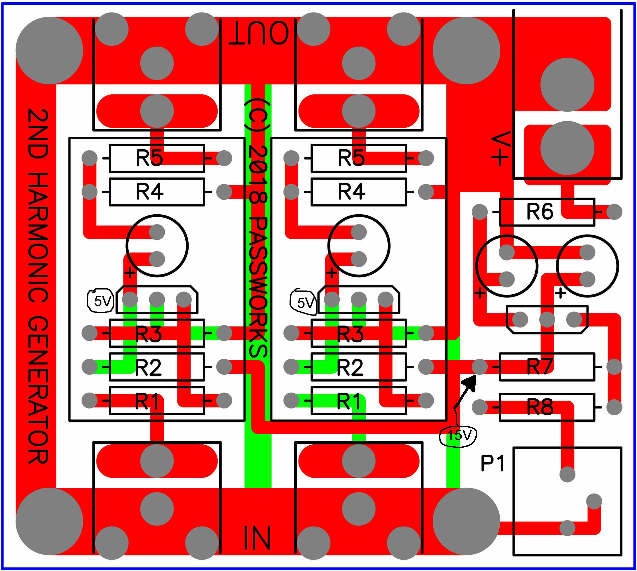

Attached is the art from the pcb. I have labeled 3 points where you
should measure approximately 5, 5, and 15 volts respectively.
From the left, measured 5.44V 5.48V 15.65V (same as noted on pcb)
By the way, have you tried removing the LED readout?
At your prompt I did remove the LED meter and whine went away which is great.
Having said that, my intent was to have the meter be a built-in indicator of both power ON and a reading of the (adjustable) output voltage so would have a way to reset to original value without messing with meter. Is there a way to wire into the circuit to fulfill my goal without creating the whine?
I think I wired it properly with RED/WHITE to center pin of regulator and BLACK to ground. Hopefully this is correct?!

The meter is a digital instrument with digital noise, and is drawing power from
your supply. Probably you want a voltmeter with a separate power supply,
or maybe a passive meter.
In light of resolving whine issue by removing the LED meter from the H2 circuit, tried a couple of things...
(1) Powering the meter with the wall wart rather than the Vout of the regulator = NO NOISE 🙂
(2) Powering the meter with a 9V battery = NO NOISE 😀
Will include an ON/OFF switch while I am at it.
On to listening 😎
