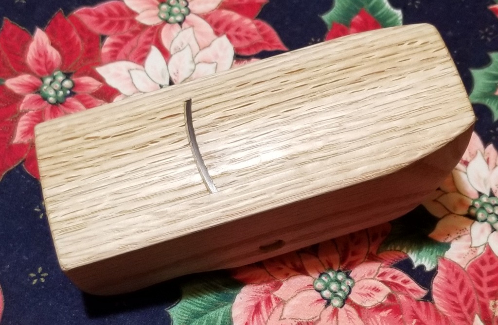

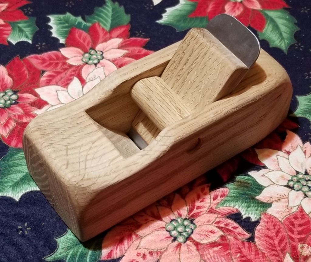

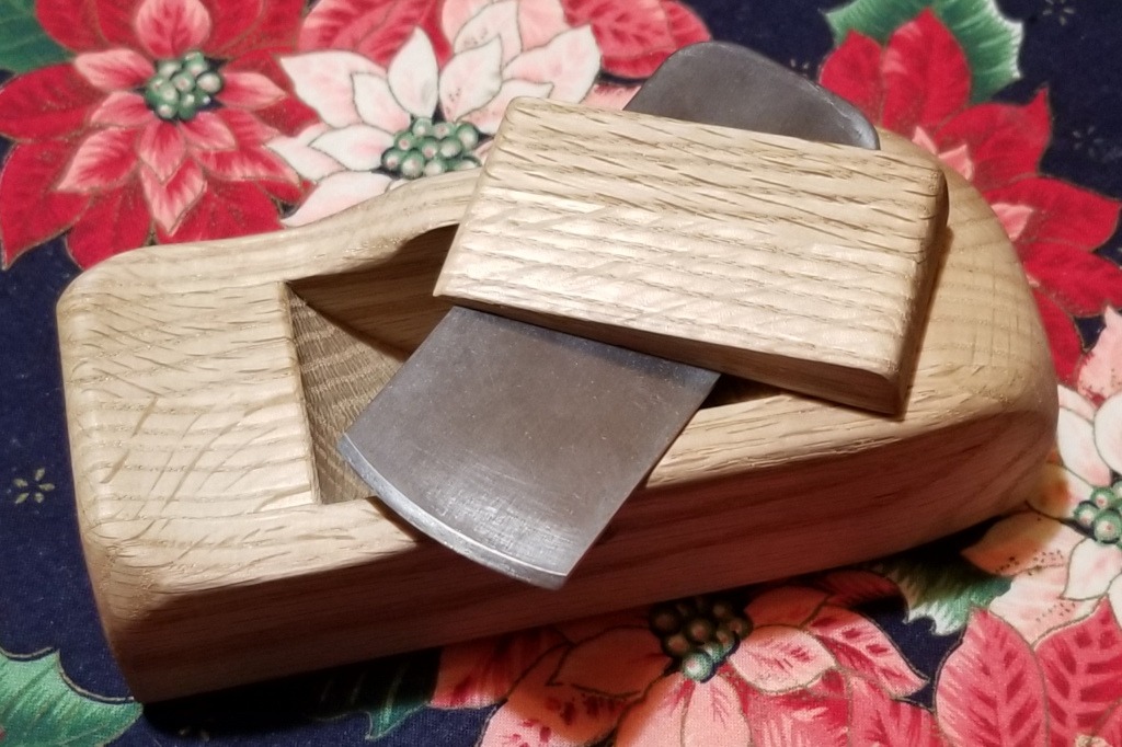

The most recent thing I've done is build a simple Krenov-style hollowing plane that I'll use to shape the inside of the tub staves. I made the plane iron (blade) out of a piece of an old circular saw blade and heat treated it myself using a simple box-of-dirt charcoal forge that I put together some time ago. Even though the iron is very thin (0.05in or 1.27mm), it actually cuts quite well with no chatter at all. Photos attached.

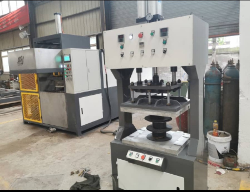

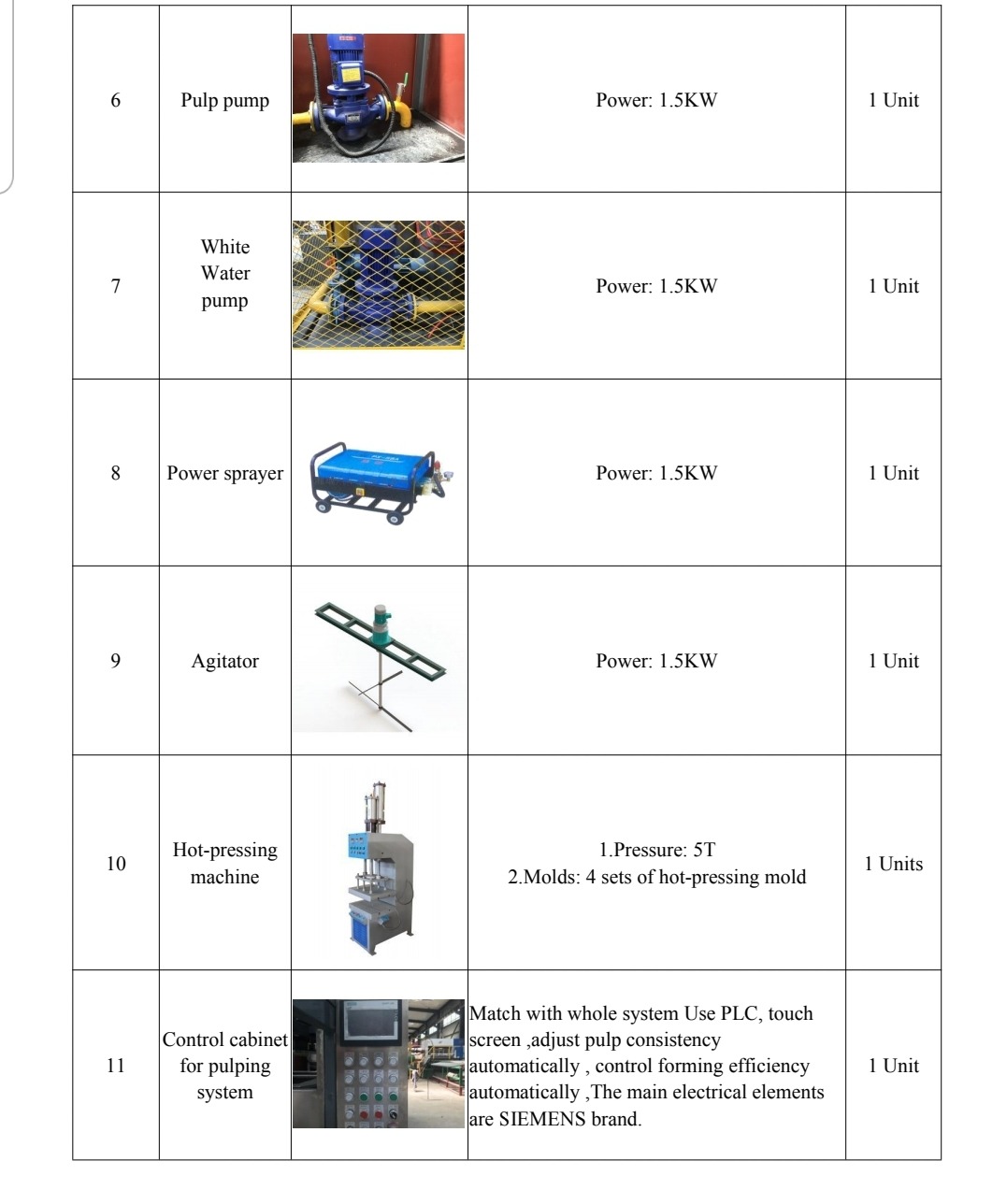

I have one machine making speaker cone paper I'm looking for premises cheap 3 phaseA LOT of investment in custom clamps, jigs, and molds.

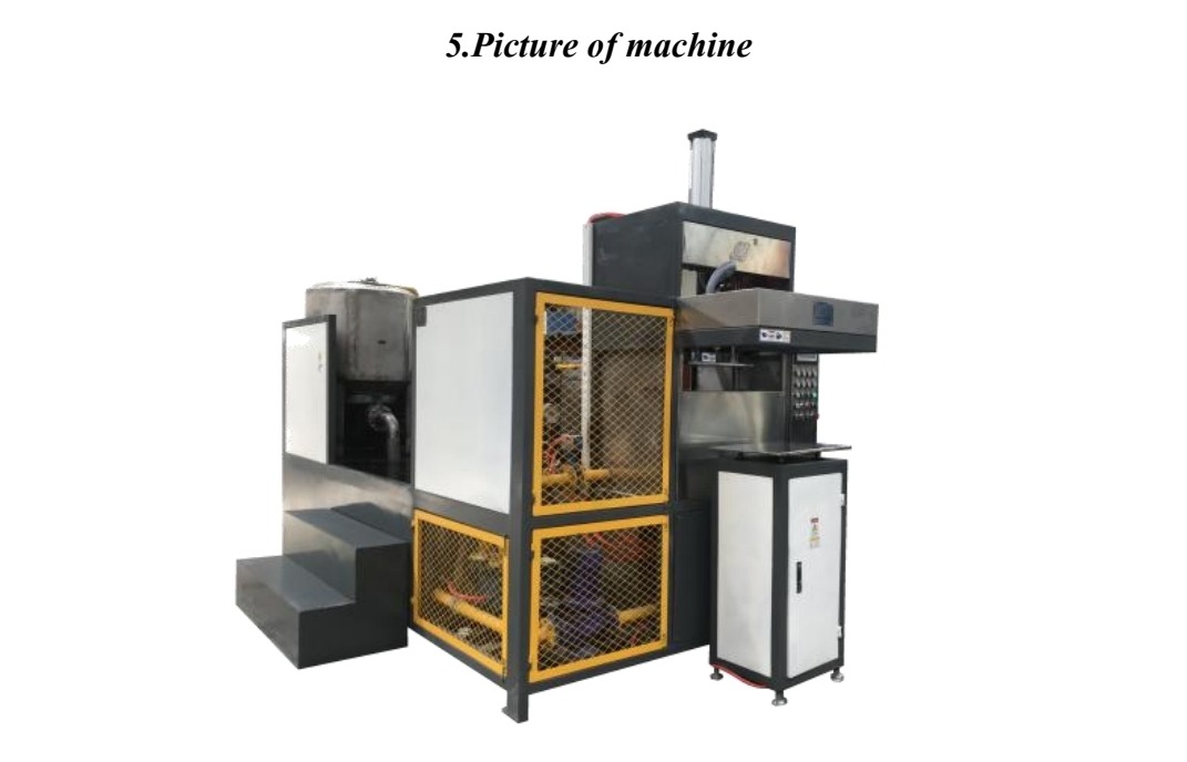

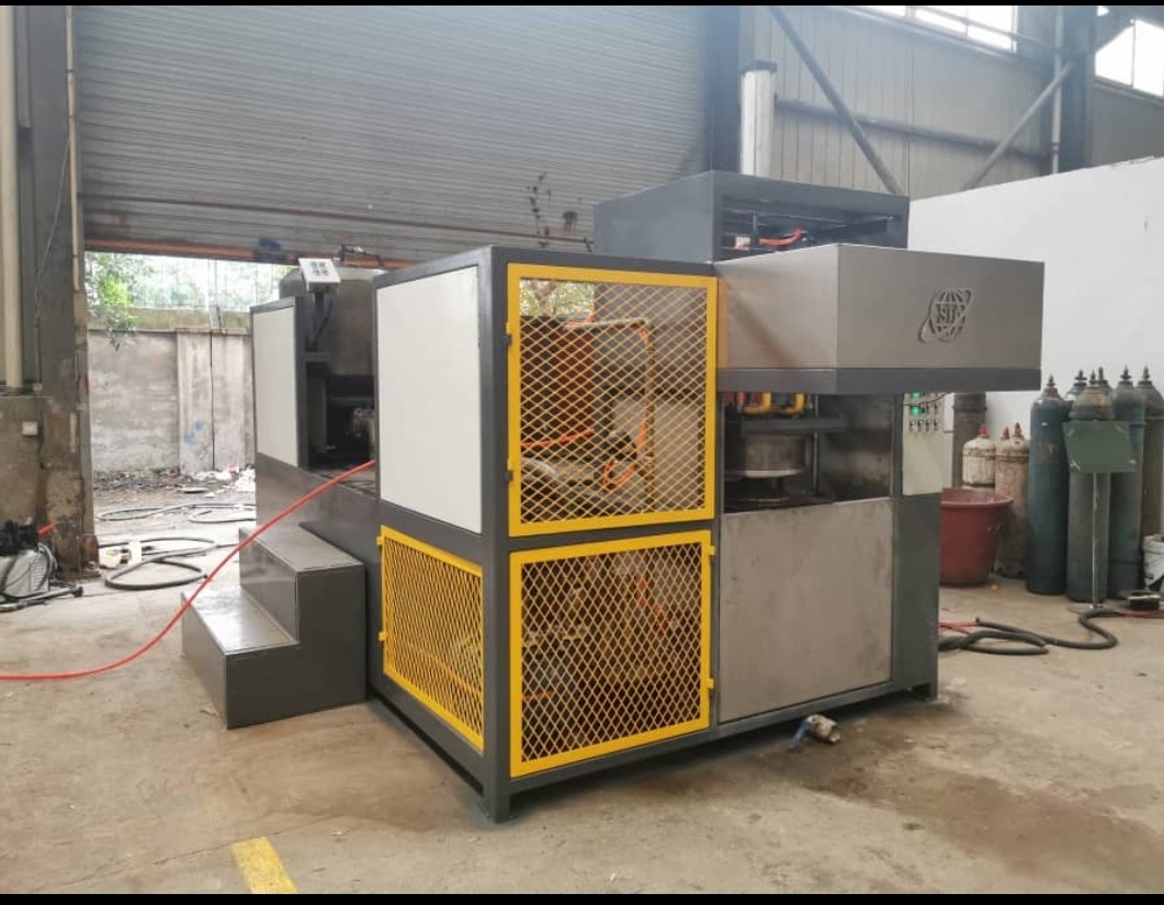

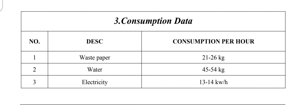

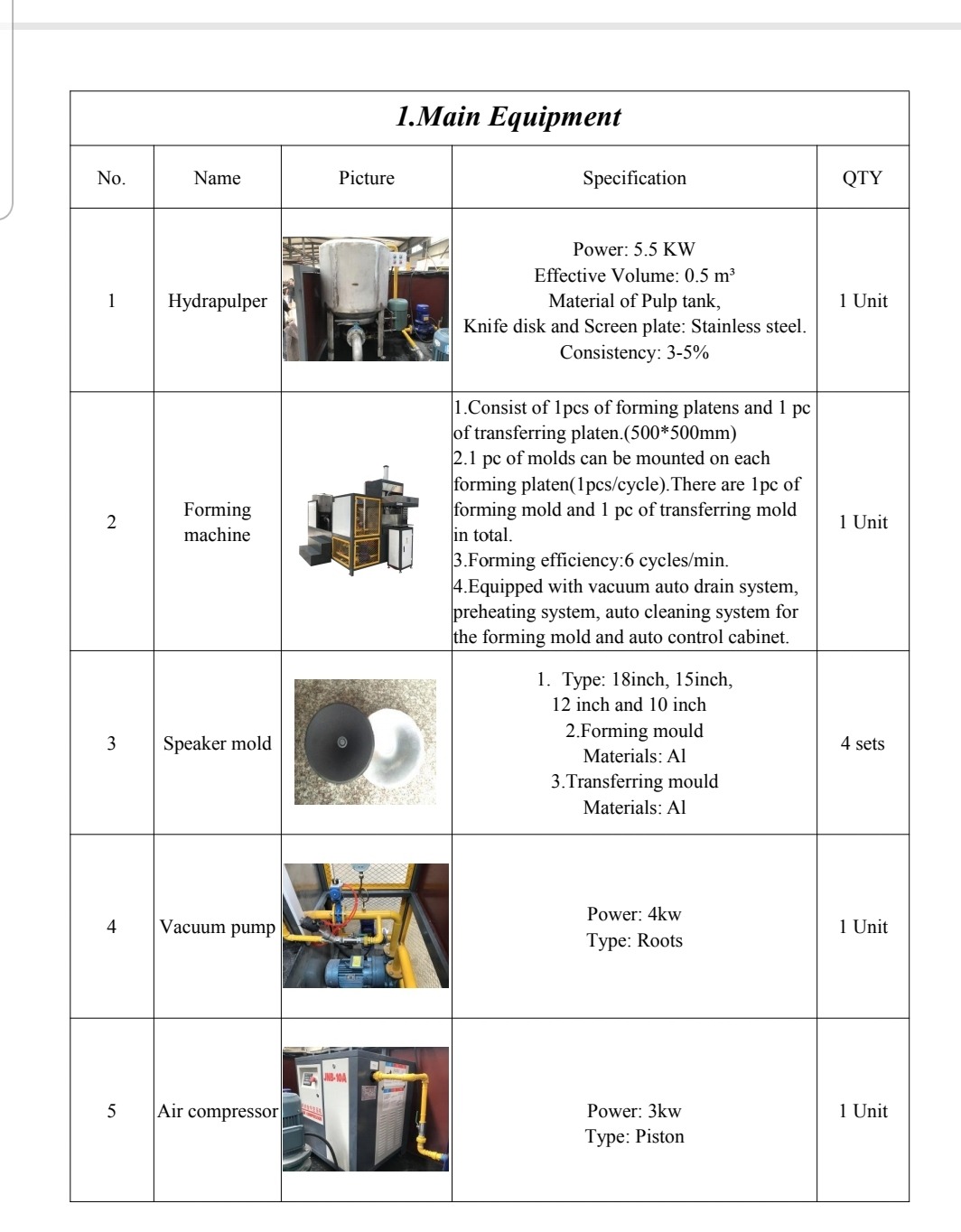

I'm in uk I've got a speaker cone making machine and I'm looking for premises any???????Making cones requires specialized and expensive dies and machinery.

Interesting, exactly what machines you have?
A pulp mill?
A vacuum forming sieve?
A cone pressing steam press?
What kind of Mains (voltage/HP/single-3 phase) do you need?
I guess you are searching to rent some kind of Industrial building?
Rather than a Forum which is hit and miss, you should ask at some local Industrial real estate company, to see what they have available.
How many sq feet do you need?
Any special water/plumbing needs?
Check local zoning regulations.

That's the machine and the cone paper heater in the foreground
IMPRESSIVE machinery!!! Congratulations!!!!

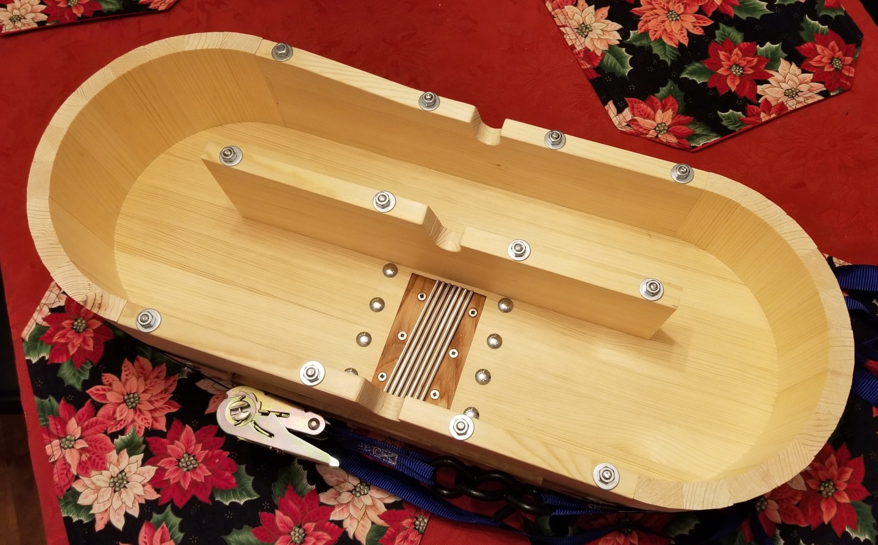

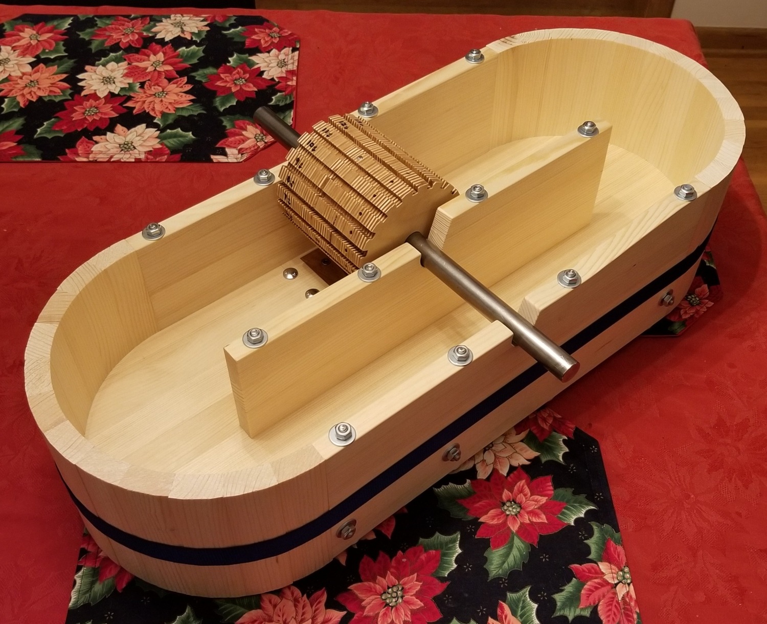

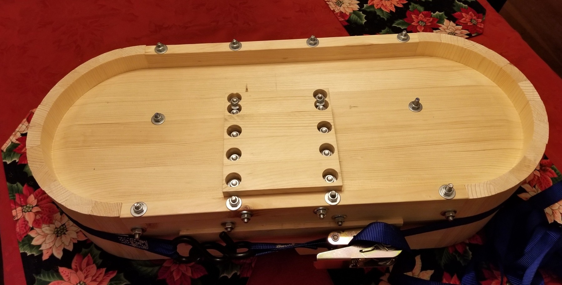

I'm fairly close to completing the beater tub now. I still have to fabricate the steel bands that will go around the staves (the ratchet strap shown in the photos is just for checking parts fit and to hold the staves in place temporarily). After that, I need to make the backfall and then the tub itself will be complete. See this for information about the parts of a typical Hollander beater and some details of how the commercial-sized ones were constructed circa 1900.
The internal dimensions of the tub are 25" L x 9.25" W (63.5 cm L x 23.5 cm W) with a depth of 4.625" (11.7 cm) at the back and 3.875" (9.8 cm) at the front. Maximum fill depth will be just over 3" (7.6 cm), which, based on some approximate calculations, should mean a water capacity of a little over 8 liters. The maximum practical stock consistency will probably be between 2.5-3.5%, so the machine should be able to process around 200-280 grams of fiber (dry mass) per batch. Should be enough for maybe 12-18 cones per batch of pulp, assuming some loss. Commercially available small beaters (that a small hand papermaking studio might use) start at about 3 times that capacity, but I think the smaller capacity is better suited to my application (at least for now).
All the interior surfaces of the tub (and most of the exterior ones as well) are planed rather than sanded for a simple reason: sanded wood gets rough and fuzzy when exposed to water, while planed wood does not.
The beater roll and motor (a 1/3 hp single phase induction motor salvaged from an old clothes dryer) will be carried in a pivoting yoke to allow variation of the clearance between the flybars and bedplate bars. I'm also planning to include a counterbalance system that will allow adjustment of the roll load (force exerted between the roll and plate) to regulate the intensity of the beating action. Most small fixed bedplate beaters don't have this feature, instead only offering a means of adjusting the minimum clearance. The Noble & Wood Cycle Beater is one example of a small(-ish) fixed bedplate experimental beater that does have a means of adjusting the roll load.
