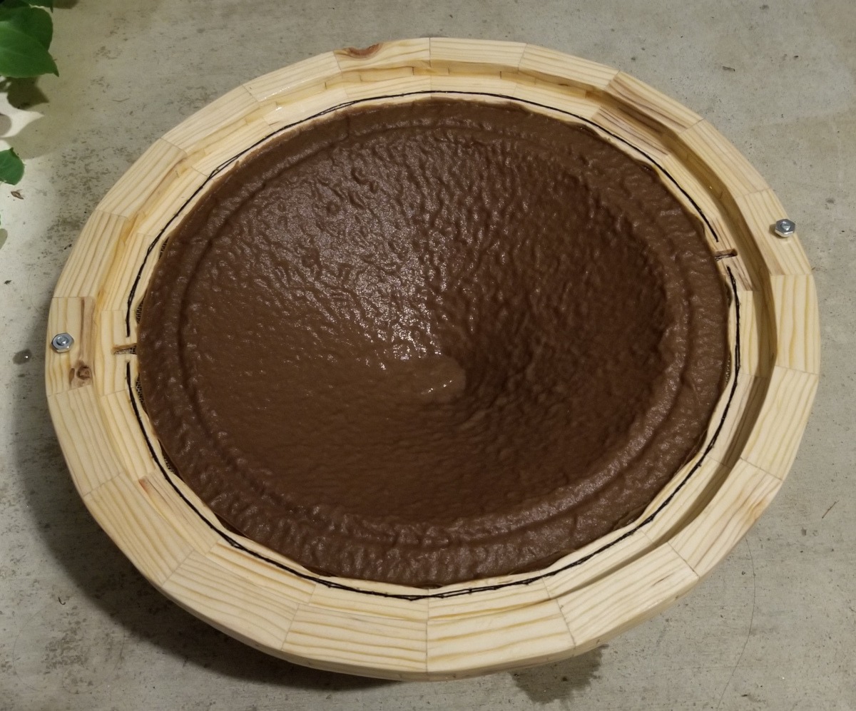

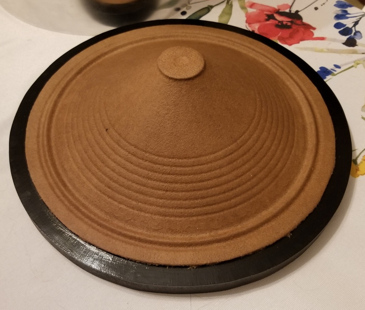

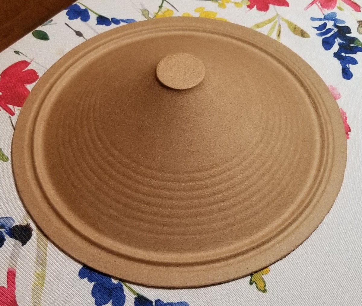

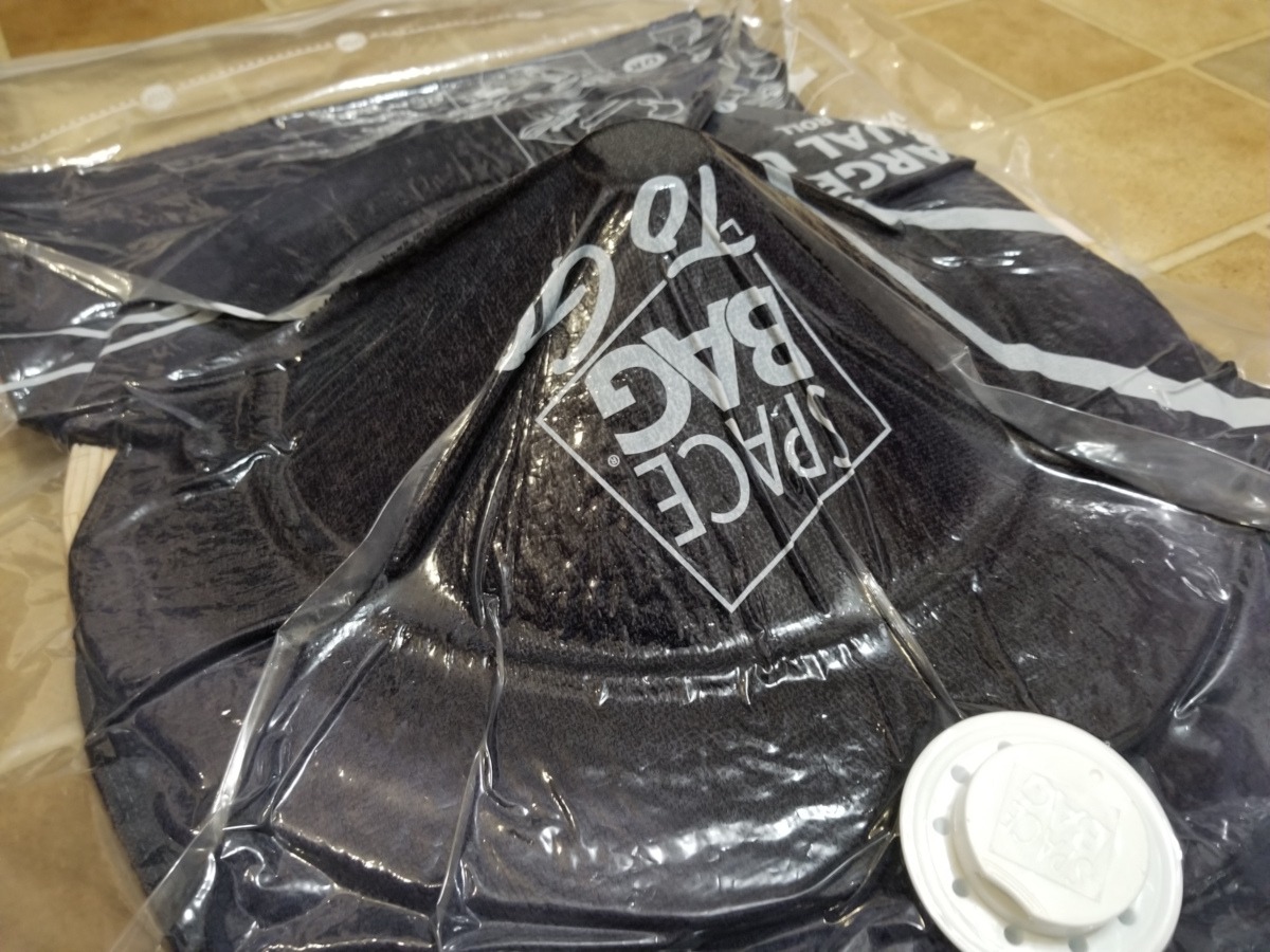

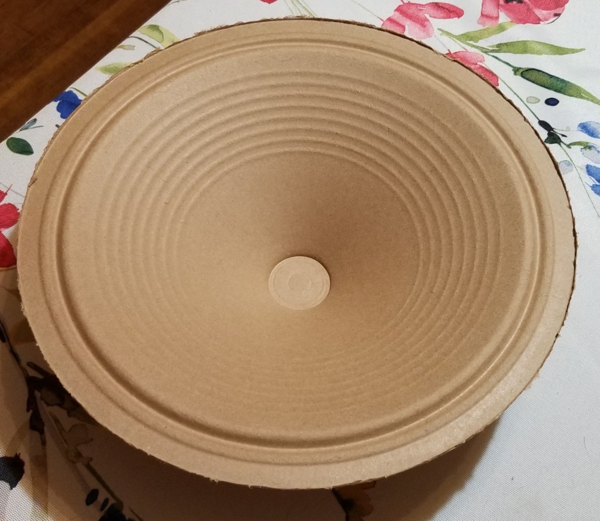

I've done a few more test cones since my last post. The vacuum press (just a vacuum storage bag intended for clothing) does a good job of eliminating air bubbles, so that problem appears to be solved. Attached are a few photos from the most recent test. Final dry mass of this one is 11.3g (input was 12.4g, so 1.1g of fines, fillers, etc were lost). There are still some minor surface imperfections on the front side of the cone which appear to be related to the lumps shown in the second photo. A deflocculant should help, but I haven't tried it yet.

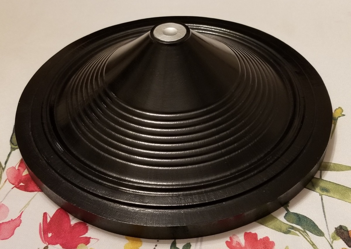

Is the mould in pic 1 (finished cine mould) just painted and sanded MDF? Nothing short of spectacular then.
Thanks! It's plaster over an MDF base, shaped with a 3d-printed running mold. More info in this post.

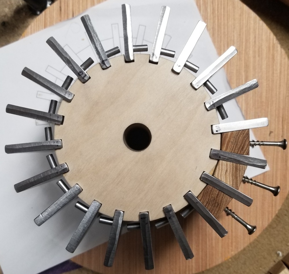

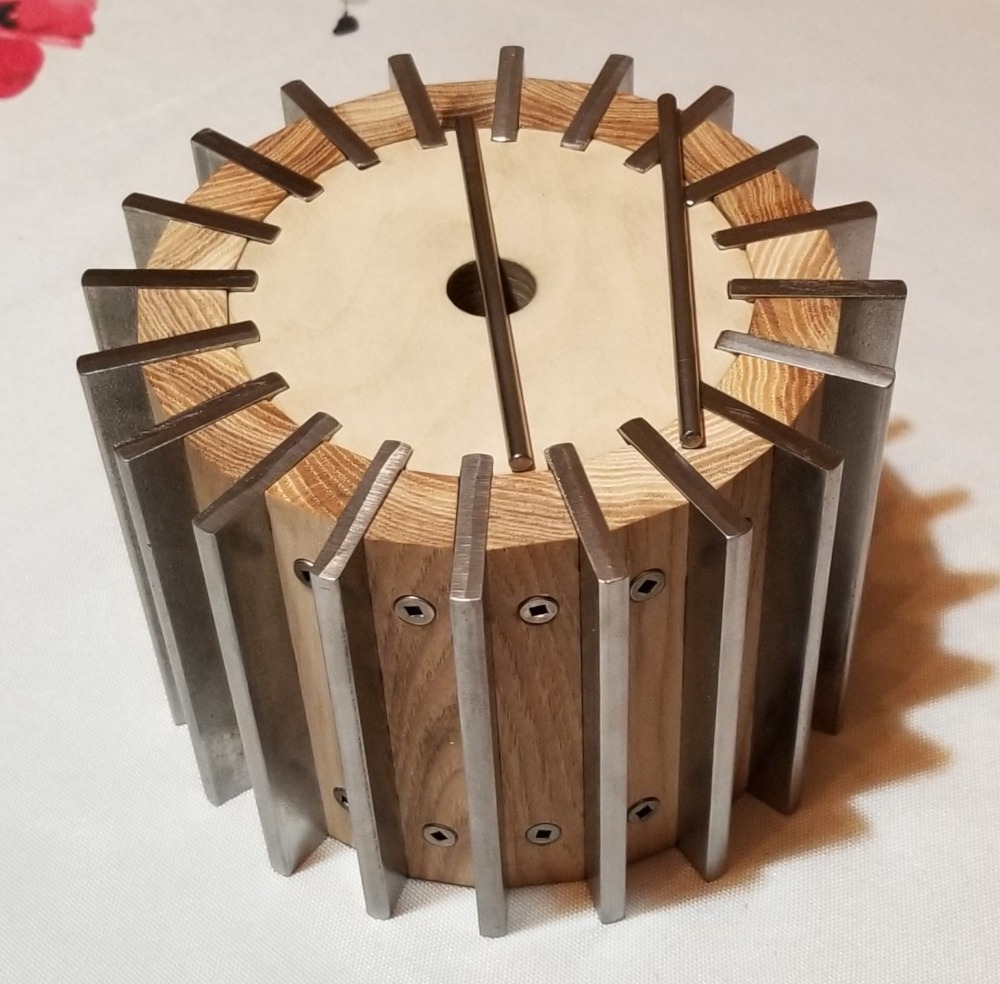

Small update: I'm making some (rather slow) progress on my beating engine. I've nearly completed the roll (see attached photos) and I plan to start construction of the bedplate, tub, yoke, etc. shortly.
The roll is 7" (17.8 cm) in diameter, 4.7" (12 cm) wide, and weighs 12.6 lbs (5.7 kg). I made the core from stack laminated birch plywood and used white oak for the wedges between each flybar. There are twenty 0.25"x1.5" (6.25x38 mm) flybars made of simple structural grade hot-rolled steel. Each flybar has two press-fit steel pins that fit into holes in an adjacent oak wedge. The wedges are held to the plywood core with two stainless steel screws. The roll will be fixed to the shaft (0.75" [18 mm] dia) with two steel pins.
If you're wondering why I'm not using stainless steel for the flybars, the answer is basically curiosity (and a little bit cost too). Stainless would've been more than three times the cost and I'm curious how well non-stainless steel will hold up. Commercial beaters used carbon steel flybars (or, for certain grades of paper, bronze or basalt) for 250 years or more before stainless steel became more common, so I think it'll be OK 🙂.

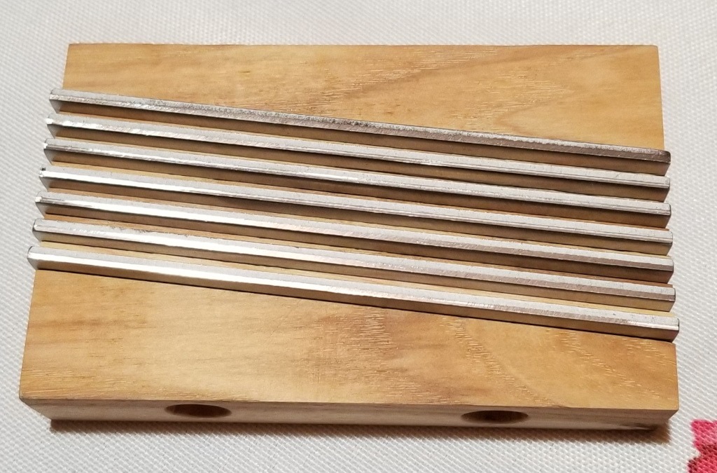

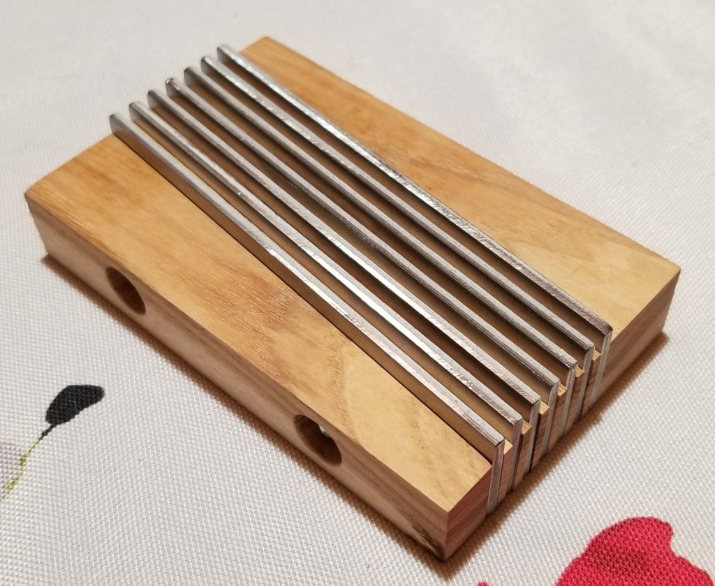

The bedplate is now complete. It is 2.9" (7.4 cm) long and 4.7" (12 cm) wide with seven 0.125"x1" (3.175x25.4 mm) steel bars and six 3/32" (2.38 mm) spacers set at a 5° angle to the roll axis. The wood parts are white oak. Two 1/4-20 machine screws hold the assembly together. The bars will be ground to conform to the shape of the roll later on.
