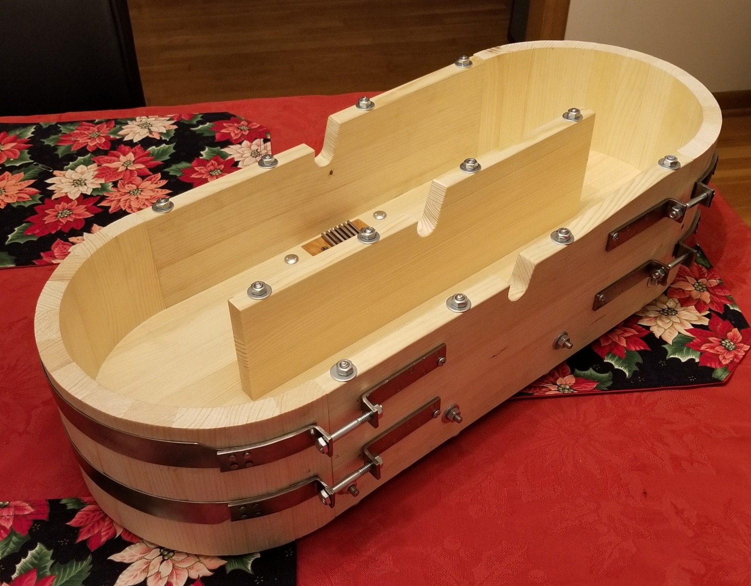

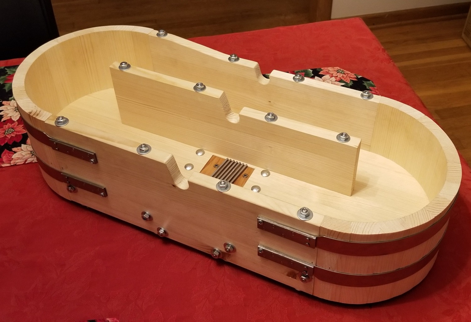

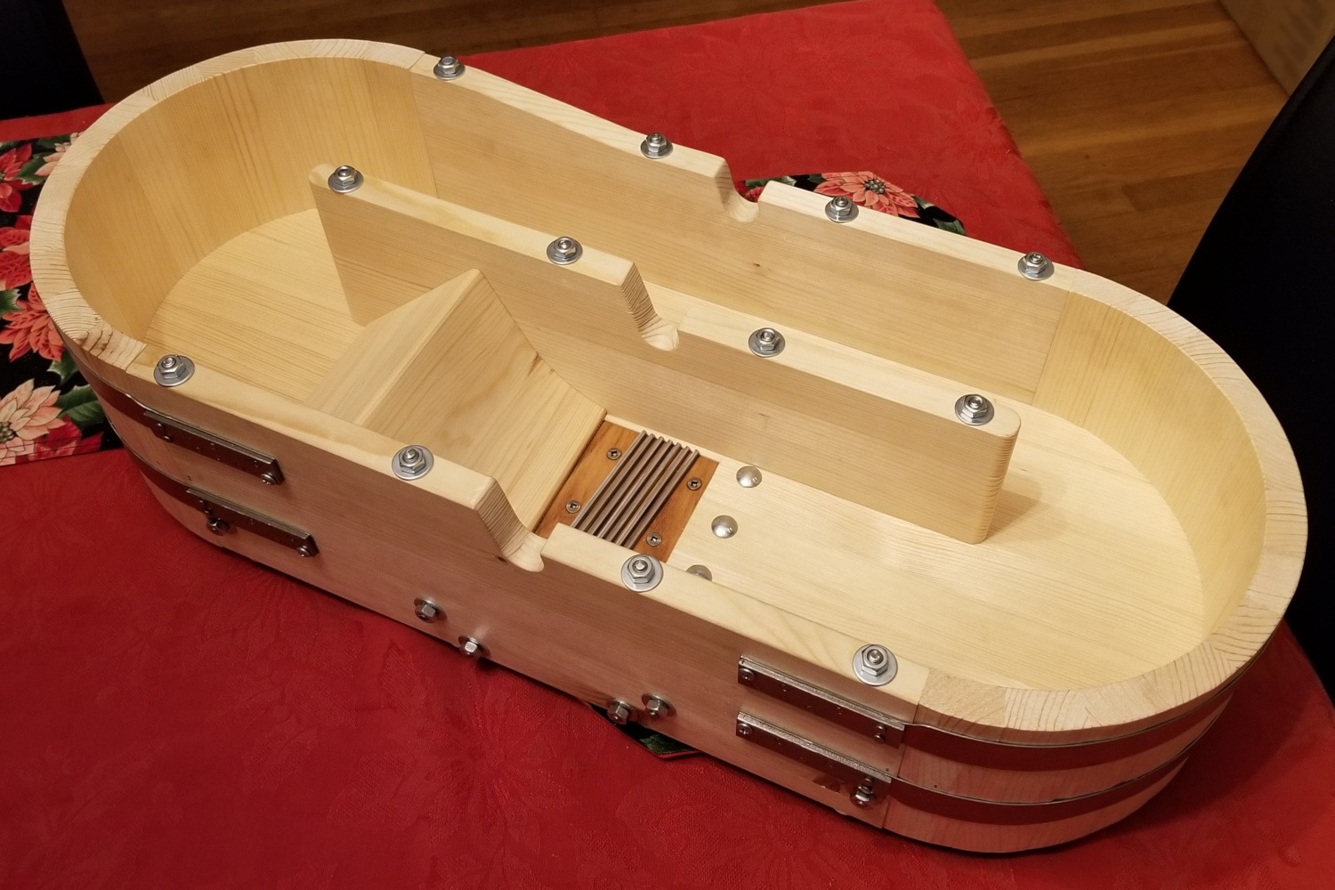

The flow is clockwise around the tub when viewed from above (as in photos 1 and 2). I made the back slightly higher because, during operation, a head is formed behind the backfall (not shown). See Fig. 9 (§3, page 16) in the book I linked in my previous post for an extreme example with a very high backfall.

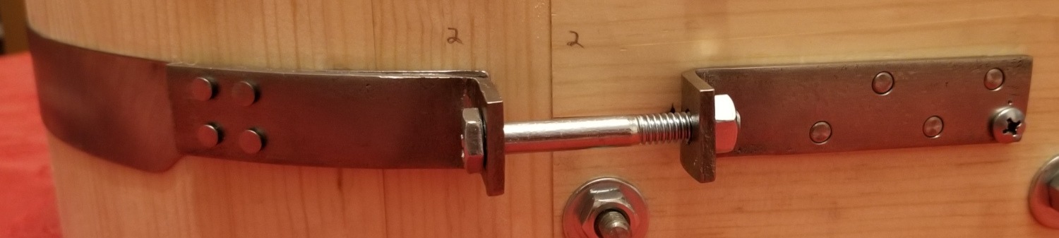

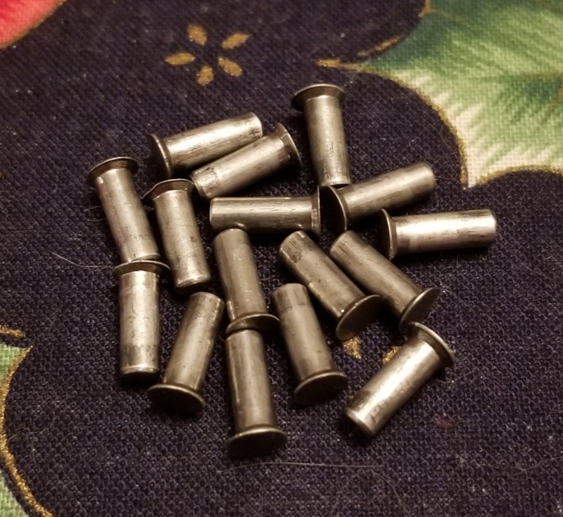

I completed the bands today. They are made from 0.031" (0.8 mm) thick sheet steel with 1/8" (3.2 mm) thick steel end pieces, fastened together with 0.116" (2.95 mm) solid steel flush rivets. I hot forged the L-shaped pieces using my box-of-dirt charcoal forge and cold forged the rivets from nails with a simple die I made. The pieces that are fixed to the side panels have four 3/16" (4.8 mm) press-fit steel pins (dowels?) that go about 1/2" (12.7 mm) into the wood. This is actually the first time I've done any hot forging or riveting, so I think they turned out pretty well 🙂.
Now on to the backfall, yoke, curb, etc... (this project is definitely taking longer than I originally imagined)

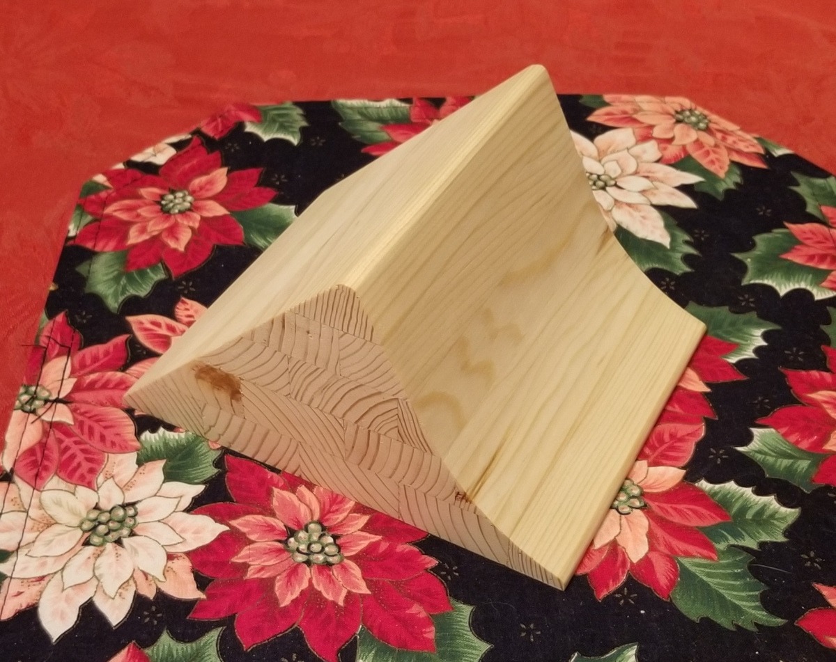

The backfall is done. It's just a bunch of scrap/reject pieces glued together. I used a chisel, gouge, block plane, and the hollowing plane I made earlier to carve it to shape.
It'll be interesting to see if the glue joints hold up to the water exposure. I used Titebond III which is a "waterproof" (ANSI/HPVA type 1 water resistance) crosslinking PVA, but the bottle also says it's not for continuous submersion.

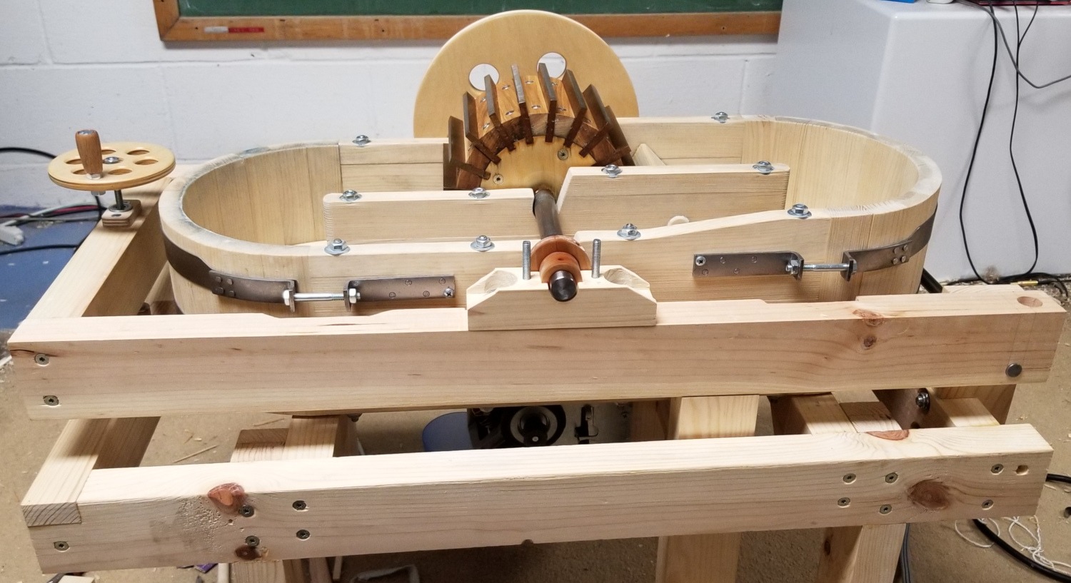

I got a bit lazy about updates. The beater is done now and it works quite well. Here's a short video of it beating 170g of cotton rag (an old bed sheet) in 7.8L of water (2.2% consistency). It does turn out that the maximum consistency (and therefore capacity) is a little lower than I originally estimated, but that's not a problem.
I decided to ditch the counterbalance system. Seemed like too much extra complexity for what might be a negligible improvement in repeatability. There are so many other factors that might impair repeatability[1] that I figured it probably wasn't worth the effort, at least for now.

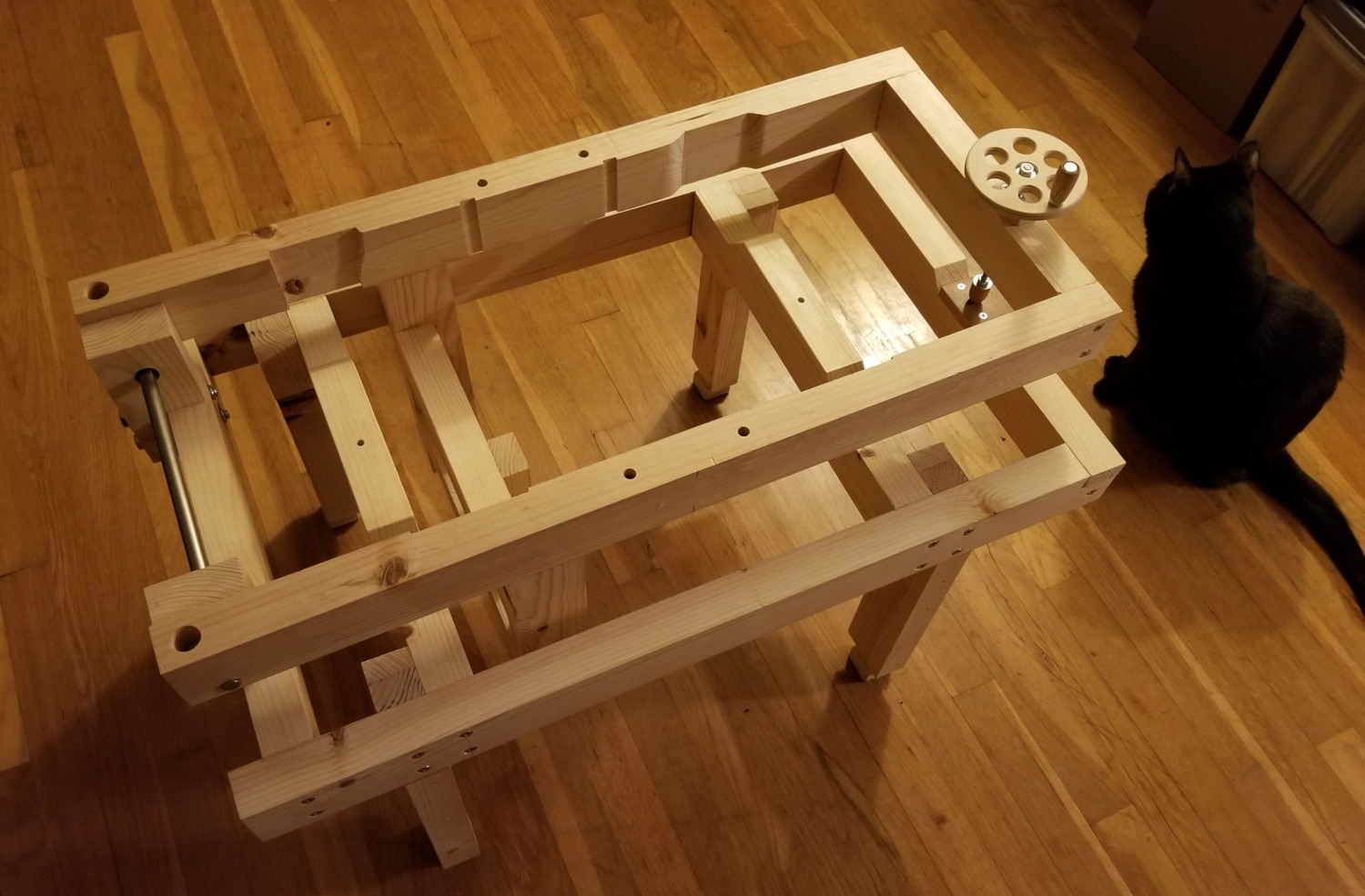

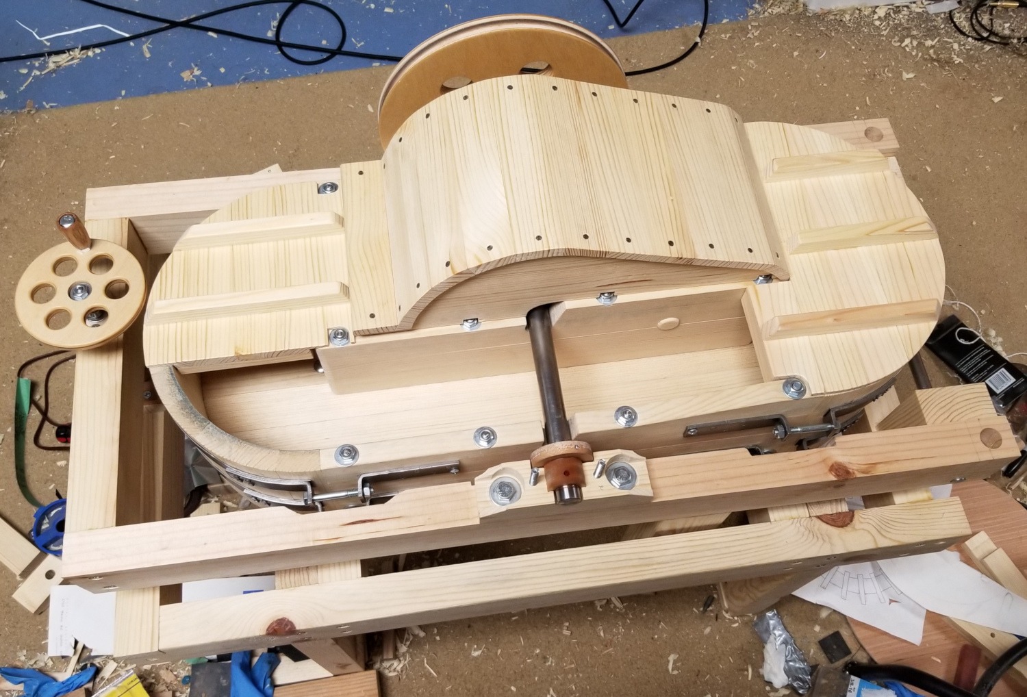

The first attached photo is the frame that everything sits on. There's a pivoting yoke that carries the roll and motor. The tub is bolted to the two middle cross pieces. The second photo is the assembled beater, less the top part of the roll bearing blocks. I actually have some pillow block ball bearings, but I decided to try wooden plain bearings for two reasons: 1) I was curious how well they would work, and 2) by making the bearing blocks split, the roll can be removed without upsetting the alignment between the roll and bedplate (useful for cleaning or other maintenance). The bearings are wax-impregnated hard maple lubricated with a general purpose lithium complex grease. There are two collars (also maple) that prevent the shaft from moving side to side. So far, the wood bearings seem to work perfectly fine. Time will tell regarding service life, but I can easily make replacements if they wear out.
The v-belt pulleys are made of Baltic birch plywood. The big one (9.25" or 23.5cm OD) I turned on a wood lathe while the smaller one (3.05" or 7.75cm OD) was turned directly on the motor shaft using an improvised tool rest. Commercially available pulleys are amazingly expensive in larger sizes.
I rough ground the roll and bedplate with an angle grinder and then refined the shape with sanding belts. I wrapped the roll in sandpaper to grind the bedplate to a pretty good fit and then ran pulp with abrasive to complete the grinding-in process. I then filed off the burrs and rounded the leading edges of the flybars to about a 1/32" (0.8mm) radius.
Roll height is adjusted using the handwheel at the front. The threaded rod is 20tpi and the roll is almost exactly halfway between the pivot and the adjuster, so each full turn changes the height by 0.025" (0.635mm). There's a wing nut under the handwheel to lock the height setting.

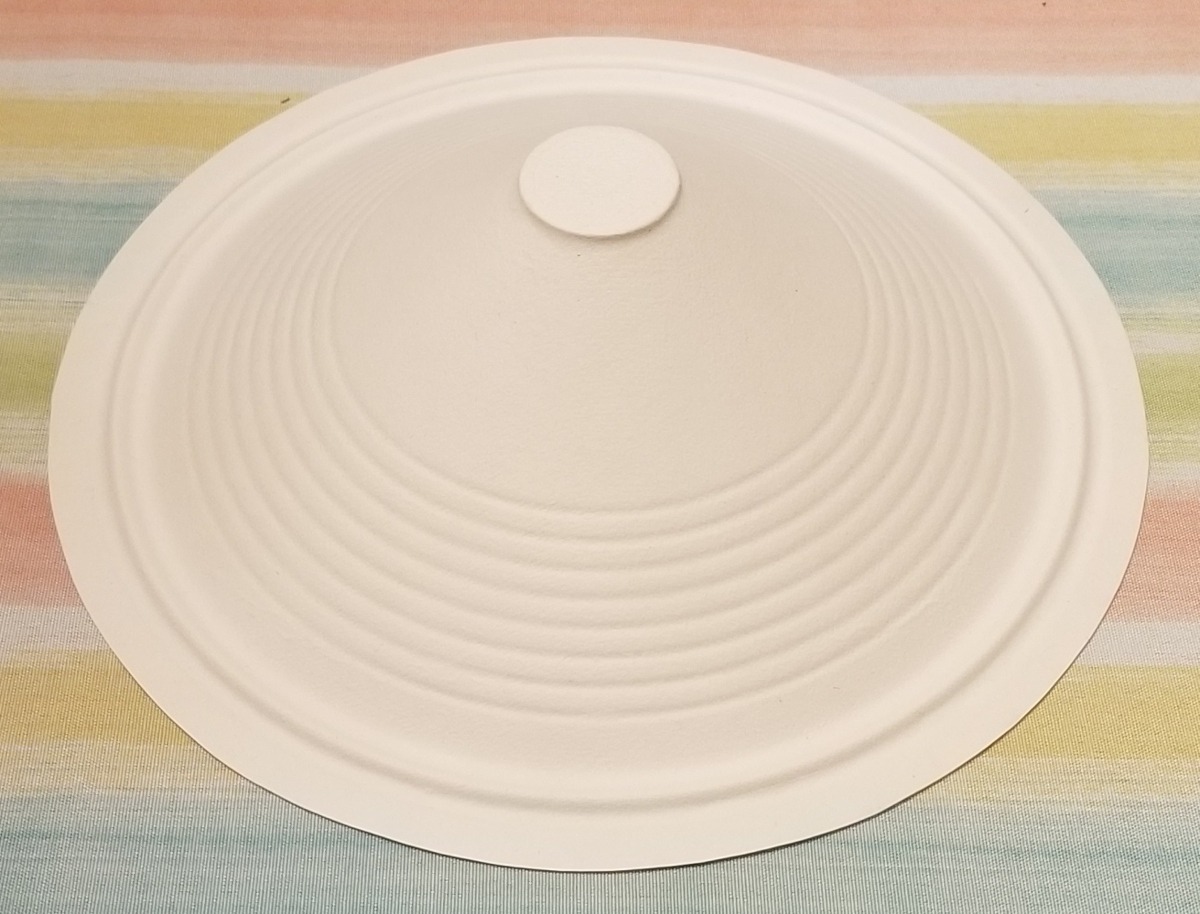

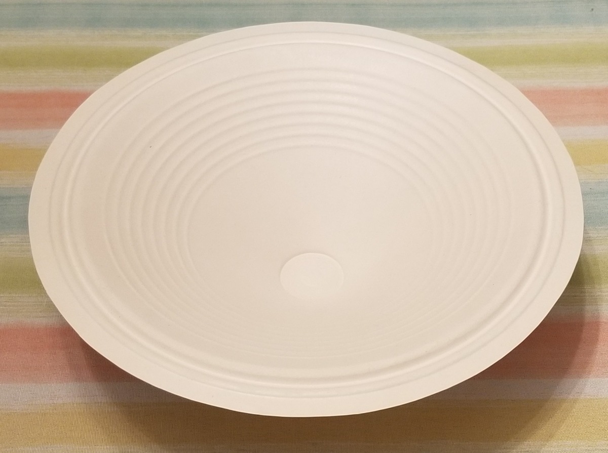

I made a couple more test cones out of the cotton pulp (photos attached). It turns out that reasonably well beaten pulp has more of a tendency to stick to the cone form than the blendered recycled paper I was using for tests before. I wasn't able to pull the dry cones off by hand like I could previously, but I discovered that a quick blast of compressed air lifts them right off.
I determined that I need a better mold (the cone-shaped screen) that holds a more accurate shape, so next I'm going to work on building a mold with reinforcing ribs at the back. This should allow me to transfer the wet web to the solid form with much less trapped air and generally make it much easier to avoid defects.
