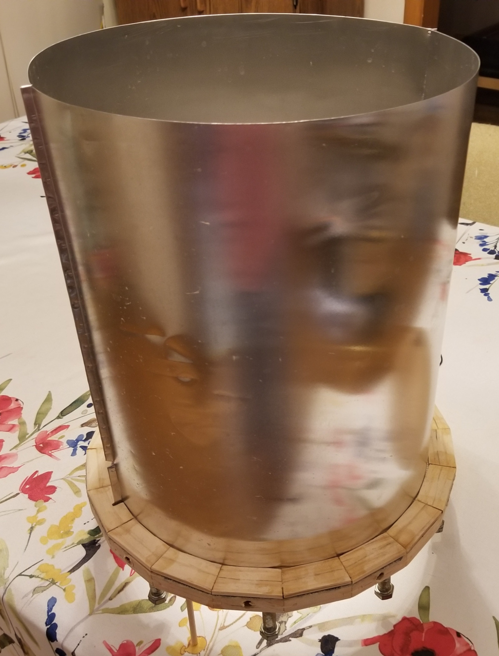

I completed the bands today. They are made from 0.031" (0.8 mm) thick sheet steel with 1/8" (3.2 mm) thick steel end pieces, fastened together with 0.116" (2.95 mm) solid steel flush rivets. I hot forged the L-shaped pieces using my box-of-dirt charcoal forge and cold forged the rivets from nails with a simple die I made. The pieces that are fixed to the side panels have four 3/16" (4.8 mm) press-fit steel pins (dowels?) that go about 1/2" (12.7 mm) into the wood. This is actually the first time I've done any hot forging or riveting, so I think they turned out pretty well 🙂.
Now on to the backfall, yoke, curb, etc... (this project is definitely taking longer than I originally imagined)

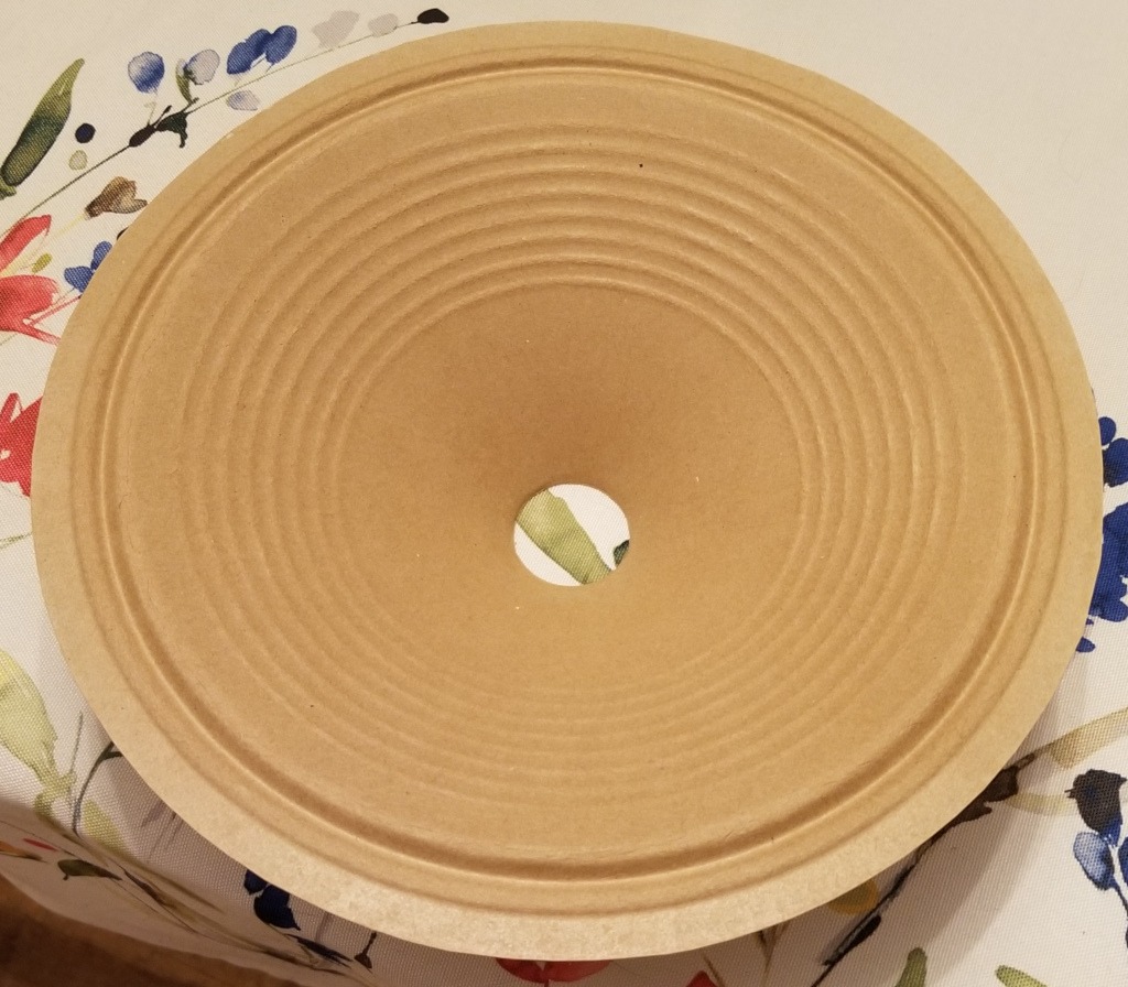

I made a couple more test cones out of the cotton pulp (photos attached). It turns out that reasonably well beaten pulp has more of a tendency to stick to the cone form than the blendered recycled paper I was using for tests before. I wasn't able to pull the dry cones off by hand like I could previously, but I discovered that a quick blast of compressed air lifts them right off.
I determined that I need a better mold (the cone-shaped screen) that holds a more accurate shape, so next I'm going to work on building a mold with reinforcing ribs at the back. This should allow me to transfer the wet web to the solid form with much less trapped air and generally make it much easier to avoid defects.

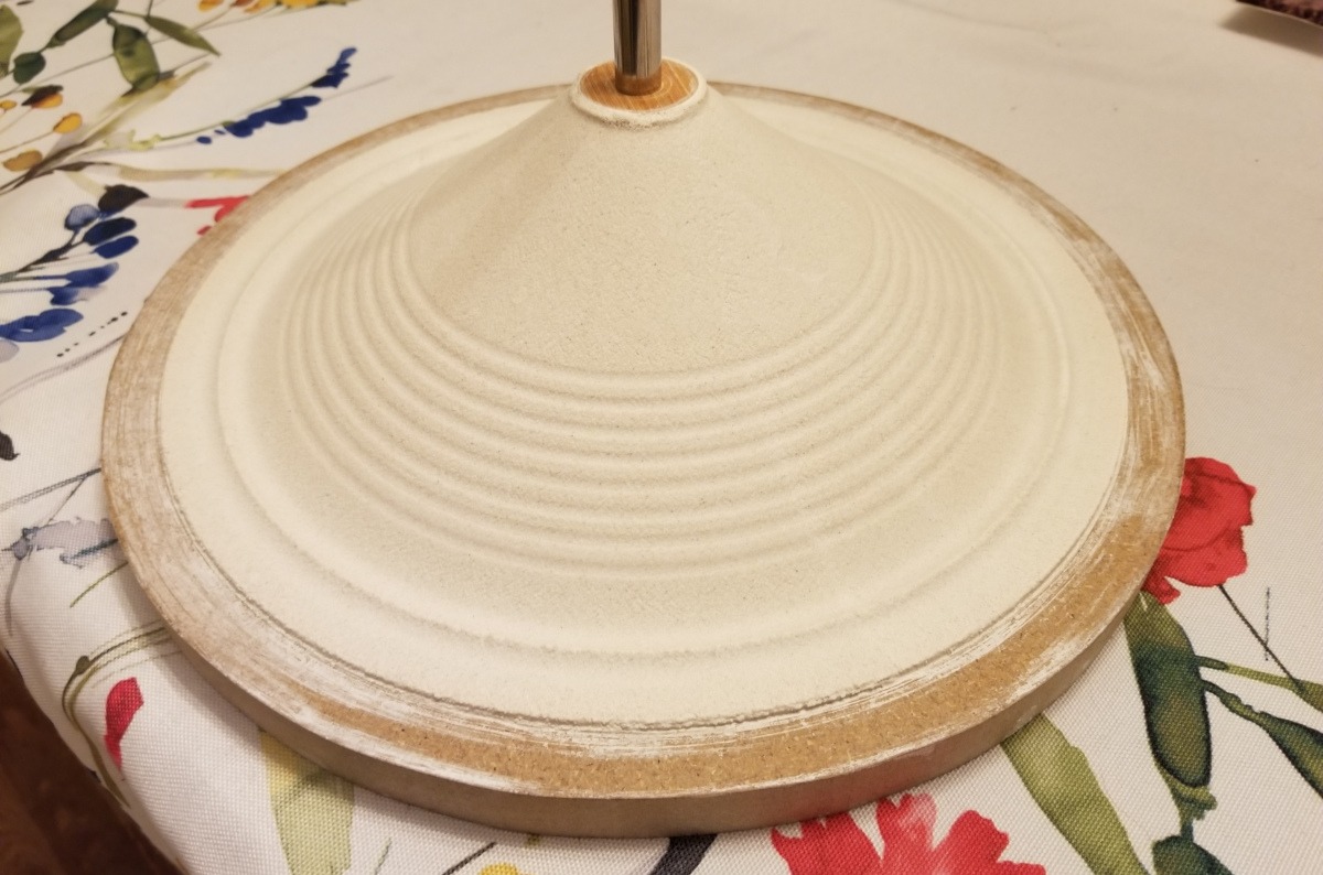

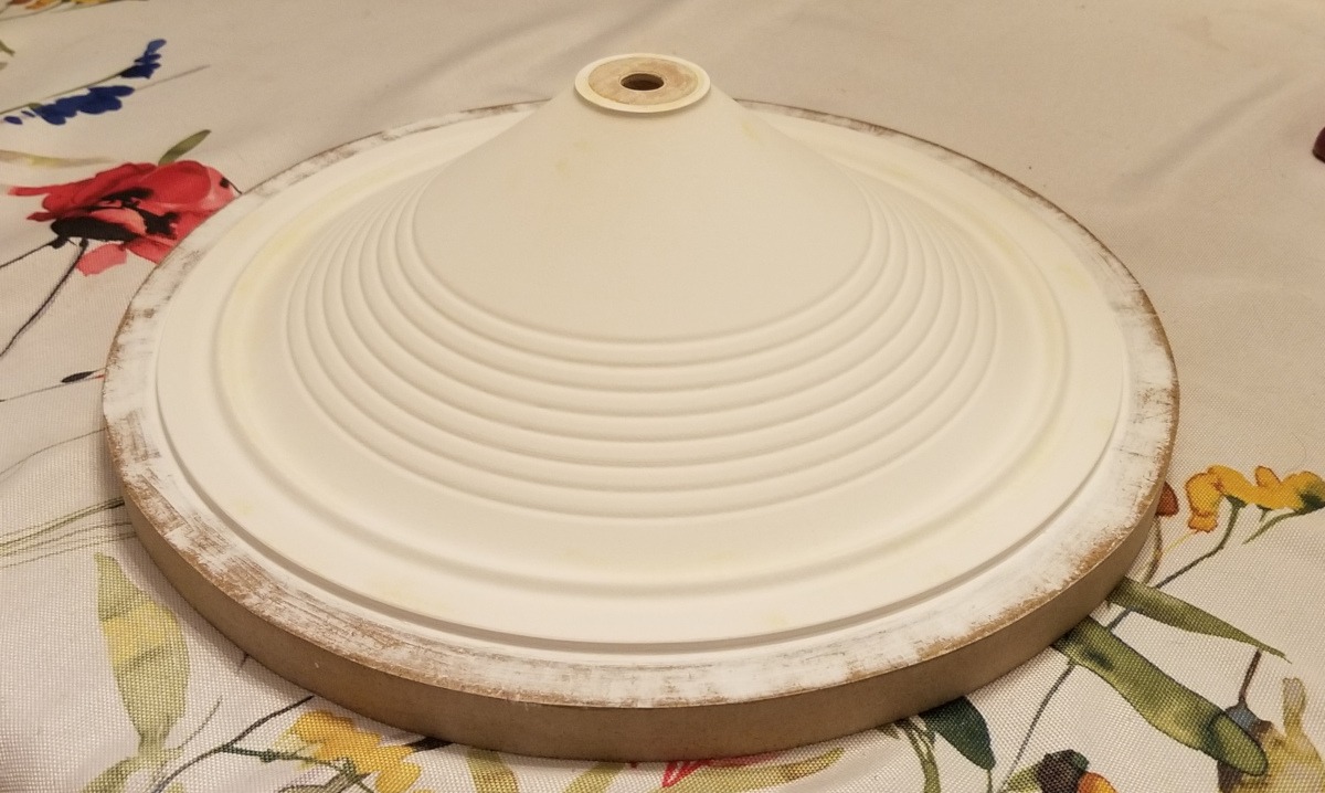

Unfortunately, the first time I put the cone form under full vacuum, the paint delaminated in a couple places. I think the paint was already compromised, but it just wasn't obvious until I put it under a strong vacuum. I refinished it, then promptly cracked the plaster layer by accident... So, I need to make another cone form. This time I'm going to make it solid plaster rather than plaster-over-MDF like I did before.
I made a batch of sisal pulp in my beater to evaluate its properties, but I ended up beating it a bit too long (my beater works fast, apparently), so it drains quite slowly and shrinks a lot during drying. The resulting paper is very strong and crisp with high fold endurance, but the pulp may not be suitable for making cones due to the slow drainage and high shrinkage. It'd probably work well for a voice coil former though. After I finish the new cone form I'll do another batch of sisal pulp with less beating.

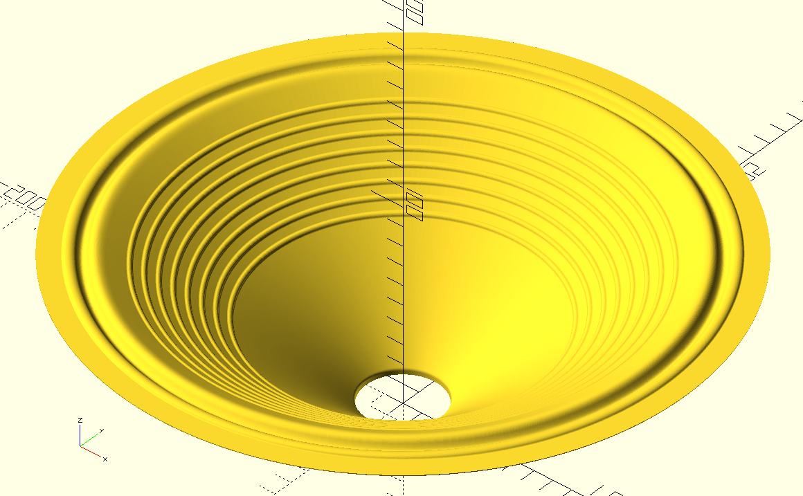

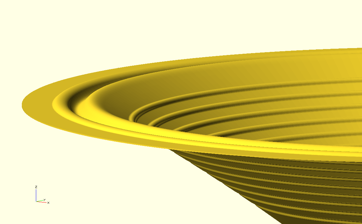

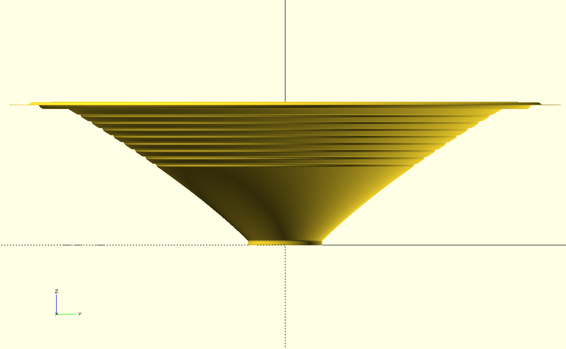

Since I'm making a new cone form, I have an opportunity to make some small tweaks to the cone profile. Based on my measurements, a Celestion G12M cone has a slightly lesser degree of curvature than what I originally chose for my profile, so I'm a bit hung up on whether I should bother with modifying that parameter (which would require some minor modifications to my mold as well) to be more in line with the Celestion. I think I have a vague idea what the effect might be, but I figured I'd ask if anyone here has any input.

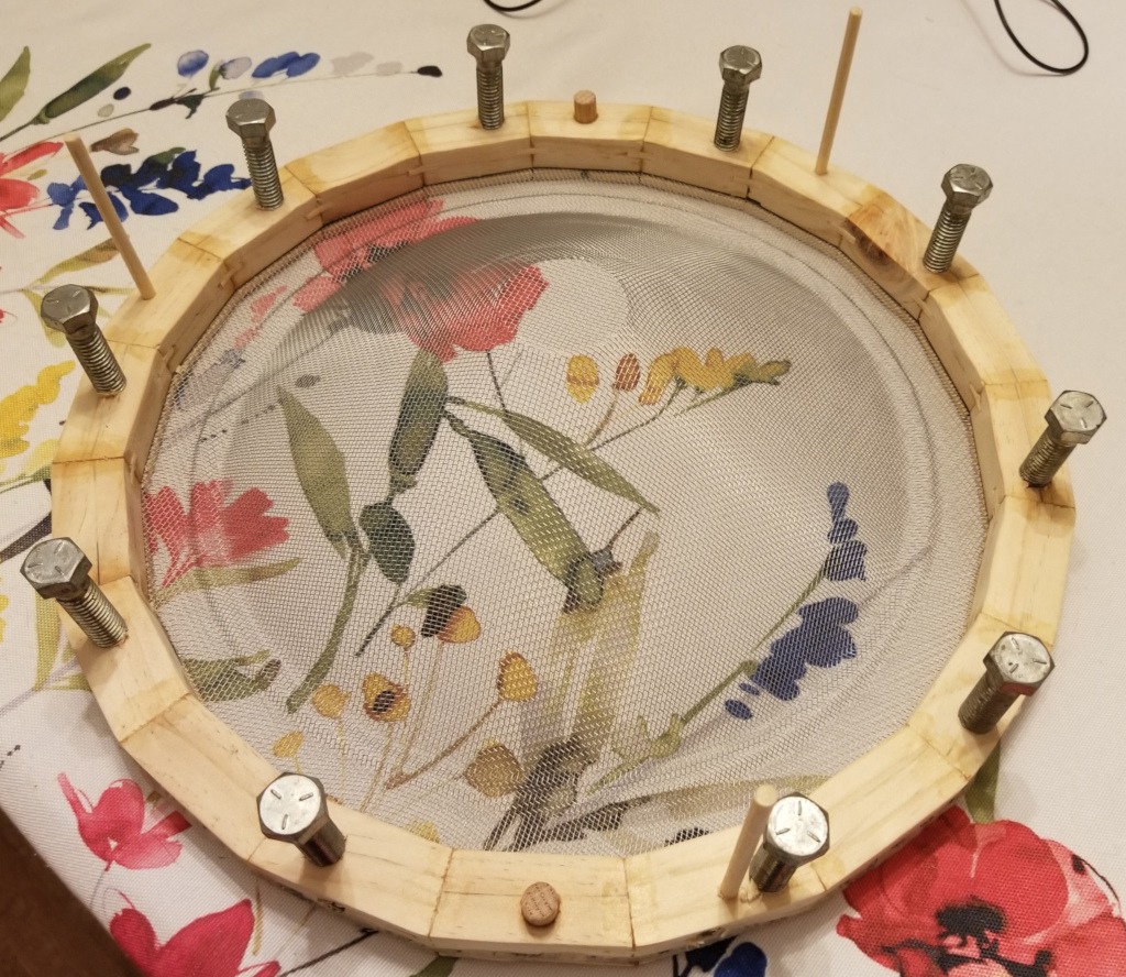

The project has been on hold for a while, unfortunately. I did make some progress though:How did you fare (conewise) since your last posting?
- Completed the new cone form.
- Added reinforcing ribs to the screen mold.
- Made a new 100% wool press felt (hand knitted and then wet felted).
- Made a dedicated vacuum press with a flexible silicone rubber membrane. More even pressure compared to the vinyl vacuum bag.
- Made a pulley hoist system for lifting the screen mold from the vat. Consistent results are much easier to achieve this way, especially with slower draining pulps.
- Made a device for spraying cooked starch solution (much like a simple airbrush). The cotton I was using before seems to have something in it that helped it stick to the cone form; probably some sizing or finishing agent from the textile manufacturing process. The sisal pulp, in contrast, has virtually zero adhesion without an additive like starch. No adhesion means that the cone pulls away from the form and warps as it dries, making it unusable. A small amount of starch (~2% by dry mass) sprayed on the cone surface seems to be enough to fix the problem unless the pulp is rather high shrinkage.
- Did some basic inter-batch dry mass repeatability tests. I made seven cones with a target dry mass of 13g: five were within 0.1g, one was +0.3g, and one was +0.5g. Pretty good overall.
