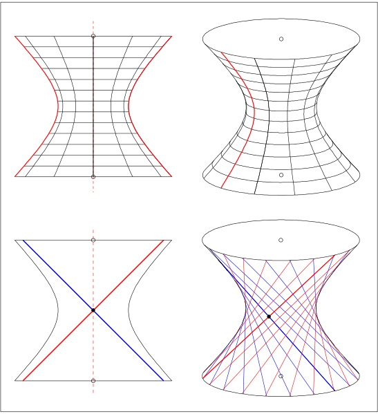

I have always wanted to do a hyperboloid of revolution, with a seamless transition to the voice coil at the neck.My question is this: what types of curves are typically used for the curvilinear cones? Exponential? Bézier curves?
A nice structural shape, easy to reinforce and easy to parameterise.
Richard Lee (member here and expert from when the British were a power in speaker manufacture) said he did experiments and it didn't make too much difference.
But I'd still like to try it.

Do we really need a stiff cone in a guitar speaker? I think cone breakup is a quintessential part of the geetar sound.
