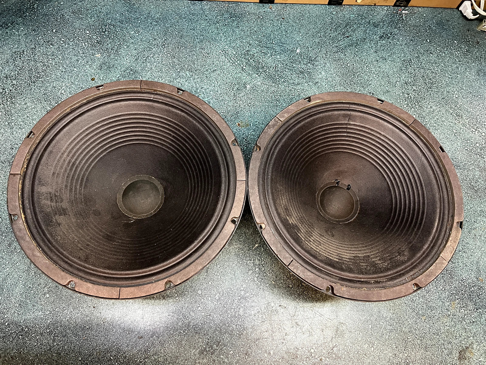

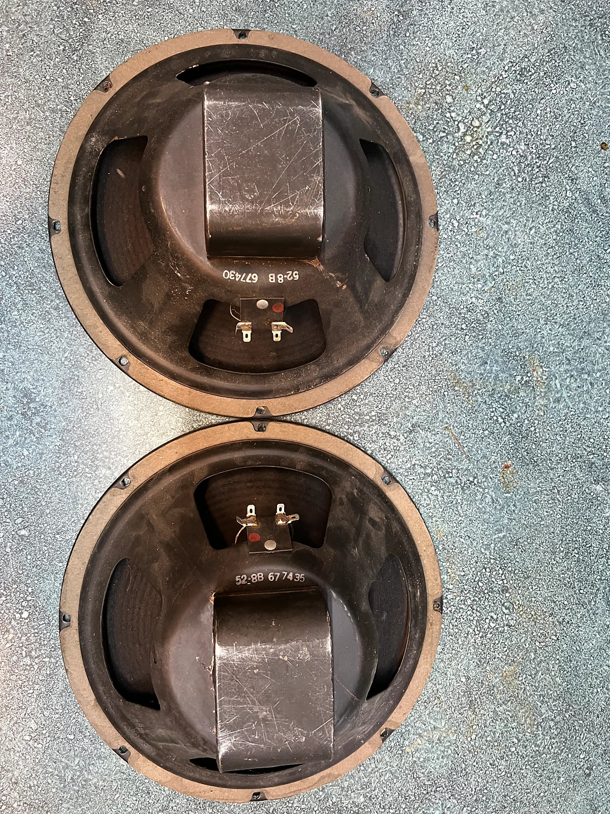

Question for @JMFahey (or anyone else that might know): I've been looking around for another speaker (preferably cheap and in need of a recone 🙂) that will accept the same cone and voice coil as my P12P. I found a pair of Eminence alnicos from 1974 for cheap, but I can't find any information on the voice coil/pole piece diameter. The codes are 52-8B 677435 (photos from the listing attached). Have you ever reconed any similar speakers? If so, do you have any records of the relevant measurements? I've asked Eminence for info and they stated that they couldn't tell me anything because their records from back then are poor and were never digitized.
You decided to recone 'em anyway, whether they're defective or not. So just remove the VC/cone assembly and measure by yourself. Please note there's another parameter that might not be easily disclosed by measurement, the pole plate thickness. And you also do not know B, the magnetic field strength.
Best regards!
Best regards!
I haven't bought them yet, so I can't measure 🙂. I may just buy them anyway, even if no one knows the details, since they're relatively inexpensive. The reason for my interest is that I figured it'd be useful to be able to compare different cones more-or-less directly. If they won't work with similar parts to my P12P, I'd have to make new tooling.
It seems like most guitar speakers have top plates in the range of 6-10mm, which should be workable.
