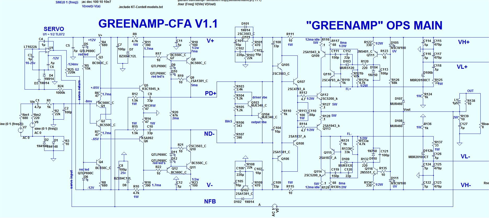

Me bad - error in greenamp schema.
(below is the correction).
I might still reduce currents on this project to accommodate smd and to make it more "green". I assure that no devices will even be warm (besides the outputs). Most small signal devices need no more than 1-4ma.

Hi OS,
as You connected the driver to the RC filtered rails, I would increase the C102, and 103 to 220-470uF, to get more stable, clean rails.

Capacitors C108 and C109 would be better shunted to earth rather than to the power rails.
May not show up in a simple sim without parasitic R, L and C modelled but should improve the PSRR and immunity to RF interference.
I plan to play with the sim today, maybe more comments then.

On # 1 - A "paper" .. from the "villager" ?? I hold back on this for two reasons ... I found most class G/H to be a hi-fi unfriendly compromise between performance and economics. My "take on this" might seem negative or harsh. I still have the rough draft in text , I reserve my right to come to a complete mind on this subject, I am still absorbing patents and designs.
# 2 - At last , some "tricks". I feel honored to shunt my pre-driver bases (to earth). I do not say this with any hint of sarcasm. I will explore the merits of this with an open mind. "villagers can be reasonable" even without their pitchforks 😀.

Harry Dymond's classic "Two Pole analysis" in the JAES looked at where to shunt the compensation capacitors. This looks similar to me, probably not a dramatic improvement but may as well take it, especially before you do the layout.
Another minor improvement, some of the Cordell models are a bit flawed. Remove the EG parameter and let it default. This should improve the temperature behaviour, should you ever do detailed thermal simulations. I normally don't bother with this so I never mentioned it before, just made sure it was correct in my own models. But Toni (ASTX) helped someone with it recently, and a Class G is exactly where a detailed thermal simulation is more likely.

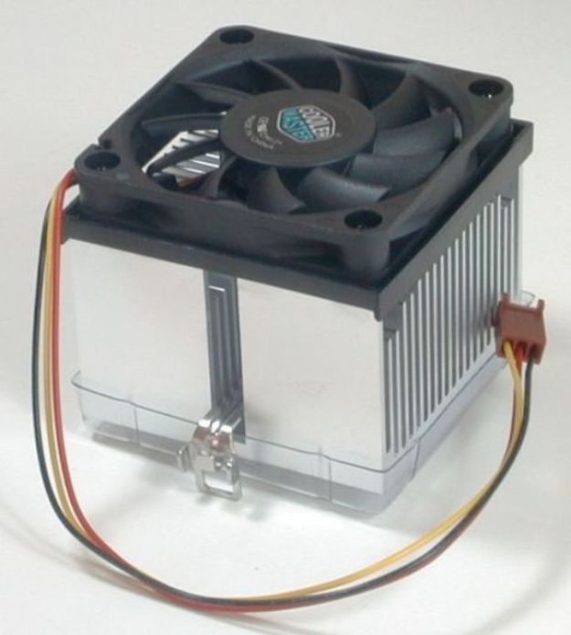

About cooling: Few degree difference is not critical. I use LM35 as sensor, and 2 comparators, for half speed/full speed. Each channel has 10cm long heatsink and 8cm fan for cooling. It looks as the processor cooling system...

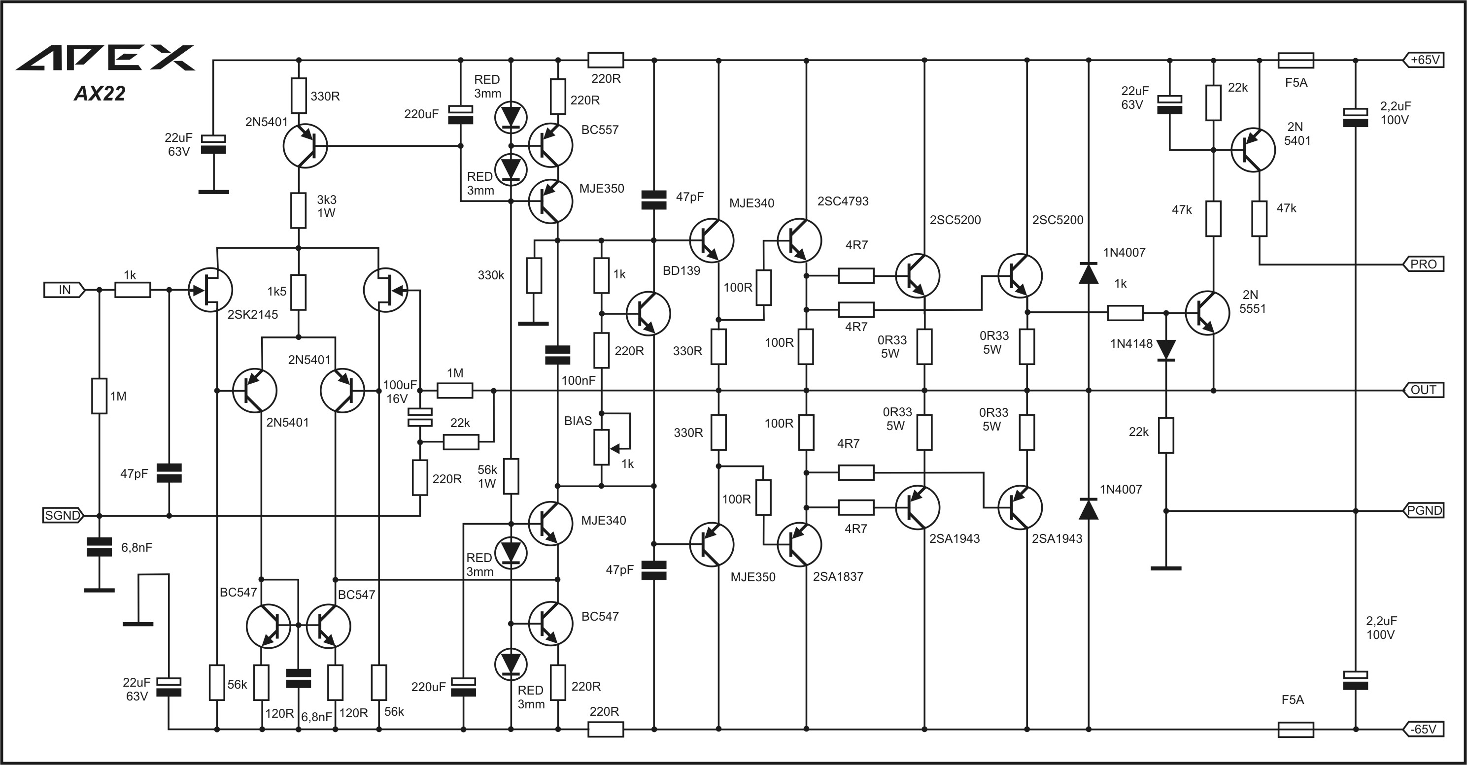

APEX AX11 is my most popular amplifier, but AX22 have 0 builds what do you think why is that.
Hi Apex
How easy is it to get those jfets? Once upon a time there were lots of jfet options including matched pairs and complimentary pairs, but now it's like a desert. Jfets are nice devices but I think an amp design will be more popular and buildable without them.
Hi Apex
You wrote to OS about mHz and MHz and now you are as native English speaker write complimentary pairs instead complementary, strange.
It's gotta be the JFET's.
Design looks good.

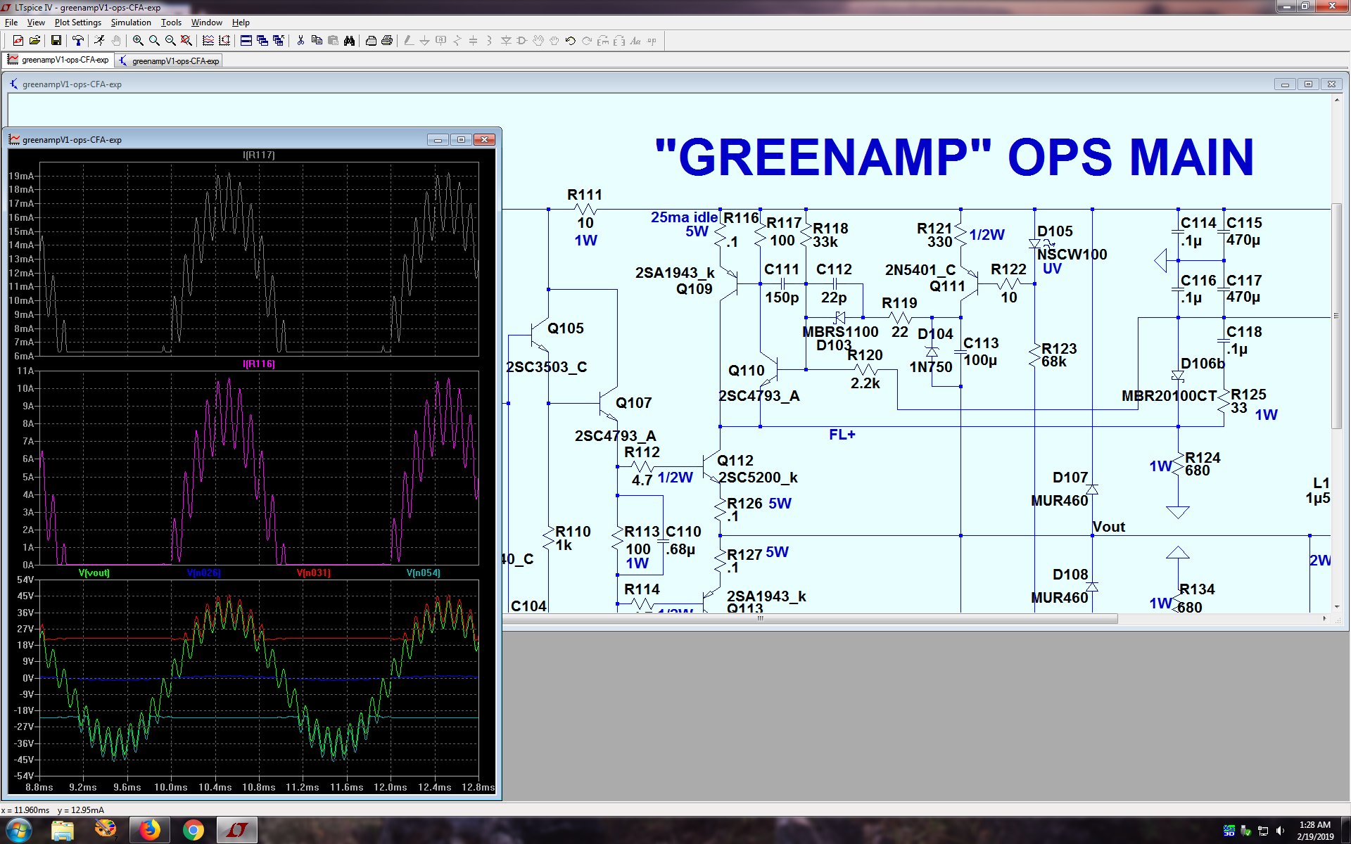

Still had the class H tracker drivers switching off , even as the main devices did not. Changed just one resistor path to the low rail and added a positive bias shunt resistor (R120 and R118).
The current waveforms became as smooth as the tracking , I knew I did something right
. The problem was the reverse leakage of the CFP diode (D103) , even snubbered by (C112) , the leakage forced Q110 into shutoff. I "swamped " it with positive bias (R118). No more crude biasing of Q109 to get my non- switching arrangement - good!
Voltage settling between cycles is also perfect.
Now I get no errata at all from IPS to output. 8ma driver idle and 25ma main idle (Q110 and Q109). And the final good effect is 6ppm 10khz / 10ppm 20khz 4R. Fully transparent !! PS - R118 could be trimmed to set the Idle accurately. Oh . ASC ...set at 10K , deep into class H (below) OS
