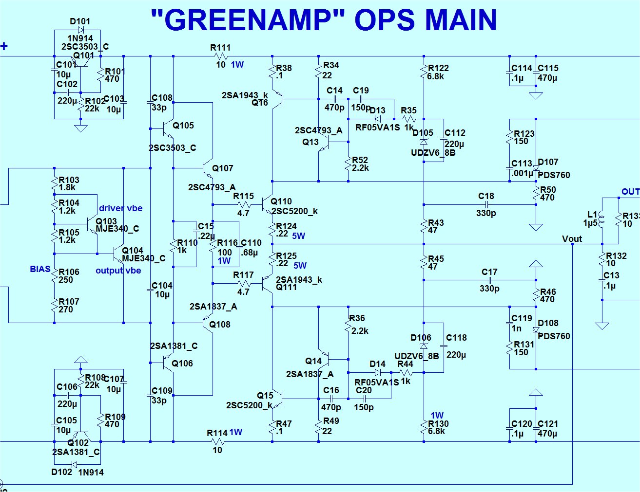

Here is a rather successful arrangement I used in a couple of my amplifiers.
It looks like CFP at a first glance, but it's not CFP. It would be CFP if the collectors of the common-emitter transistors would be connected to the emitters of Q2, Q3.
In this arrangement, those are just the "helper" transistors with their collectors connected to the output.
This configuration is not new - Nelson Pass used it in Nakamichi PA5, PA7, and some other designs, I have just adapted the topology to my needs.
It's very stable in my amps, although my global loop gain is below 20db.
Low distortion, pretty cool distortion profile. The number of "helper" transistors may be different. No base stoppers - those will ruin the quality.

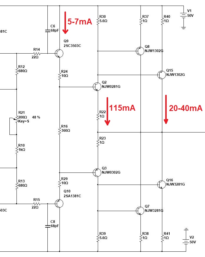

Hi Val,
I have also simulated this output stage before. It seems very promising and you can get very low distortion if the current in the outer transistors are set correctly.
What I fail to understand though is how to keep the outer devices from thermal runaway. The Vbe multiplier only controls the current in the inner devices. As the outer devices heat up, their idle current will increase and there is no feedback loop to control this. How did you make that work?
They’re underbiased in current terms by relatively huge emitter resistances so bias point are slightly affected by thermal issues. Also drive resistances have 5x nominal and controlled bias by previous stage.

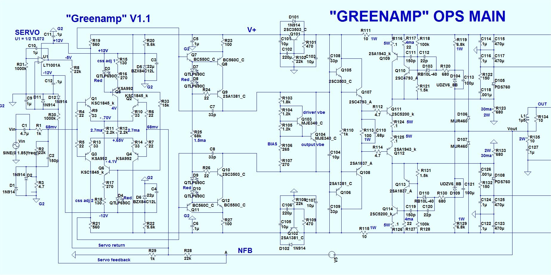

Very impressed !!!

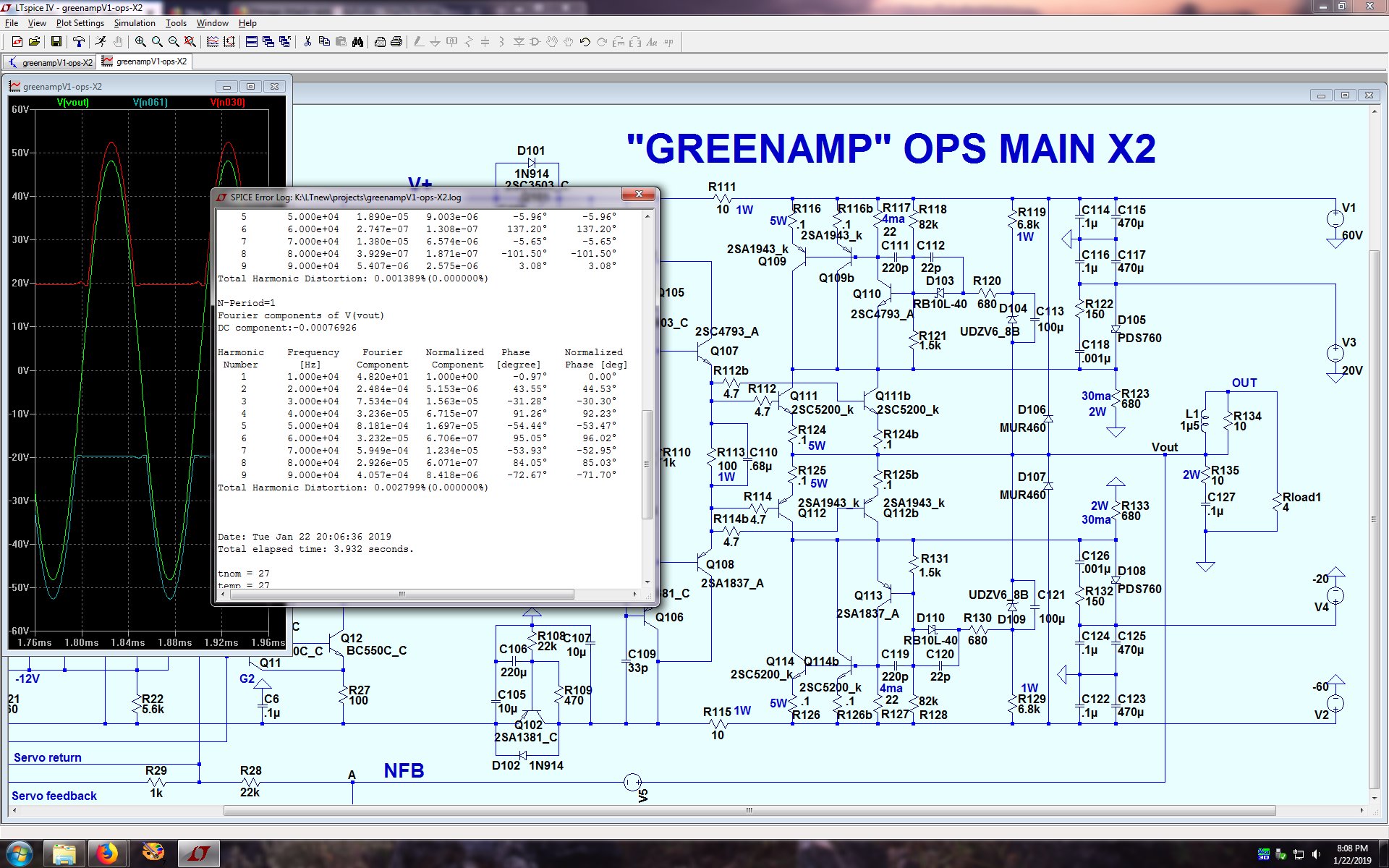

Attached is the final and .ASC + models.
I have soft switching , Ccb of Q110 and Ct of D103 can be "modeled"
with C111 and C112. This in turn allows you to "model" the tracking of
the step (attack and decay) , R118 bias and R123 to load the tracking rail
adds just a touch of forward bias without affecting the tracking voltage.
Many compromises to allow both smooth tracking and minimize class B
evil's ...
Run the sim , super !!! I like it better than the slewmaster OPS. 😱
Have the .txt in the same folder as the .asc .

I used the standard 0.22ohm resistors when simulating this, increasing them will make a difference. I'll try it out, thanks.
Yes, as Pavel just mentioned - high-value emitter resistors (1 ohm is good for the purpose) and low idle current for the helper transistors - 20mA per pair is more than enough. It runs very well (low distortion) even with the idle current close to zero (follower pair runs at 100+ mA anyway).
By the way, the bias spreader controls the helper transistors as well (as they are directly connected to the follower pair).

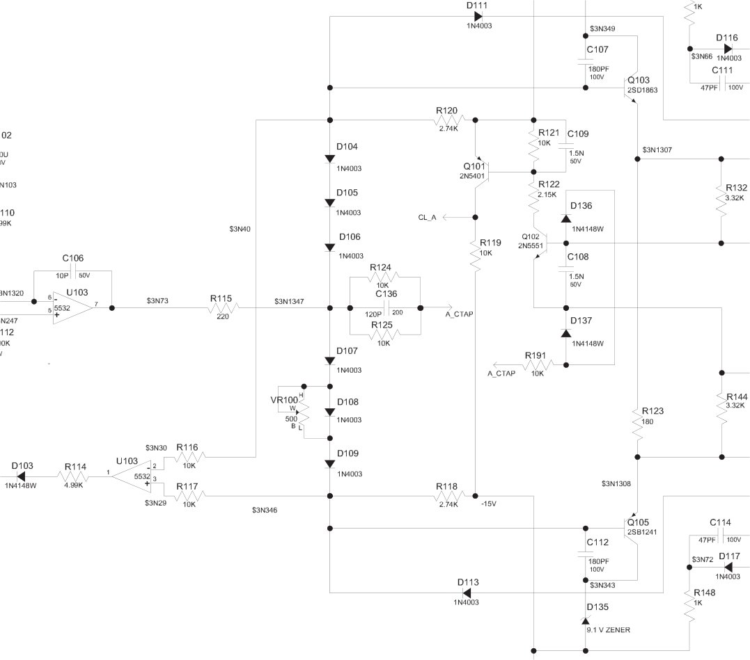

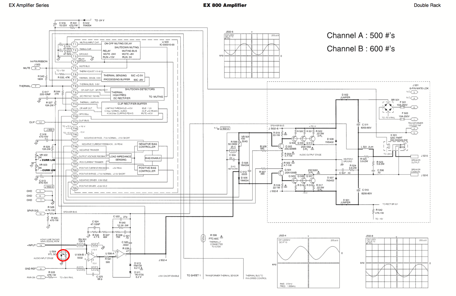

To address the " CAT of Sarcasm" , The CC1800 crest is 450/700W with
the same power supply as a typical 150W amp , and just 8 power devices. Definitely "greener". My little 4 device unit (200/400W) , should not need more than a 1U x 25cm heatsink. Crest's Vbe is now known to me (below 2). --4Vbe vs. 3 for my EF3. The step's CFP is the extra Vbe , as considered. My EF3 Vbe can be altered - it's a Vbe "multiplier" !!
Oh , the full power - crest/greenamp 400w (below 2). The 400/700W beast that will run mono on the typical DIYA 150w badger PS (and heatsink).
PS - the crest IPS is a old NE5532 op-amp . 🙄
