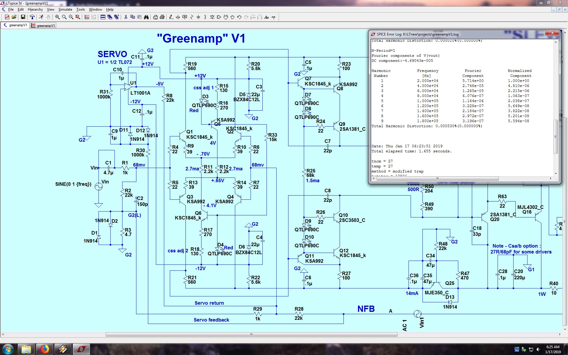

GreenAmp ++ modulated Class G output
Hmmm. 50A trenchfet - SOA (below)...
That is indeed Hmmm, the Vishay SOA doesn't look like the TrenchFET SOA from IXYS, for instance.
Nor is it consistent with articles like this Are Trench FETs Too Fragile for Linear Applications? | Power Electronics
or this [Resolved] Hotswap FET selection based on SOA with paralleled trench FETs - Power management forum - Power management - TI E2E Community
The first article is oldish so perhaps trenchFETs have improved their linear SOA, IXYS is behind the times and I am mistaken, in which case thanks for the update.
But the second article is reasonably current so perhaps the Vishay datasheet is a bit optimistic.
I still think your particular example is optimistic but won't quibble until I have better data.
Will reply to other stuff later.
Best wishes
David

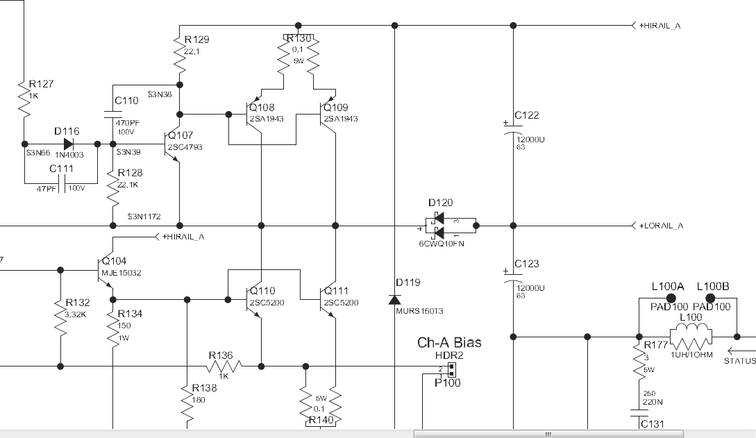

Cascoded VAS >2V + EF3 >2V + Rail tracker @ 2V + even the cap multiplier @ 1.5V = >7V loss. Yes , to reduce it - no cascode or class H + EF2 and no multiplier. "Burn it" ?? , we just don't use it...
Well, we do "Burn it" because every ampere that we pull from the outer rails produces 10 W of heat across that 10 V drop. For my 600 W into 4 ohm example there's about 18 amps peak = 180 W peak just from that. So, nice to reduce it. I have the cascode on the IPS, as in Damir's amp, that saves a few volts and the loop gain is practically identical above a few kHz. I have VFA sims of EF2 OPS with 20 kHz THD of a few PPM so that is an option I will try. Use both should cut the overhead by a third or so. "Better than a poke in the eye" is the Australian idiom.
Then we need to make sure the rail tracker isn't the choke point once we save a few volts in the earlier circuit. It was the rail tracker I had in mind when I wrote the earlier comment but your reply has made me realize we need to keep both sets of overheads in correct relation, very helpful.

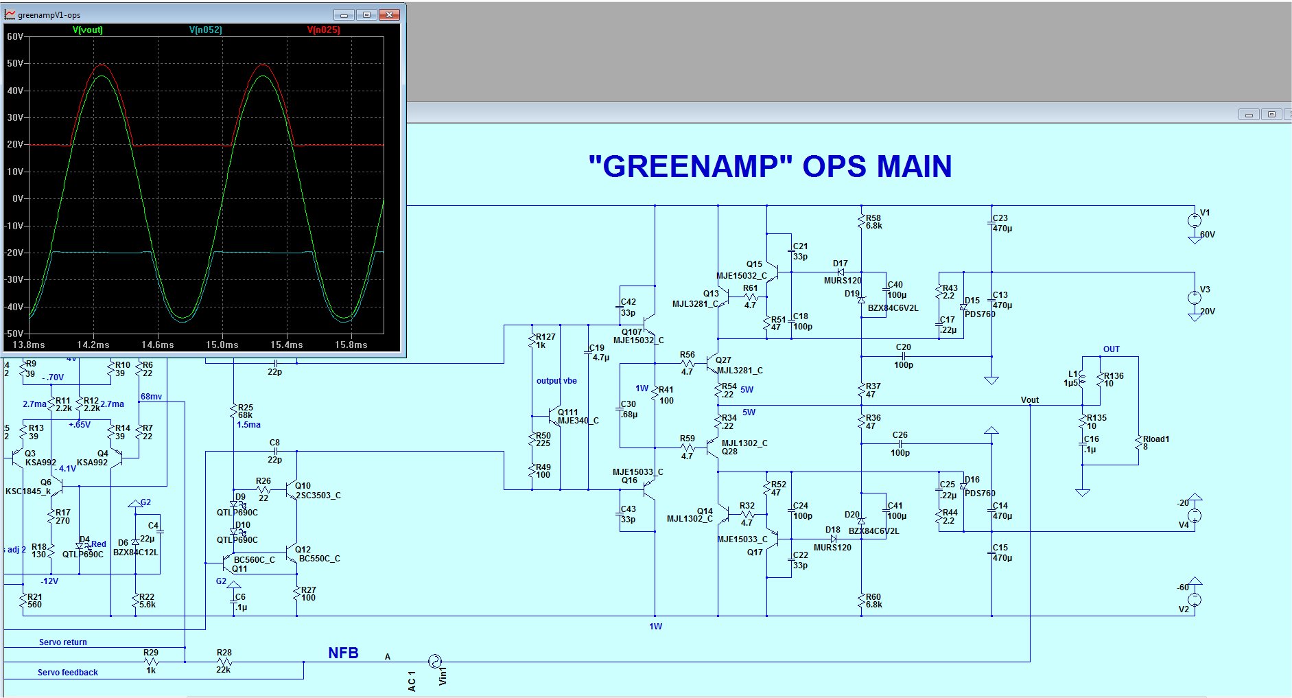

#1....Then we need to make sure the rail tracker isn't the choke point once we save a few volts in the earlier circuit. It was the rail tracker I had in mind when I wrote the earlier comment but your reply has made me realize we need to keep both sets of overheads in correct relation, very helpful.
#2 ... Yes, definite trade off between losses and "dirt". My speakers are efficient so I am prepared to accept the increased losses from linear power rail modulation in return for clean power. I wonder if I can use the outer VFET capacitance to actually smooth the process, haven't worked out if that even makes sense yet. Best wishes David

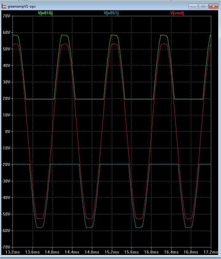

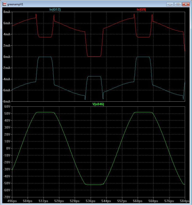

#1 - I just did the simulations on the MOSFET's. They work great for the typical "switched" modulated class G. Very hard to get them in a idle state(for H). I expected this , they do not work as well as a BJT in the linear region. The modeled gate capacitance does have a "lag" effect on the modulation vs. frequency.
With the BJT variant , easy idle ...and you can control the capacitive "lag" up over 10Khz.
#2. - How much power do you really need ? With that efficiency the 8 device (below) would blow you out the window. The X2 is the same as the Crest (cc1800) @ 400W/8R. But .. at 8ppm-10Khz , it scales nice. .ASC is set to idle the modulator devices at 15mA -run 150V p-p @ 10K.

When you just break the class G switching barrier , You have the full voltage of the upper rail switched on even as it is un-needed (by the inner pairs). Class H only applies an extra 4-6V over what the signal requires. Which scenario would be more efficient ? The upper device is always at some level of Vce instead of being fully "turned on". You would think these factors would negate each other. Actually , the reduced loss from the inner pairs more than negates the outer pair's increased losses.
Nope , from ADSL drivers to audio .... class H is 5-10% more efficient overall than the "dirty switcher" (class G). Most of this efficiency is shifted right to the transition between AB and H operation.(below 2). The dirty class G gets it's peak before transition. It also seems class H gets just a little more efficiency all the way to full power. This information seems to be consistent across the internet , once you go beyond the dummies that do not even know the difference between G/H.😀
Maybe not "need"😉 But my baseline is 600 W @ 4 ohms to drive JBL-pro 15" woofers (2226) to their nominal limit. That should also be suitable for the 18" subs (2245"). Also a 150 W @ 8 ohm mid amp. (My class B+ had an OPS where each increment was 100 W so I had planned 200 W for the nominally 150 W driver, realistically 100 W would be plenty.) Plus amps for the tweeters, hardly need class H for that.

Then we need to make sure the rail tracker isn't the choke point once we save a few volts in the earlier circuit..we need to keep both sets of overheads in correct relation...
Now I think some more and see the rail tracker should waste minimum volts because this means we can keep more Vce across the inner transistors near the peaks. That helps keep their Ft up and improves stability. That makes the common source (or BJT CE) rail tracker still look like the choice.
David

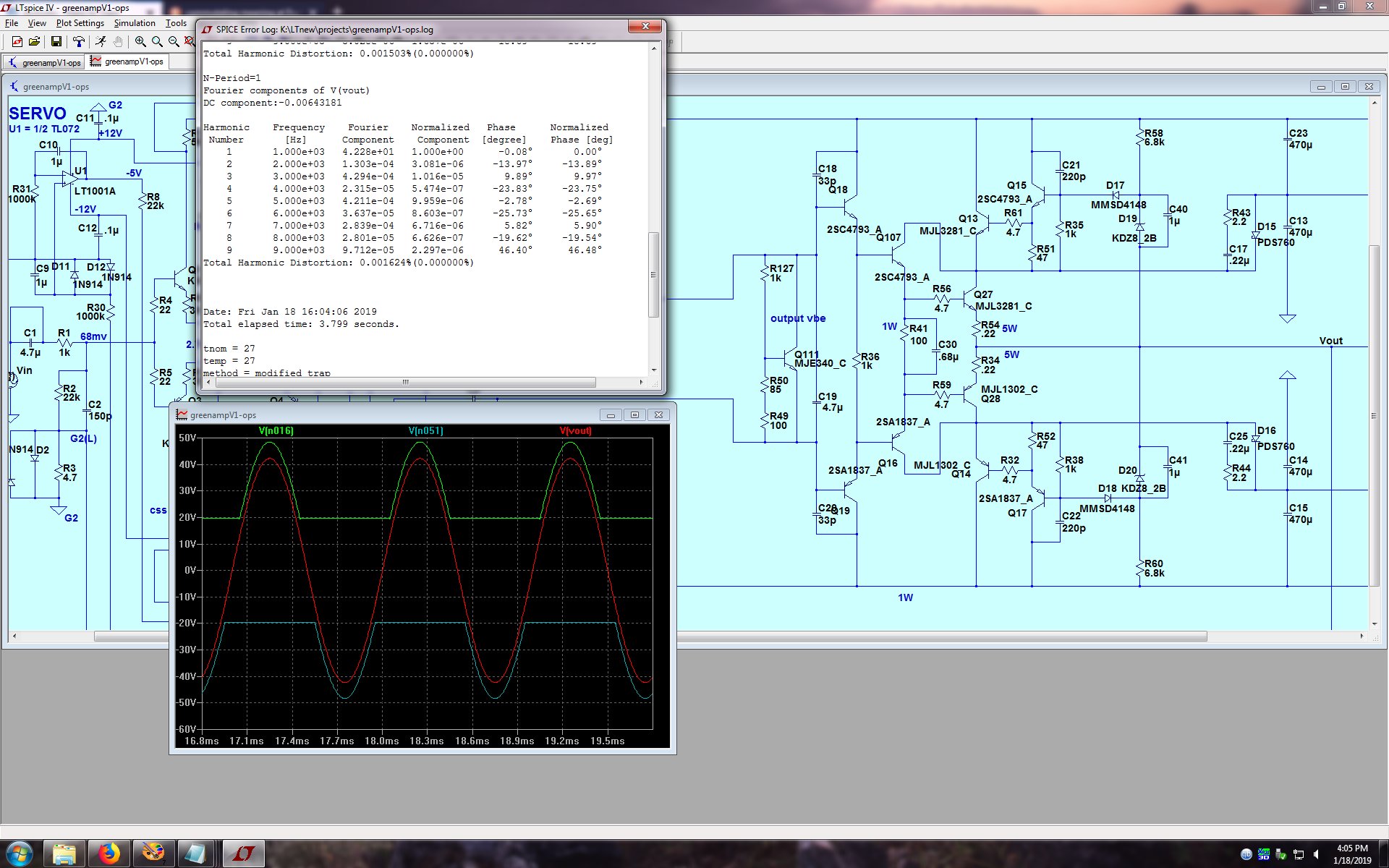

Sims with the IXYS VFETs as the outer transistor are beautifully clean, no transition spikes or twitches at all. Unfortunately the VTO is 4 volts so we lose a bit more overhead than a BJT. It's not easy to use Common Source and pull the FET "down", as I learned when I tried. I want the VFET benefits but want to avoid excessive losses. Winfield Hill had the clever idea to create boosted rails with a tiny, isolated DC-DC power supply. Seems to me it would be possible to do a similar trick here, rather than boost the rails just boost the Gate of the FET. Kind of a linear hi-side driver. The power is tiny so even the smallest part should work, there are some on D.key for less than $2. Any noise should be outside the audio band and can be well filtered, plus it's in the OPS, not the sensitive input. Has anyone seen this done or have ideas?
Missed the edit window. It now occurs to me that photovoltaic couplers would work well for this. Quieter, smaller, even less expensive, nicer somehow. Can perhaps power them off bias current we need anyway, so they use effectively zero power.
