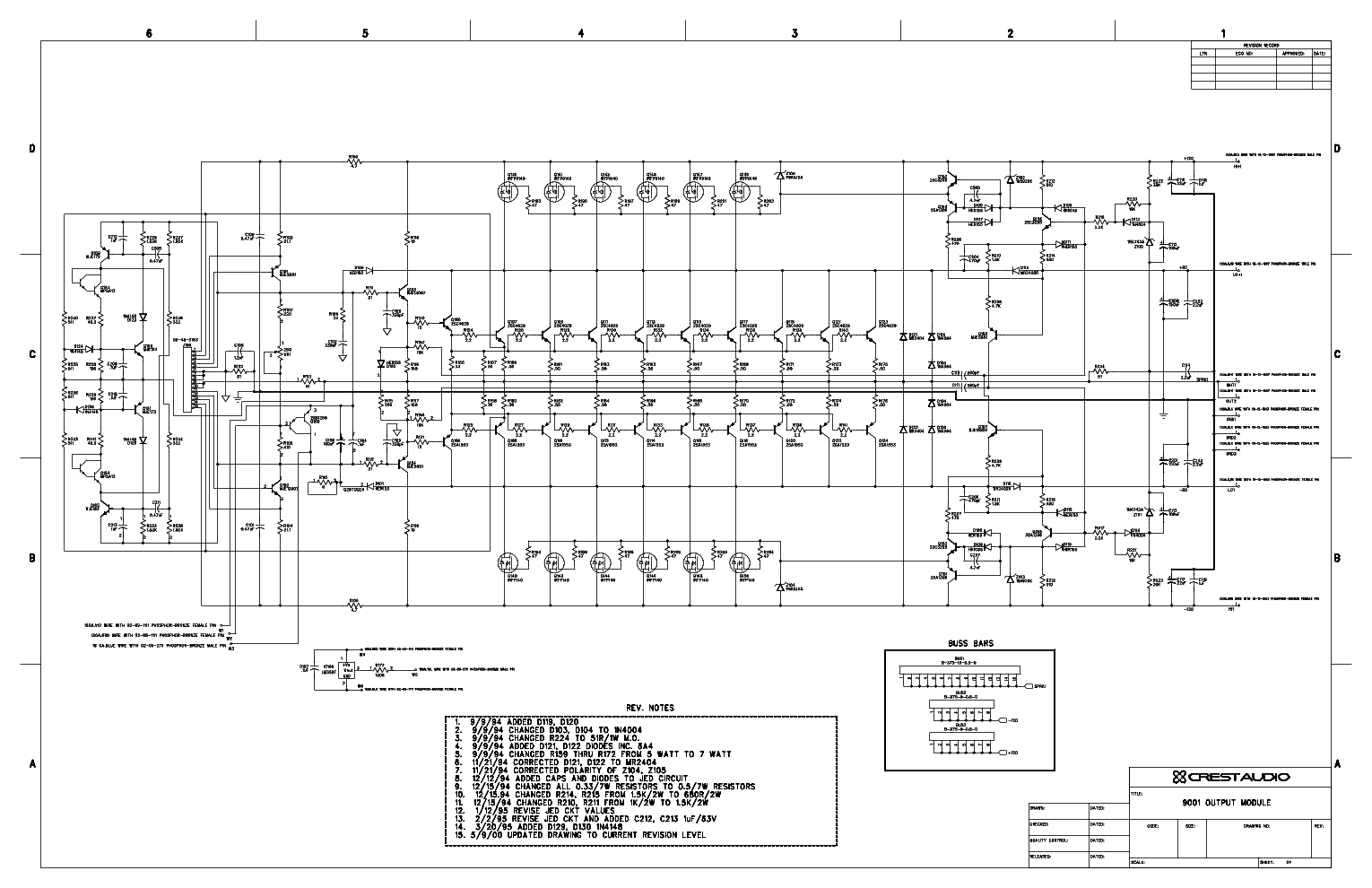

I think VFET outer transistors could be connected as common source to reduce the losses without the need for even more rails for a boosted VAS.
Have you considered this?

That is a little hard to read but it looks very similar to what I had in mind, thanks!
Is there a better copy or a circuit explanation, service manual maybe?

I found some information.
It is a bit overkill for home....
Service manual:CRESTAUDIO PRO 10001 Service Manual download, schematics, eeprom, repair info for electronics experts
Of course, I don't plan to build one!
But it is nice to see they have worked out a similar circuit when faced with professional equipment requirements for efficiency and reliability.
Also makes my estimate of one outer VFET for each rail look plausible for my 600 W woofer amp.
They use one per ~400 W but the amp is 20 years old and VFETs have improved.

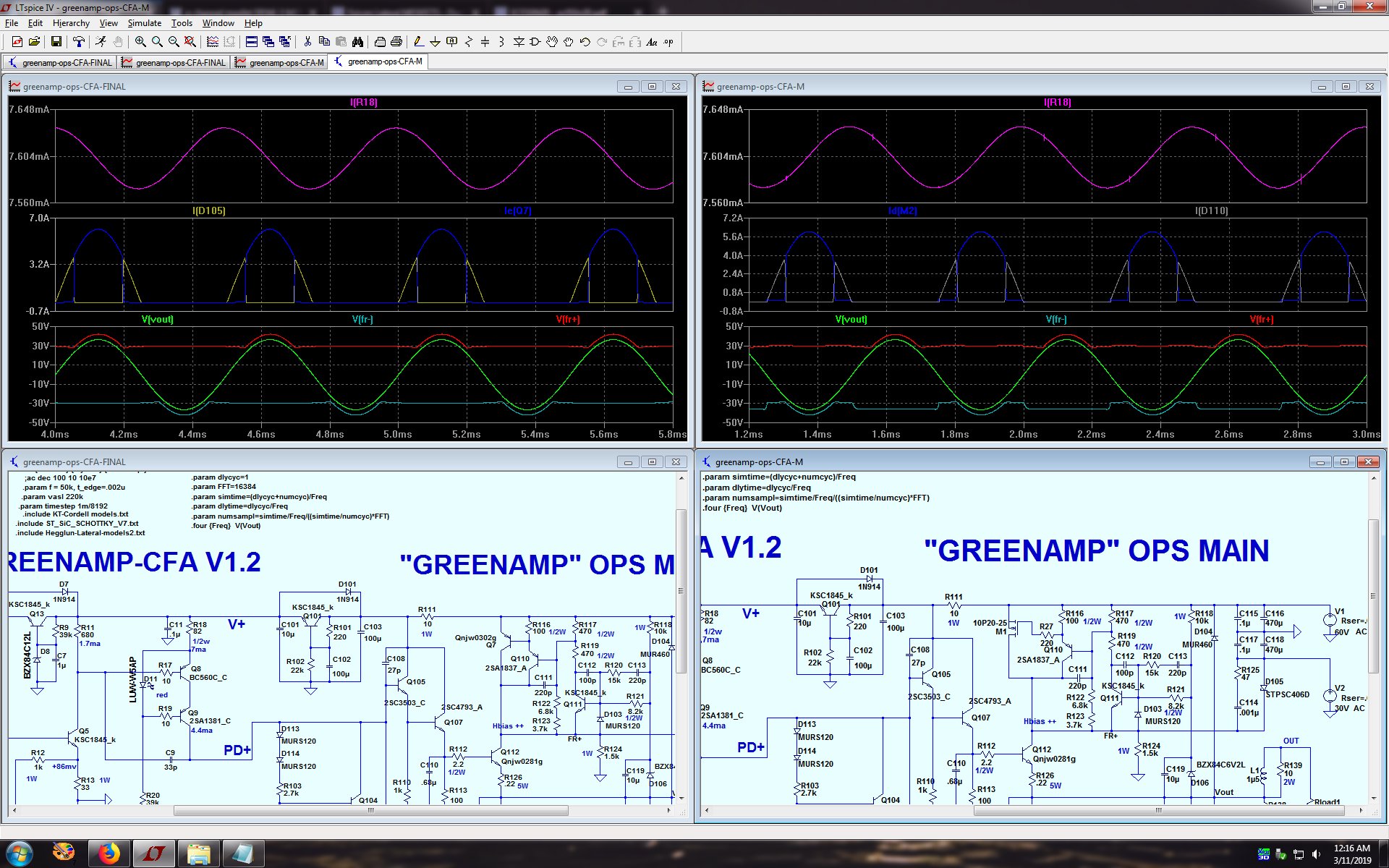

With VFETs as the outer transistors there are no minority carriers to soak up - so I don't see a need to keep them on, should be more efficient and still clean.If you ask , my outer pairs do not turn off...
Best wishes
David
Unless the Exicon models are wrong , I get similar results. The outer pair pre-driver sees the same 500-700pF capacitance with either BJT/mosfet. Are the Exicons Vfets ? What also works well are the cheap "trenchfets" (D-pac/to-220). You only need about a 50W device , the class H outer pair devices will just have 10-30V to deal with. Again , the Emotiva uses just 3 TO-220 high current low Rdson MOSFET's as the outer pair (in parallel). (below) are the FET/BJT simulations.

Are the Exicons Vfets ?'''
No.

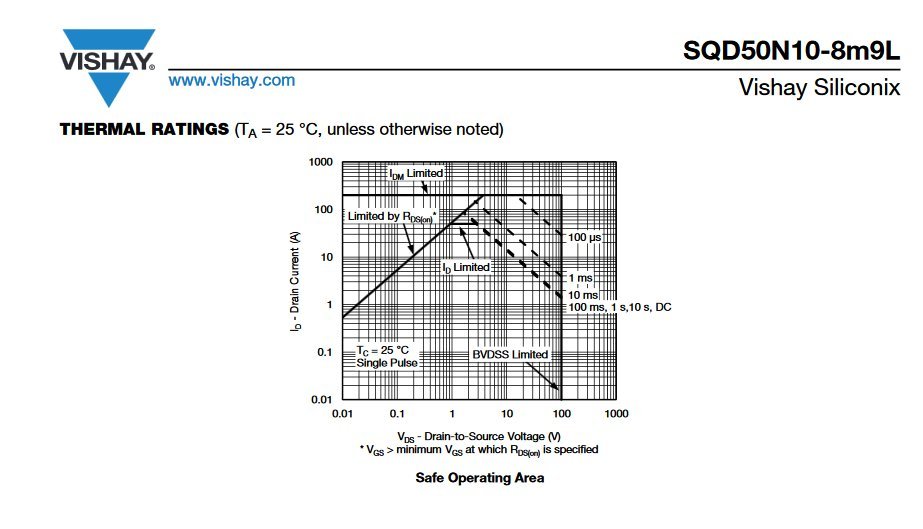

Trench FETs are excellent for a switched rail scheme, I very much doubt they are suited to a Class H amp where the rails track linearly, the SOA is poor. I don't see how a 50 W device will survive at elevated power levels, my baseline is that the outer devices have 55 V = 20 V inner and 75 V outer.

I am unfamiliar with the circuit of the Emotiva, it sounds more complex than I want so I haven't spent the time to look at it - do you have a quick link so I can see how relevant?
Thanks for that but I can't run the FET sim because you didn't attach the FET models. And of course I can't see if those models are OK. From your picture it looks like the FET simply replaced the BJT, not adjust for different bias and turn on, maybe not optimal? When I did a BJT sim (on an old version) I notice the amp clipped at about 50 V peak output with 60 V rails 10 V seems a lot to burn, I think it can be reduced, have you looked at this?

Hmmm. 50A trenchfet - SOA (below).
Between the 30V and 60-70V rails is 30-40V. As you transition into H , you start at 30V (Vds) , quickly race towards the high rail. Vds is < 20V for most of the 15mS on a 20Hz waveform. Plenty of SOA @ <20V + <10mS. We are only dealing with 1/4 of the rail to rail potential on each partial cycle of even the slowest waveform.
