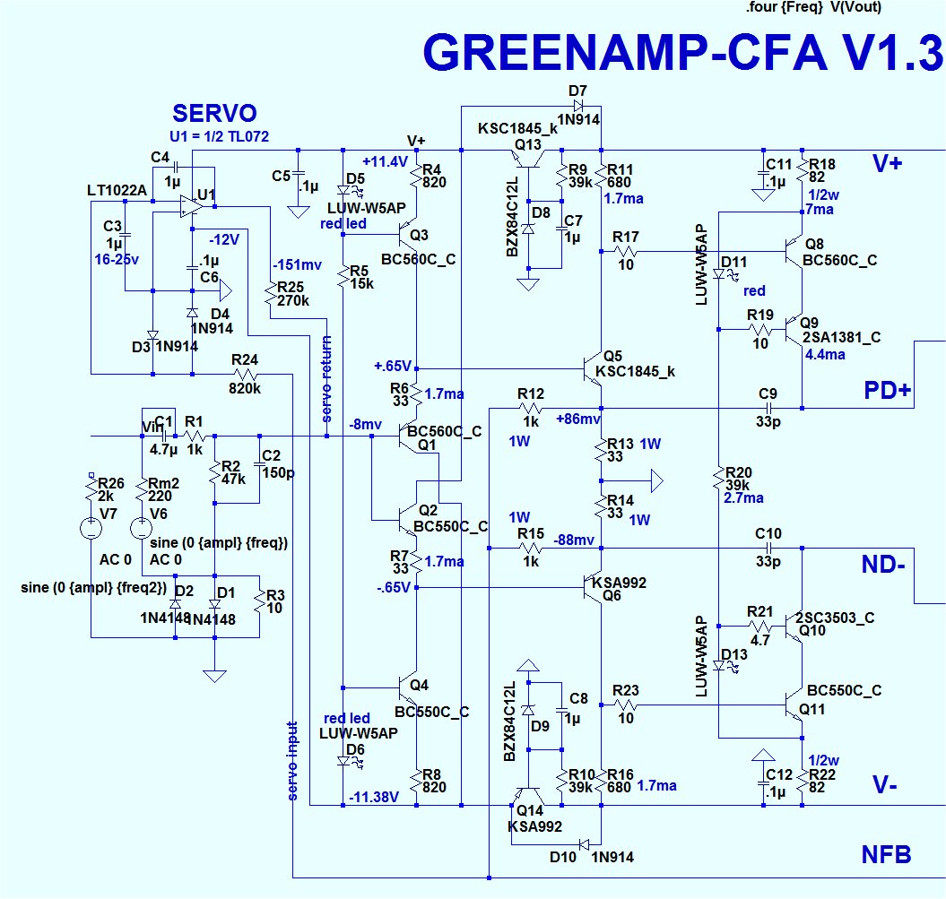

My amp has a noise 52.2nV/Hz1/2-.
Hi Sajti
I was interrupted yesterday so I didn't finish my reply.
That is an excellent number, my compliments, your transistors are a little quieter than the BC550/560 and the circuit looks nice, low impedance* and fairly low gain.
Best wishes
David
*Except in the current mirror, where it is correctly implemented NOT low!

I tend to design a ltp using parallel transistors as D. Self showed in his APAD 6 book to further reduce the noise.
BTW: the latest design of single mosfet IXYS powered SA2017 amplifier has a real life (!) measured 99db SNR at 2.83V rms output 20k bw or > 101db A-w so your extremely sensitive horn speakers should be dead silent...

...mosfet IXYS powered SA2017 amplifier has a real life (!) measured 99db SNR at 2.83V rms output 20k bw or > 101db A-w so your extremely sensitive horn speakers should be dead silent...
Nice!
I haven't used those IXYS Mosfets yet but I think this could be the project for them😉
One chunky IXYS Mosfet can replace several "ordinary" Fets so at least the circuit will look simpler, as well as simpler to build.
A class H with outer and inner IXYS in the OPS should be OK for maybe ...>400W?
Have not reached the point to sim that yet but this could be one of the simplest hi powered efficient amps that is doable.
Or maybe an IXYS fet for the outer transistor but a smaller BJT for the inner?
Probably depends on the relative potential of the inner and outer rails, more to sim.
You have any opinion?

- the Zetex ZTX851 and ZTX951 complement, and even thru hole!

Those are with quite high Cob, maybe better complement could be ZTX857/957?
...maybe better complement could be ZTX857/957?
It's a trade-off of course, the smaller dies have lower Cob but more Rbb.
I don't have measured data for the parts you mention but the ZTX618/718 are ~20 pF and <10 ohm Rb.
The ZTX450/550 are <15 pF and still <10 Rb.
The point is that there are plenty of parts that are available and have much lower Rb than the BC550/560.

Ultra low noise amplifiers
Is it really such important, for a power amplifier? With input sensitivity 1-2Vrms?
My line preamplifier use same input topology, without feedback, and no noise with any power amplifier, I used.
Sajti
Sajti
I didn't know that website, it looks like excellent work, thanks.
The data looks very consistent with Art of Electronics but has several transistors I didn't know about.
The ZTX857 looks excellent, also we can build low noise preamplifiers for 300 V !! 😉
The BC550 is not even mediocre, it's bad, even worse than the model.
For most people - no.
But why not have truly exceptional performance when it can be done with no cost - except attention to detail?
It is not a commercial product where my time is costed, and I enjoy to make these details the best possible.

Pay attention that BC550 is from Philips in this measurements, I use Onsemi and don't have bad experience with it.

Yes, but even if it's 4 times better than the Philips (to match the model's ~170 RB) it is still 100 times worse than the Zetex.
(OK the noise is only 10 times worse!)
No plausible manufacturers variation will fix that.

The simulation has a 1k and 220R resistor in series with the input. Low noise input transistors won't fix their noise contribution. Even if you remove those resistors, realistically the only way you will get those noise figures is if you use a low noise active preamp/attenuator.

The simulation has a 1k and 220R resistor in series with the input. Low noise input transistors won't fix their noise contribution...
Yes, of course. My own circuits and simulations do not have such series resistors to contribute noise.
As you say - not fixable otherwise.
realistically the only way..is if you use a low noise active preamp/attenuator.
Also yes.
Best wishes
David
I don't see those resistors, what schematic you a looking at?
I don't see those resistors, what schematic...?
There was a 1k series input resistor in the schematic from post #1 and onward - R1.
At least one of the schematics I downloaded had an additional 220 in the input, probably left over from a test.
Post #81 for instance.
Best wishes
